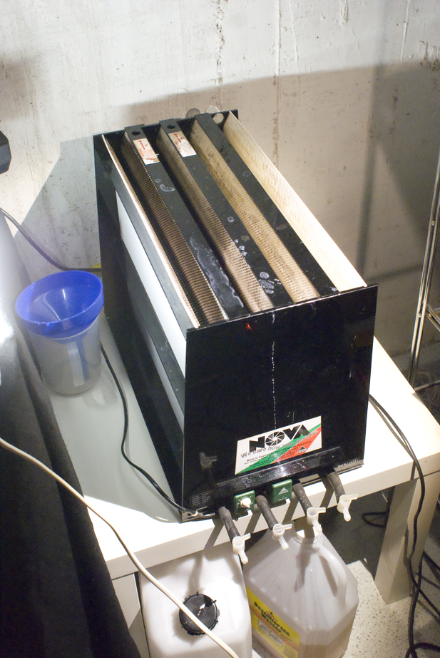

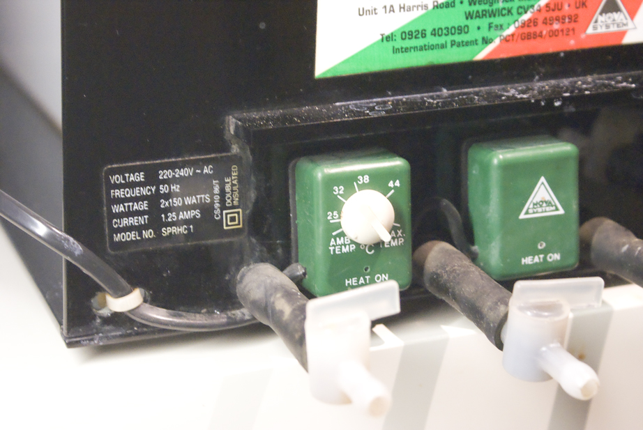

On Friday I bought a "NOVA Deleloping machine" on a local marketplace in the internet. I was pretty cheap (100€ incl. shipping) and darkroom lamp and a thermometer was also included. Now, this huge machine is standing in my darkroom, but ONLY the machine, so with no floating lids etc. When I search for the model no. (SPRHC 1) I just find some old ebay entries where someone sells a "washing tank". Did I buy a WASHING MACHINE?! It has a four slots and a temperature control from 20-45 C (too accurate for a print washer, isn't it?)
So, what is this machine?

No, on the NOVA website I don't find anything... It's probably an old model. Here are some pictures...

Dear youngfilm,
Your processor is very much like the current Trimate, but it was designed for printing color as well. The heaters are to bring the chemicals up to the level specified by the process. Essentially, you have purchased heated vertical developing trays. It can certainly be used to process b&w RC paper with or without temperature control. The heater might be handy in a cold darkroom.
Neal Wydra
bdial
Jan 2, 2005
7,515
North East U.S.
It's a Nova quad processor, the last slot can be set up as a washing slot, using the small spigot for incoming water, and the larger one at the back for the outflow. I have mine set up for two-bath fixing, that is, I have fixer in the last two slots, then pull the fixed print out and into a separate holding tray.
As I recall, these were originally sold for color work, so the final wash would be short. For B&W, and especially fiber papers, using the last slot for washing isn't very practical, so I use it for the second fix bath. If you don't use 2 bath fix, just put water there, but you'd probably want to wash prints in a separate washer or tray.
The two holes on top are for filling the water bath, on the side under them should be two rubber plugs, you fill the water bath until the water gets to the level of those holes then insert the plugs. Do not operate the heater without water in the bath.
Your unit (like mine) has Nova's older style heater. They have an upgrade kit with a different style heater that has just one green block, as I recall. I leave mine near the minimum heat setting to maintain 68F/20C which is nice in the winter when the room temperatures are a bit lower than that.
Nova's web site has replacements for the spigot tubes, valves and the short rubber hoses. The glued-in tubes that are under the rubber become brittle after a while from the chemistry and need to be drilled out and replaced. I've had to do do this with two of mine so far. Just be careful to not stress the tubes if you move the unit around.
The also have an outlet kit for the large outlet in the last slot if you want to use it for a wash.
Your pictures don't show them, but it should have come with clips that hold the paper in the slots. If it didn't you'll need to buy some from Nova, or else cobble up substitutes. It would be difficult to work with without them. The clips are available on Nova's website.
I really like mine, and it saves a ton of room over 4 equivalently sized trays. I keep mine plugged in an on all the time, so to start a printing session I just remove the floating lids and turn off the lights. Most developers will last a good while in in the slots. Depending on how much printing I do, I've gone as much as three weeks between developer change-outs.

There really isn't much to know about it. It is simply 4 trays on their sides. Just make sure that the water jackets are kept full, the tubes are kept on the slots when not in use( get some tubes if none came with the processor, set the temp for B&W or RA4, fill the slots with chemicals and GO!

Assuming the heaters are in working order I think you got yourself a bargain :smile:. Bdial has covered pretty much all you need to know, but it's not a Quad - those have four heated slots. I think this type, which is three heated slots plus a wash, was called an RA4 and as the name implies they were designed for RA4 colour printing. I have a Quad which I've used for RA4 and Ilfochrome in the past, but I use it just for monochrome these days. There's no need to upgrade the heaters, the old design works perfectly well. If you don't have the "floating lids" a trip to a plumbers' merchant to pick up some plastic water pipe will sort that out. That's what Nova uses. If you email Nova you'll find them very helpful and able to advise what else you might need to get the most from the unit. It'll work fine for b+w, the built-in wash slot is ideal for RC papers.
