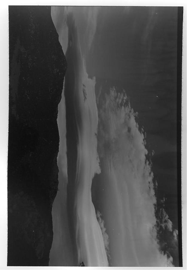

Here's a scan, please excuse the quality, this was the bottom of the print and you can see the problem in the sky. This one resulted from agitation by running the clip along the top and occasionally lifting so it's one of the worst examples and one of the first where I can see the problem. This is MGWTFB in Cooltone for 3 minutes at 23-24c. The lines at least have the same spacing as the waffle pattern.

Matt, the line in the picture is very similar to and it does resemble some of my samples. I think it is caused by the same problem and I expect the problem to go away after cleaning of the developer slot.
Dave, I know their instruction since I read it many times before I wrote my article about Nova Monochrome. I've also made an experimental developer that's very easy to exhaust to see if the pattern is due to developer exhaustion, but the answer is negative for a number of reasons. First of all, the pattern does not appear even with such a exhaustion-prone developer, as long as the slot is cleaned before testing. Also, the pattern does not disappear when prints developed in dirty Monochrome is transferred to a tray filled with a fresh standard print developer and manually agitate vigorously. (Very often, uneven development in tray development goes away if you give good agitation and give extra development time, but this is not the case with the uneven development appearing as pattern discussed here.) Also, once the slot is dirty enough to cause visible pattern, circular agitation does not completely eliminate the problem. It only makes the pattern less noticeable, but if the print is toned, you still see some sort of defects anyway. After all, if the slot is clean and the developer is good, perfect defect-free print can be made with very little agitation, far less than required by the Nova instruction, although I still recommend adequate intermittent agitation for processing of actual work. For all these reasons, I am convinced that the real reason is due to deposition of developer reaction products on the inner wall of the developer slot.
The most effective way to solve the problem is to clean the inner surface with a thin bottle or burette washing brush. I suspect that if you take the developer out of Monochrome and the surface is cleaned with a cloth and a stick or spatula or something of that kind, and then rinsed with tap water from a hose, much, if not all, of the pattern should be gone. I use thin brush because it can be used without transferring the developer to another vessel while scrubbing the surface.
