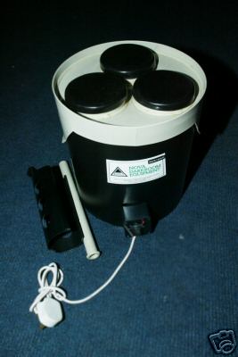

Anyone use one of these for film and/or prints. I can get one for about £40 which seems a reasonable price given the limited colour work I do.
I know it's a daylight tank and I can work out how to use it with film but I assume prints are just immersed with no agitation, anyone got experience of this ?
Any guide on weight and dimensions (it looks big )

They are designed to be used with Stainless Steel or plastic cradles (Mr CAD sells them S/H). You roll the print up and turn it into the cage spiral. They work very well, but use a lot of chemicals. Agitation is done by moving/lifting the cradle. All done in the dark though.
My comments are for prints of course, film can be processed on standard spirals on a S/S 'T' rod.

Digiconvert. Sorry can't comment on this deep tank but can say that Nova darkroom is having a sale on 22/23 April. If this kind of tank doesn't do the full job then maybe Nova will have a bargain Jobo CPE2 or Paterson Orbital. OK I wouldn't expect to get a Jobo for £40 but it will have been checked and serviced and there will be a short term guarantee. Given how long a CPE2 can be expected to last then even if your colour output is small, it could work out quite cost effective over a matter of years.
You can ring them about the sale and get an idea of prices and items
