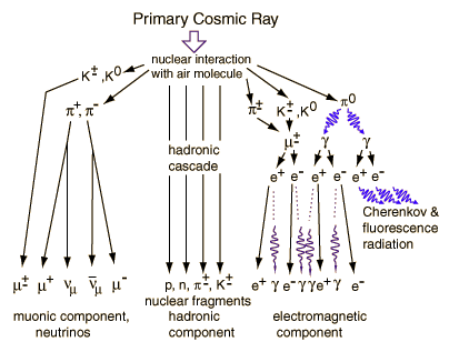

John, the muons are part of the cosmic radiation.
The Technical Committee ISO/TC 42, responsible for the International Standard ISO 18928 don't differentiate muons from the cosmic radiation.
This graphic might help you out.
attachment.php
