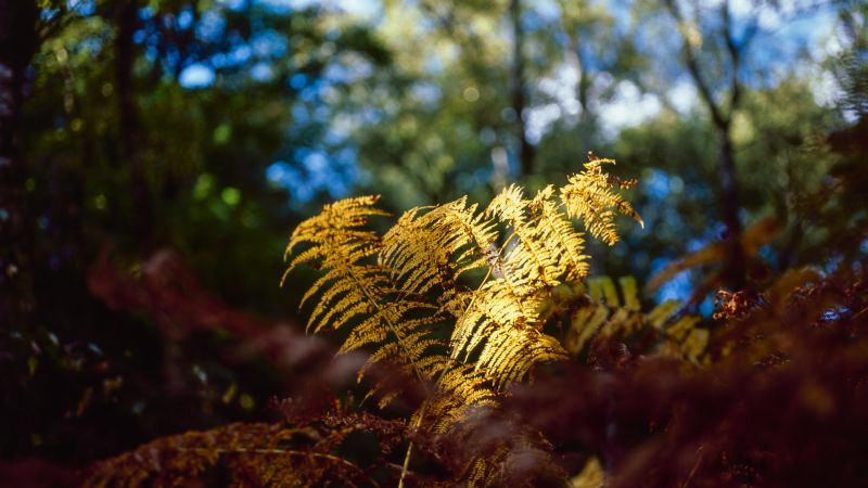

Since I bought my Pentax 645N during spring this year, I have been using my F100 less and less as the Pentax took over my hole field of nature photography, leaving the F100 for light travel and carry around.
One thing I am missing tough is pretty bokeh. For most of my shots I use the Pentax FA 75mm f/2.8 as I am a big admirer of the normal perspective. While my Nikon AF-S 50mm f/1.4 is not a perfect lens in terms of bokeh, the Pentax leaves a lot to be desired in comparison. For instance, take the image in the attachment. Shot two weeks ago, using the Pentax 75mm set to f/2.8, wide open. I wouldn't call this smooth and I really wish it could be improved.
Is their a prime lens in the range of 70-90mm that offers a significant improvement in bokeh and can be adapted to the Pentax 645N?

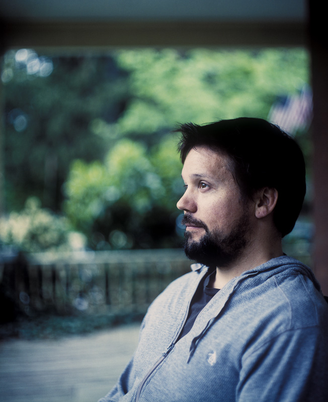

Below is a photo with the Pentax 67 90mm f/2.8 LS lens (on a P67ii camera) which I doubt would be starkly different than the 75/2.8 but you can decide for yourself.
I have other 645N samples which you can browse if you want to: http://blog.seancarpenter.us/tag/pentax-645n/ I have the 45/2.8, 75/2.8, and 120/4 macro lenses for the 645; and the 55/4, 90/2.8 LS, and 135/4 macro in 6x7 format.

A shot with the P67 105/2.4 that is pretty close to the one you posted (not my shot):
http://www.flickr.com/photos/sashakrasnov/5064744929/
One more note, my opinion of 'good' bokeh has changed over time, and I am finding lenses like the 105/2.4 which aren't "perfect" render more attractively than smoother lenses. The Sigmas I mentioned earlier, for example, I think are boring.
