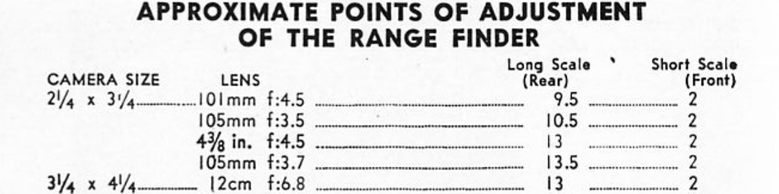

Any reason you could think of as to why a 105/5.6 of either type wouldn't cooperate with the Crown's RF and focusing scale, with calibration?
From the Kalart manual: Kalart RF adjustment.png
