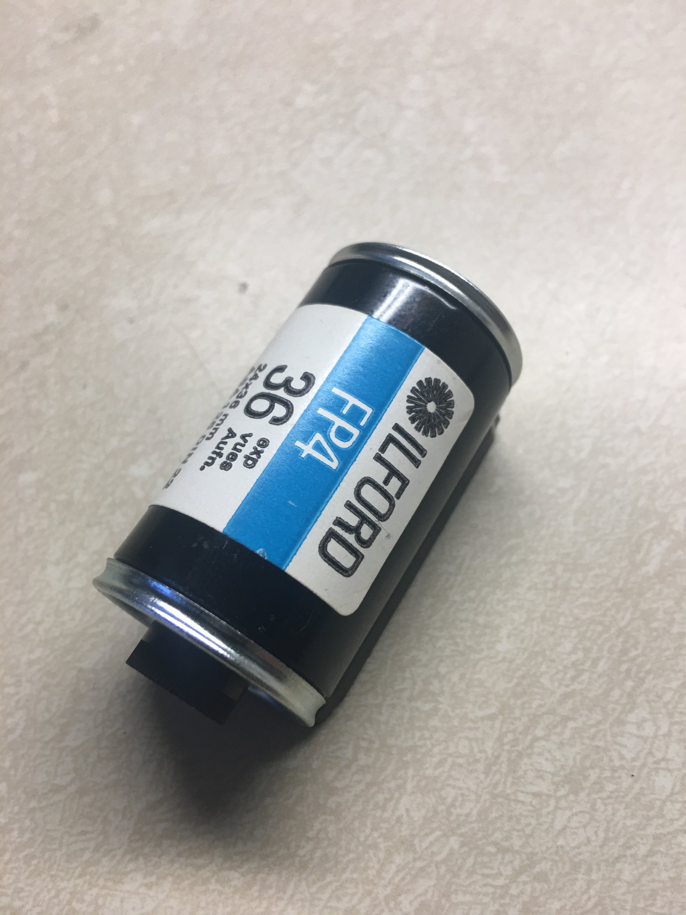

Hello,
I just got some vintage Ilford film Cassettes because I have read that they are great for respooling film. How do I open these up? Having a hard time finding a description after a bit of googling...and don't want to mess them up.
Thanks!

Press with two fingers at one end the drum firmly together at the slit and with the other hand pull off the cap at the slit. It takes some force at pressing. I rather sit down and put the hand with the cassette on my leg.
Best open the cassete at the end with the protruding stud.
Concerning opening and closing I prefer the plastic cassette with the tightening bayonet (breech lock) cap.

Success! Thanks for the advice and happy I didn't damage it trying to force it. Squeezing the lips directly seems to not take much force on my particular cassettes.

Position the cassette with the protruding end of the spool pointing down toward a hard surface.
Squeeze the cassette between your thumb and fingers - firmly, but without distorting the sides very much.
Push the protruding end of the spool hard down against the hard surface, until the cap pops off from the end at the top.
Eye protection is recommended.

Back in the day we simply held the cassette with the projection facing down and banged it down hard on the darkroom countertop.
The method I described a couple of posts earlier is the kinder, gentler and quieter version of this.

I just gently squeeze the cassette at the end where the spool protrudes and flick off the end cap with my thumbnail. Dead simple.

That can distort the cap enough to make the cassette useless for reloading. Back in the day we simply held the cassette with the projection facing down and banged it down hard on the darkroom countertop.
That's what I always did.

I often just push off the cap on those with the end of a fingernail. At the time those were made, Agfa used an almost identical cassette. (spool was sometimes a bit different)
