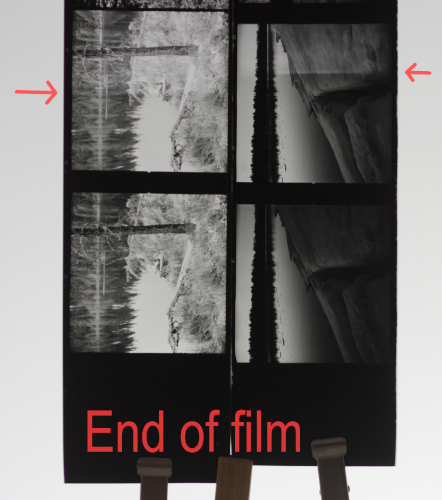

I load two rolls of 120 film on one reel, using the red tab film separator to prevent overlap. As I write this post, I notice that the problem occurs on the penultimate frame (frame 11 of 12, since I’m shooting 6x6) of the innermost roll of 120. Any ideas on how to solve this? I guess the obvious answer is to just load one roll, but that means developing takes twice as long and uses twice the volume of chemicals.
Here is a photo of the innermost ends of the film when loaded on the reel. Note that these are stereo images, which is why there are two “duplicate” frames. Note the line of non-uniformity marked by the red arrows, which appears as an area of lower density (i.e. more first development).

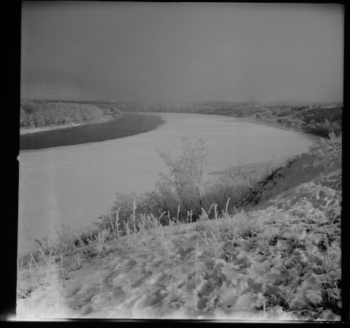

I first tried mixing up some permanganate bleach and otherwise running the same process as yesterday. The results were about the same. Here's the same problem I described in the OP, this time bleached with permanganate:

For me, it looks like the end of the film in the reel is in contact with the surface of the underlying winding. The development could therefore be uneven at this point. A film is most curly at the center of the film spool. I suspect you are winding the film with the end (frame 12) first into the reel. Try to thread the film into the reel in reverse (frame 1 to the center of the reel ). Or simply thread the film with the emulsion outside into the reel.

This is the inner film of two stacked on a reel only? My guess (and it is only a guess, as I have not seen this when I do 120 stacked), is that the end of the film is not fully past the red separator when it is pushed in. That distorts the film a bit, and probably affects the agitation effect.
This sounds reasonable. I use IR night vision goggles. I've had to visually inspect to make sure the first roll,of 120 was on far enough to be able to see the red tab between the two films. I found that it's not always fully wound and the red tab pinches the film.

Very good suggestion, and I have made this mistake in the past, but I'm reasonably confident that's not the problem this time. It's pretty clear that you've done something wrong if you try to push the red tab in without fully loading the reel on. The tab will not go in easily, and you will crease the film base if you force it.
Unfortunately I ran out of film and time to try this, but this is a great suggestion. I suspect if I were to load the reel in reverse with frame 1 to the centre, that the defect would appear on frame 2, but I can't say for sure not having run the test. As for loading the film emulsion side out, I intend to try next time I develop.
