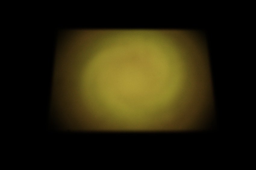

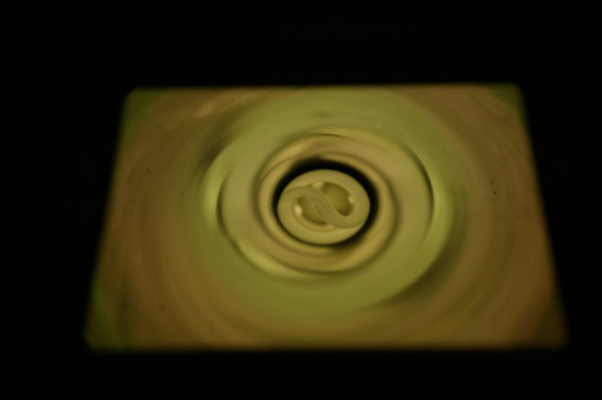

The first image shows the projection with out the diffuser, focus set to the lamp. Now, nobody would expect this to be pretty, but it reveals an unexpected problem, at least with this particular lamp housing. You can see the lamp and housing, as expected, but the interesting part is that the spirals of the bulb, probably because of self masking in the spiral, and reflection/refraction angle, separate the green spike of the discontinuous spectral output, creating a neato (unless your trying to print with it) green hurricane looking thing. This is what the diffuser "sees" before it goes to work.
The second image is with the diffuser in place, but still focused on the lamp house, the green hurricane is diffused, but still readily visible. The fall off is a result of having the focus up in the lamp house.
With the focus set for projecting a negative to about 8x10, the light evens out (of course), and the camera couldn't pick it up, but I can still see green mottling with my eyes. With an incandesant, the smooth surface of the bulb is of course going to be more even, but with the spiral CFL, differing amounts of green here and there on the diffuser is death to contrast control on VC.
Conclusion- as of now, no go diggy di. I'll try some mods, if I think of any. My first idea would be to go get one with the plasic bulb looking envelope around it, but they are of much lower output. It is possible that the output spectrum will make up for that, except I'll go blind trying to grain focus.... More to follow.
