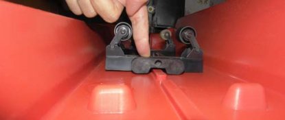

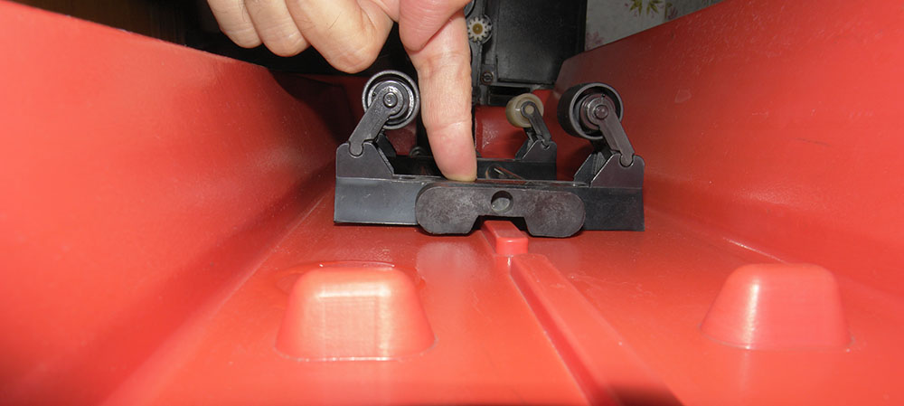

OK here are two pictures, taken with the camera near the water sink of the red basin.
In the first, No_finger_lift_up.jpg, I hope it can be seen that the extremity of the lift which is further away from the motor does not lie on the red plastic, it remains around 5 mm detached.
The second picture, With_finger_lift_down.jpg, I hope shows that if I press a finger on the extremity of the lift, it will go down until it lies flat on the red plastic.
As soon as I remove the finger, the lift goes anew in the first position, slightly detached from the plastic.
This small lack of level might not have an effect on a drum for 1 35 film or on a drum for 2 35mm films, but I do suspect it would keep a bigger drum quite out of level at its foot.
Is this normal?
Thanks for any help
Fabrizio

I see exactly the same thing with my Jobo. However, when I put in the drum, the weight of the drum acts like the push of a finger and it levels out.
PE
I've got perhaps 2-3 mm gap but as PE said, it's moot once the drums go on. I wonder if the rods are bent or possibly the trough. At the risk of being annoying <bg>, would it be possible to see photos of the rails as seen from the front (end of rails would be on the right) ? Also, if they were uploaded a bit larger that would he helpful as well. From the photos above, things look pretty well like normal so it shouldn't present any processing issues that I can foresee.

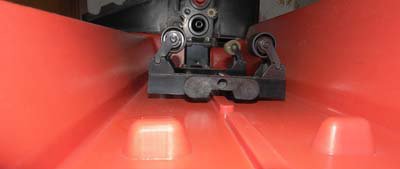

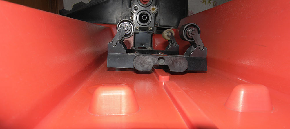

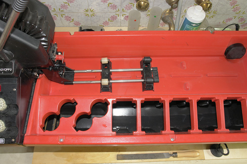

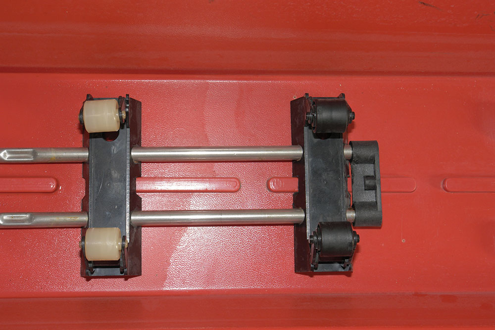

Here are the pictures of the rods (they look straight in this part of the lift, I have some doubts about the part where they "disappear" in the black box). I also reposted the previous pictures in a bigger size.
With the biggest drum I have (Jobo 1520, two 35mm rolls) the lift remains up.
As you can see from the picture from above, the rods are not really parallel to the raised ridge of the through. I dismounted and remounted the lift but it seems to fit just in one position. All the "couplings" of this machine seem to be quite approximative. I had to scrap the plastic parts that connects the rods so that the raised ridge "enters" inside the gap in the plastic parts.
As somebody says, it is all quite "unGerman". The level of water should be 3 to 6 mm inside the drum but at the minimum water level the water rinsing in the drum is way more than 6 mm. I level the machine putting the level in the spine halfway the red through (between the flasks and the lift). I obtain a different measure of levelling if I put the level on the back ridge.
Thanks for your support
Fabrizio

Thanks Fabrizio.
Things look normal to me although, and it can be the angle of the photo, the white roller block looks off a bit, pointing back to the lift. When I'm running 1500 drums, I just use the black rollers and use extra rollers only if I'm using the drums stacked long.
If you're concerned about the levels, I'd think that levelling for the drums would be more important (lift side higher by a couple of mm's) presuming it's not that far off. A couple of mm's off level shouldn't mean much to the reservoir or trough I'd think.
Fabrizio,
that all looks normal for the 15xx drums. If you are using a 30xx drum you need to flip the roller pieces around the other way and if you use a 25xx/28xx drum you take the rollers out of the extension pieces and mount them directly in the block.
It may be that you have a newer version lift with an older CPP or vice versa. I have found from experience that things don't quite line up correctly when you mix pieces of different ages.

Yes I pushed the white rollers a bit in order to have them more or less in the "last third" of the drum.

My machine might be the result of some assembling. The black rollers are a little thicker than the white ones, for instance.
Thanks to all for your help. I don't doubt I will have to resort to the forum soon, as soon as I begin smelling chemistry :smile:
Fabrizio
If you're just using 15xx drums, I'd just go with the black rollers since they're much smoother rolling.
