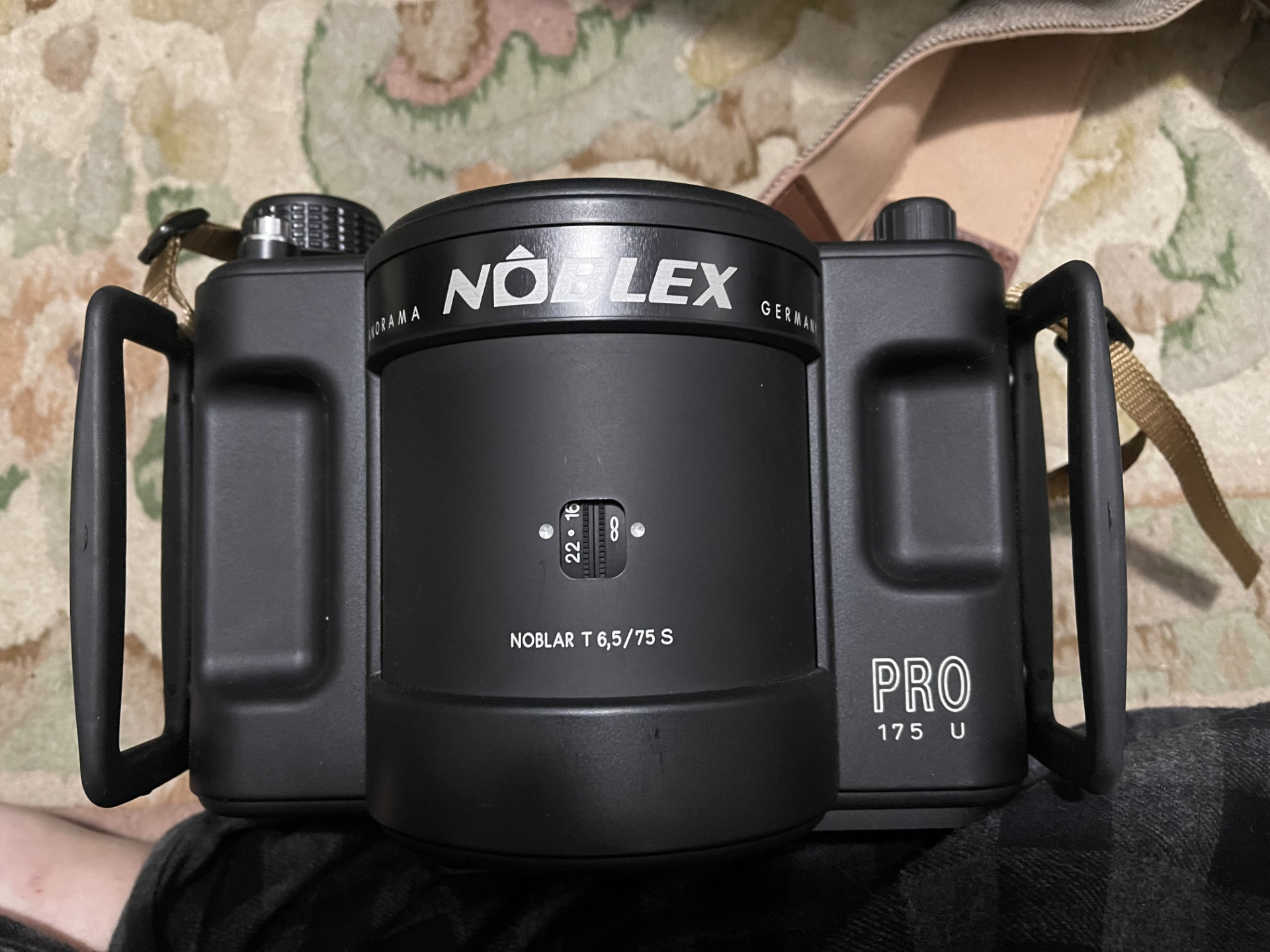

Hello all,
Well, I scored a new "toy"...a Noblex Pro 175-U model swing lens camera. This one shoots my favorite size negative, 6x17 Medium Format Film.
It is coming with the slow shutter speed module....
I've not found much at all on YouTube about this particular model. I've heard and read little snippets that it can be a little tricky loading the film..having to push the film or rear rollers as you close the back, to ensure film is pressed firmly in place and doesn't pull off the take-up reel....
But not quite sure what that proper procedure is. So far, I've not found much info on the online manuals for this camera.
Does anyone have any experience with this camera? If so, I'd really appreciate any links to info, or experience stories of working with it.
I'm thinking this will make for a bit more convenient and portable companion to my Shen Hao 6x17 view camera...keep it for the real precise shots I can plan and set up for, and bring this one almost for times when I just want or need to snap off quick shots without a lot of tripod set up and not needing specific lens choices for composition.
Anyway, it is supposed to be in like new shape and hope to have it in before this weekend!!
It's hotter than hell here already in New Orleans, but I'll try to get out at the crack of dawn this weekend and get some shots before everything starts melting for the day....
Thank you in advance,
cayenne

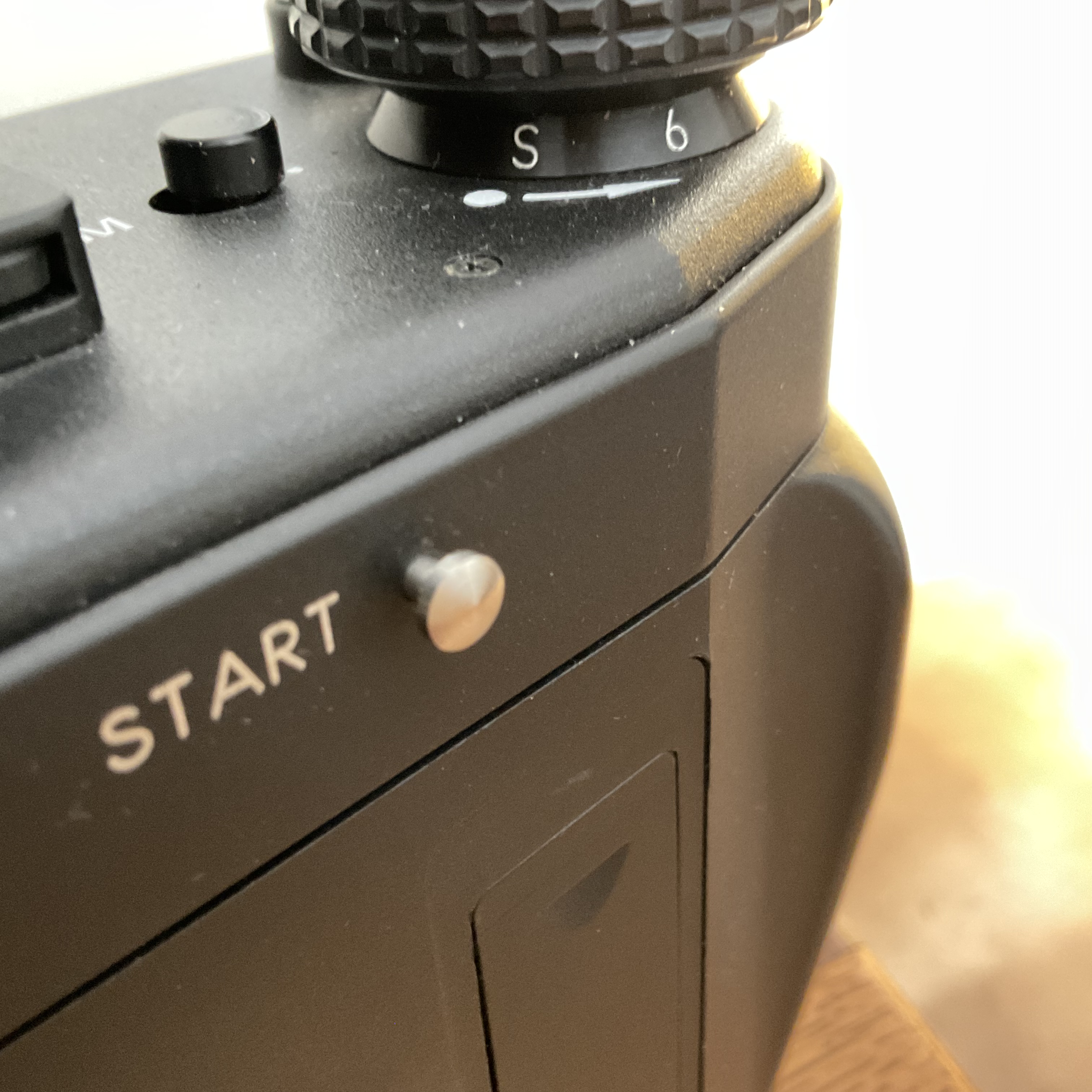

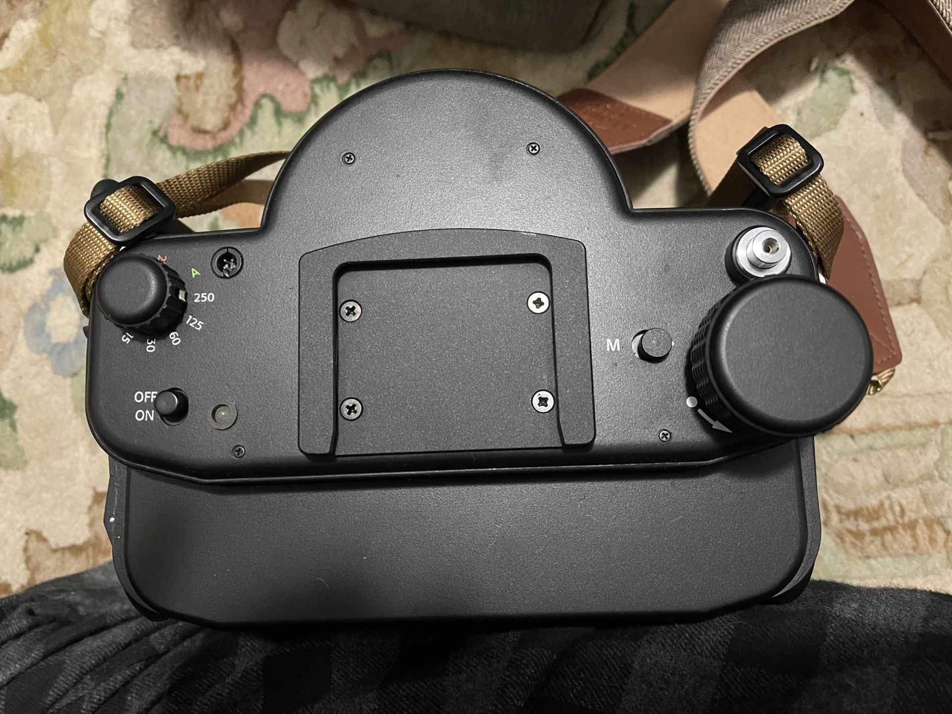

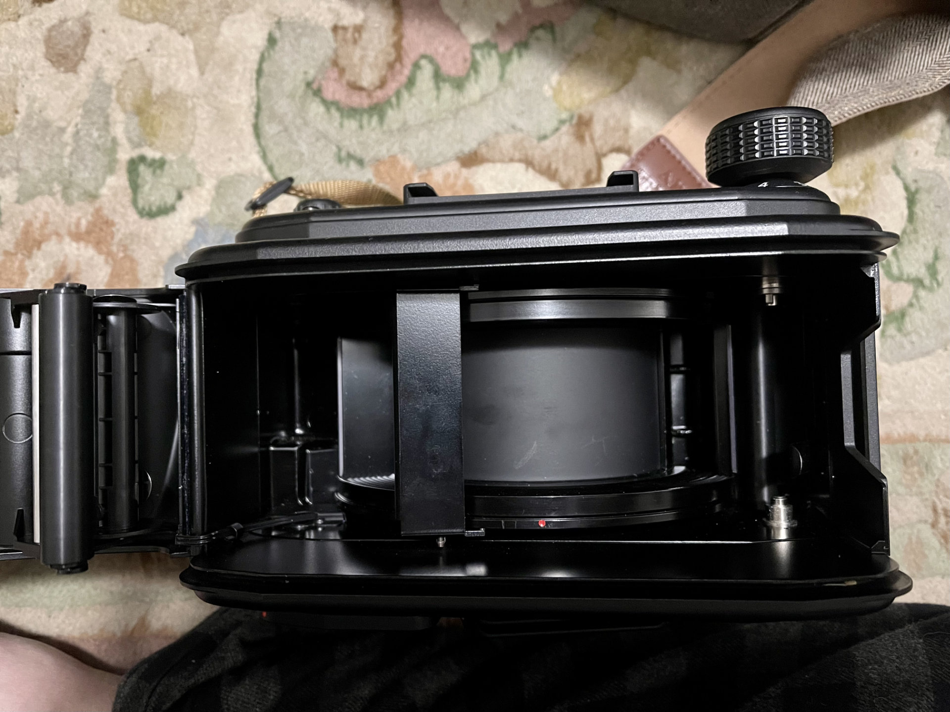

I"m still trying to get something figured out on this.
The instructions seem to indicate there is a button to push when you have put your film on and wound it...to let the camera know when to start counting images.
I don't have this button on mine and I think part of the problem has been, I'll close the door and the film winder doesn't stop at 1...
By happenstance, the other day when playing with it without film trying to figure things out....aftert closing the back I slicked the shutter button, which didn't fire the shutter....but, when I then started winding the film knob, it seemed to start counting frames there.
I'm starting to guess maybe there were 2x versions of this model camera and mine is the older one without the separate button to let it know time to advance the film?
Anyway, still trying to get it figured out....I've blown too many rolls not getting my full 4x frame out of the roll.
C
Citsmith
Dec 31, 2022
58
Michigan
Med. Format Pan
It is a small silver button on the back of the camera labeled START. It is labeled 5B on the parts list in the instructions. If it is not there and there is just a hole, you have a problem to be repaired. That button, as you said, sets the spacing of the film after the arrow is lined up on the film.

Yeah...I don't have that button...puzzled me when I read the requirements.
I thought I read somewhere, this was a later model addition and apparently I don't have it.
But failing having that button...how do you let it know when to start? I was guessing from just poking around that once I get film on, close the back...I hit the shutter button in lieu of a "start" button like you have?

Citsmith
Dec 31, 2022
58
Michigan
Med. Format Pan
In the early models there is no START. Button. You push the shutter button instead.
