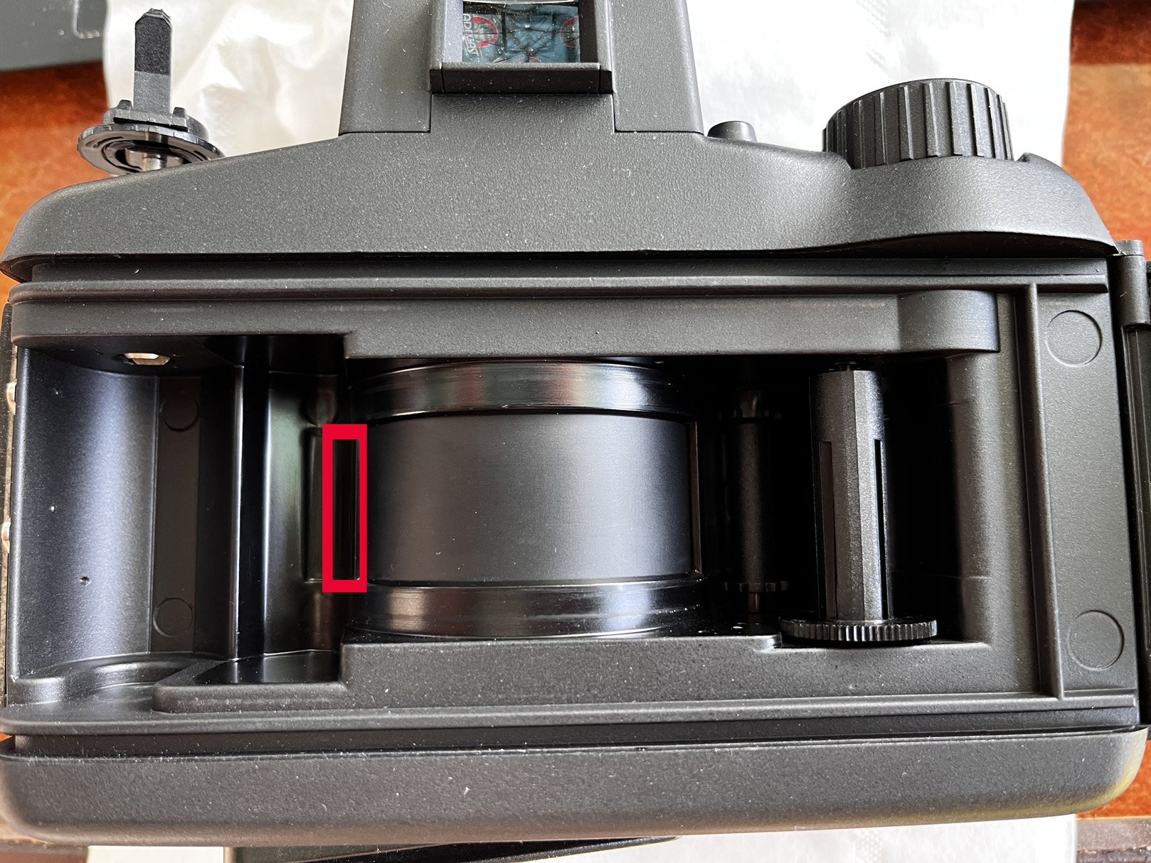

It happens that intermittent horizontal lines appear on the negatives for both camera format models (Noblex 150 and also Noblex 135). I have 2 pieces of Noblex 135 S and both do the marks (1 camera does more visible lines and the second camera less visible). Also my friend has Noblex 135 and also Noblex 150 - both do the marks on the negatives. For one camera the lines are more visible but you can have camera with almost unvisible lines to no lines - then you are happy :smile:
It can help - open camera door and rewind the exposed film back to the canister (in the darkroom or in changing bag).
I am struggling with the scratches (horizontal lines) on Noblex 135 more than 1 year. I have found the critical area - contact with film. Many times I applied polishing paste (for car polish), also used the finest sandpaper (grain 7000) with results - some scratches dissapeared and some new ones appeared - never ending story.
Last chance - I have decided to use nail polish on the critical area inside the camera (attached picture) - result --> NO SCRATCHES FOR NOW! It seems to be solved but I will be sure when more rolls developed.
(similar may be also for Noblex 150)
