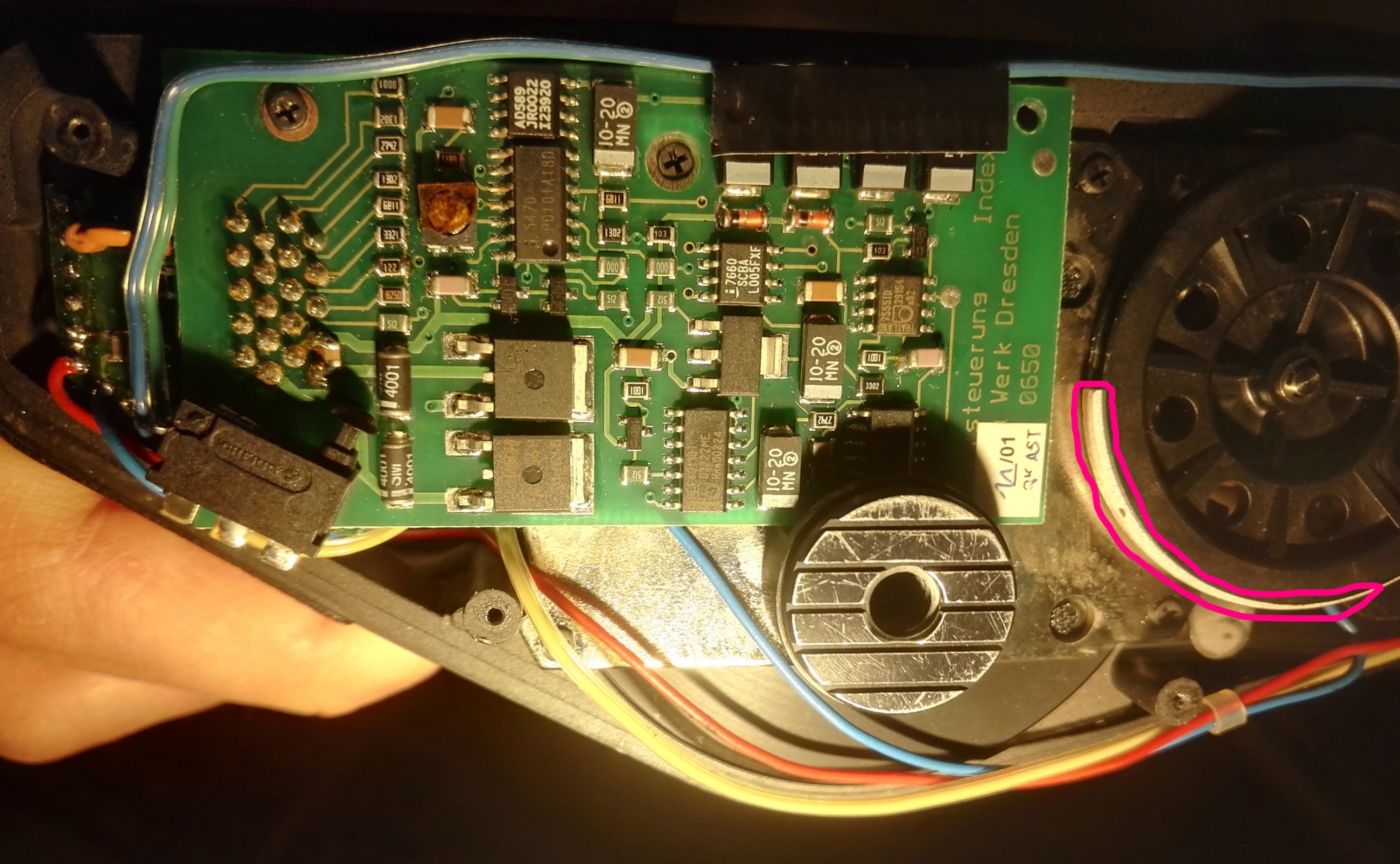

Hello, does anybody found an alternative for the white drive wheel trim (lining - please see the picture) - the most common failure of Noblex 135 camera?
I heard somebody try to use a rubber ring gasket but then exposure times are wrong and uneven rotation speed.
Assumption - there is needed to have the exact the same diameter of the drive wheel with trim/lining (suppose measuring on hundredths of millimetres) and the surface with the same proper friction.

Here is also official repair service I used (Noblex,Mamiya,Bronica,Horizon) in the Czech republic, EU - http://photohelp.cz/
I am waiting for the fix of my Noblex 135 S - estimated costs 350-400 EUR for:
- defective main drive wheel
- time selector contact broken
- fixing the electronics.
- CLA
