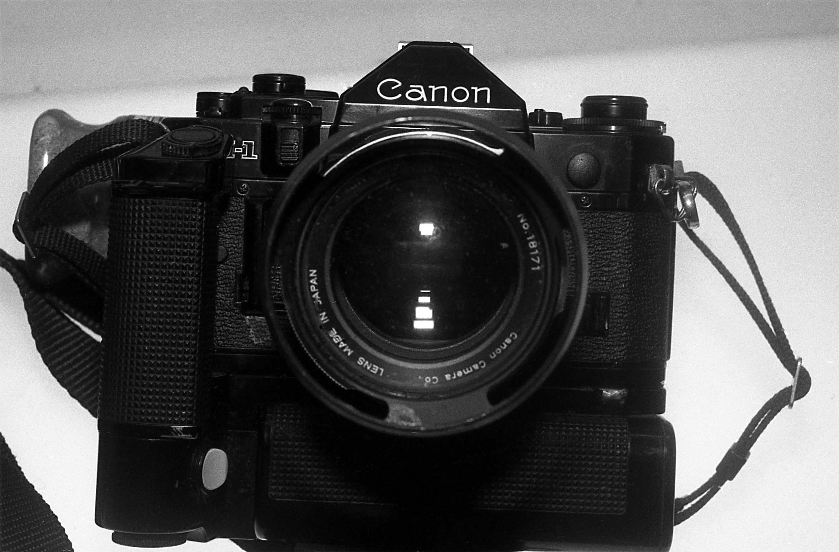

Yes a thing of beauty:
attachment.php

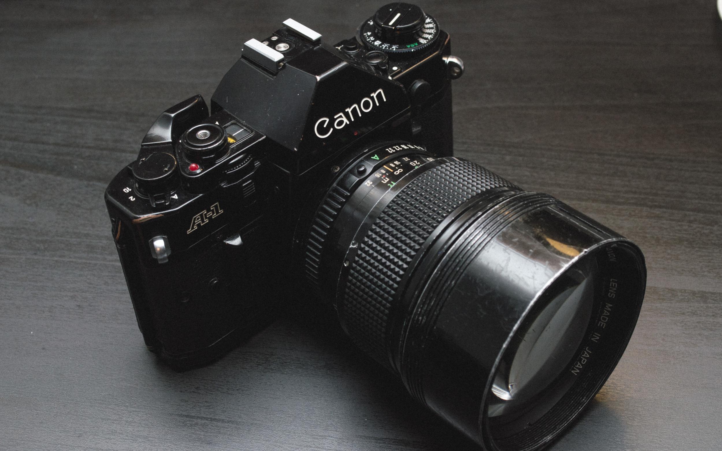

attachment.php
Nice Piece looks great w/ the grip!

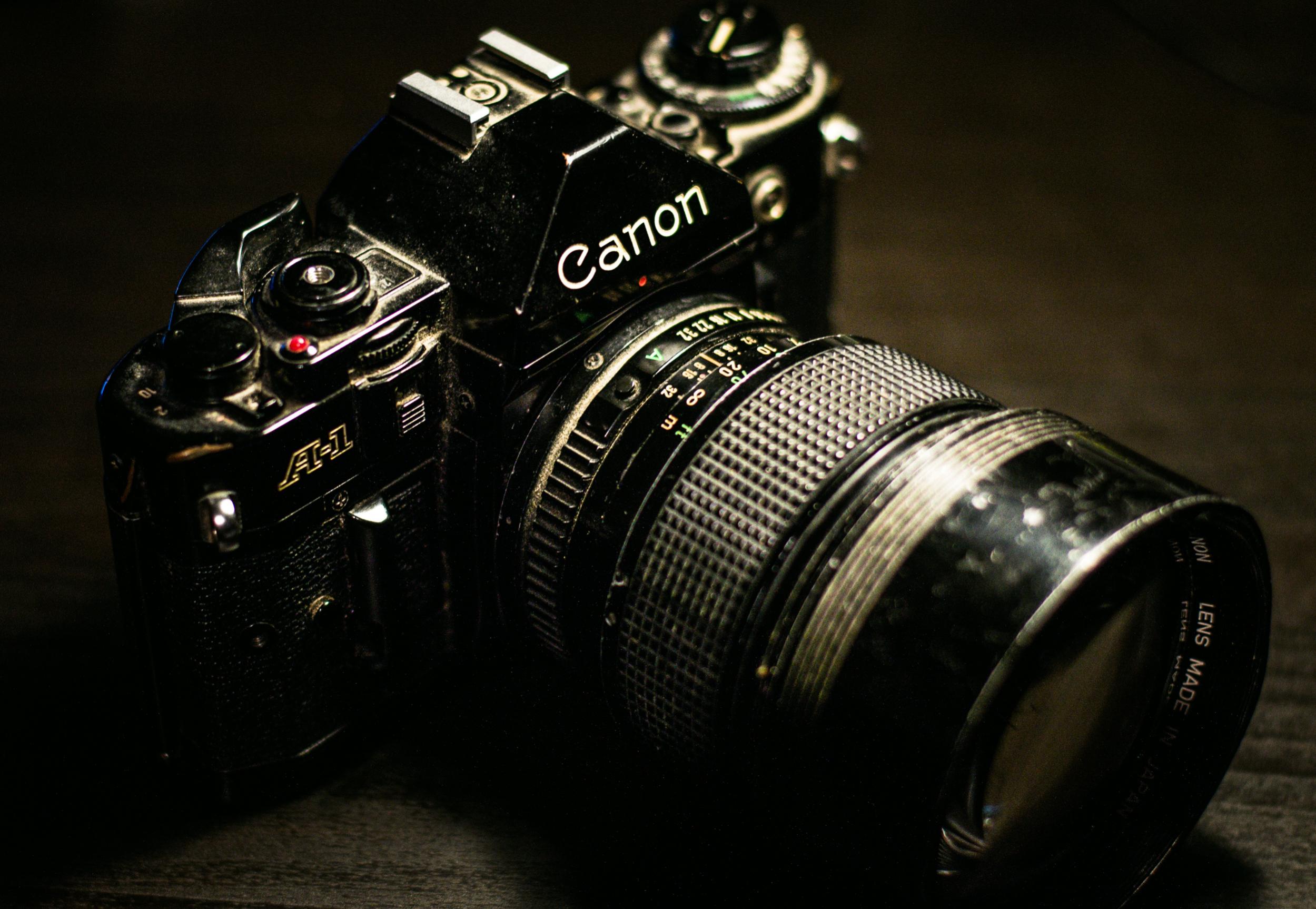

Here's mine when I received it vs now, really reflects on how little everyone else was willing to bid on it:D
attachment.php
attachment.php
Not sure how much it has improved on the inside though haha
