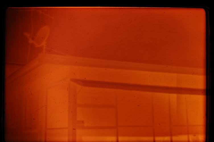

I have just had a roll of old C-41 Kodak Max 400 processed at a local lab, a roll out of a set of three that I picked up at a thrift store while traveling. The rolls were still in their black plastic containers, but not in the boxes, so unfortunately I have no idea how old the film is or how it was stored.
I wasn't expecting perfect results, but I was a bit surprised to examine the negatives, as I found that they had essentially no separation in the colors. :sad:
Does anyone have any thoughts on what might have gone wrong? Is this just what film does when it ages or is stored improperly? :confused:
Here are the "scans" of the negatives (via a Nikon D40 with a slide duplicator), along with my best attempt at a color correction (including the orange mask removal):
Please forgive the composition - the camera is handmade, and doesn't yet have a viewfinder. :wink: I can see that I still need to dial in the focusing and catch a few light leaks as well.
Thanks. :cool:

The problem is mostly in your digitalization method and "color correction". As a quick help, try much more blue light source to compensate for mask to begin with. Or, try making prints traditionally, or ask for prints from a minilab.
In addition, fog in old film reduces contrast and saturation to some extent, so the saturation may be a bit low to begin with.

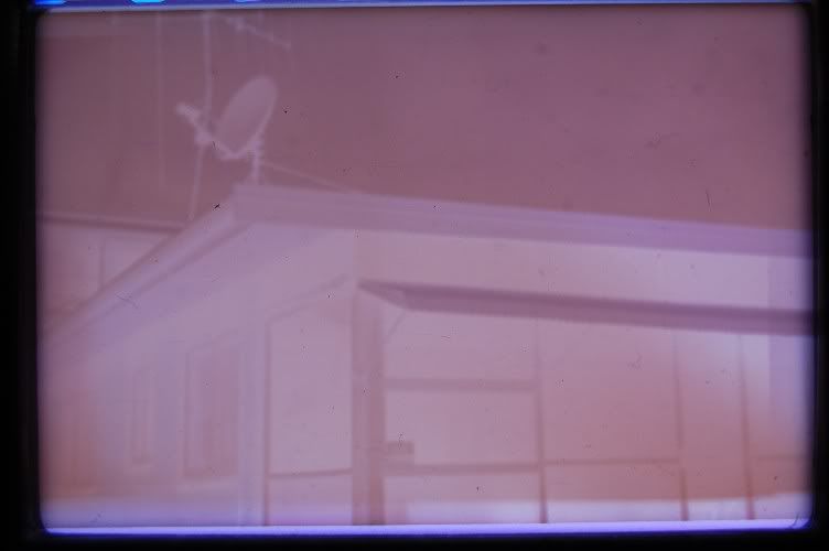

That was it! Thanks!! :D

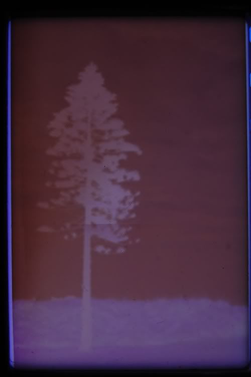

I don't have any genuine blue light sources, so I picked a light blue color and displayed it full-screen on my monitor here, and used that as the backlight for the slide duplicator. It wasn't nearly as bright as using an incandescent light behind it, so my exposure times were really long (4+ seconds)... Here is the blue color that I used:
... and here are the results! :cool:
Thanks again for the tip, that was definitely the key piece I was missing. :smile:
For future transfers, do you have any suggestions on how to obtain a bright blue light source?

Nice that it helped! I've built several adjustable light sources with RGB leds. If you are into electronics, or know someone who is, it is a trivial task of just using variable resistors (potentiometers) as current-limiting resistors for LEDs. Of course as your light comes from multiple LED emitters/chips, you need to diffuse it. You need to experiment a bit, but soon you'll find resistor values that allow you to completely compensate the mask away so that you'll achieve good color balance by just doing "invert". I find this is the easiest way and gives better results than correcting residual color casts in Photoshop...
And remember, even when the "right" color looks quite blue to our eyes, it must still contain green and red wavelengths.
But your method of using your display to create different colors can be actually quite good. Just experiment with RGB values until you find one that gives no color cast (just grey) with the blank orange film leader of the same negative. You seem to be very close.
Thanks for the reminder, that is something that would be easy to forget. :smile:
That's a good idea.
My captures with the slide duplicator are catching a bit of the sprocket area on the sides, which has not been exposed... so those thin strips of bright orange in the first post, and the thin strips of light blue/purple in the second post, are the same color as the leader of the film.
Since this portion is a light blue/purple in my latest scans, instead of a grey, does this mean that I have gone too far with the blue backlight, and I need to make it a bit "warmer" in color again?
Thanks again for the help. :cool:

Thanks, I'll keep an eye out for the gels.
I did a quick test today with a transparent blue lid from a "Gladware" food container, using my original incandescent light source, and got results which were much closer to my second set of results from the monitor backlight. The color wasn't perfect by any means, but they had color! Of course, they also had the word "GLAD" embossed across them. :smile:
My rig is pretty stable (I think...), so merging channels might be an option. I don't intend to scan a thousand negatives with this, just a few dozen, so the workload wouldn't be excessive. I might even be able to script it if I can get the workflow to something consistent... If I did this, would I switch then to an RGB backlight - making one shot with each color?
