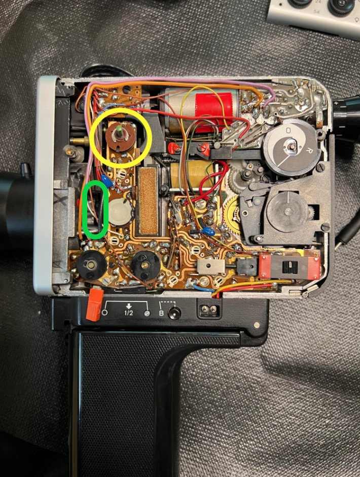

Hi! Could you explain where this needle is? (front panel, left panel, right panel, etc).
I have the same camera with the same problem and am not sure where the screw is you are talking about. Perhaps the attached photo can help you point this out to me.
Needle is part of the lens diapragm assembly which is barely accessible in the area I've circled in green. I did not wish to remove the lens and front panel, which made access to the loose screw trickier than it needed to be.
But whether your camera has the same problem, I don't know: If your camera shows signs of mercury battery leakage, you may have a corroded battery wire.

Thanks for getting back to me. All the screws in this area are tightened. I can see the iris blades and needle move when I do the battery test, so everything appears to be properly connected, nothing stuck. Unfortunately I think I'm calling this a loss, likely a corroded wire.
Why? If you don't know how to solder, or have failed at it previously, there's still hope. IMO, it's kind of a dream scenario when I get a killer deal on an old camera which isn't working, and only need to replace a wire!
Hello! Its a year later but if you still have you camera and still have your issue, I think I solved the same one on my Nizo S480. My aperture wouldn't move from wide open with the aperture control dial, but would close when I pushed the on switch to the left to test the light meter test.
This means either my aperture control dial was faulty or somewhere it wasn't transmitting power to the aperture motor. It ended up being the latter.
Solder a wire to connect the two contacts in the image. This Solved my problem, hopefully it is the same as yours.
I was able to route the wire through the little plastic heat shrink to keep everything neat. Good Luck!
