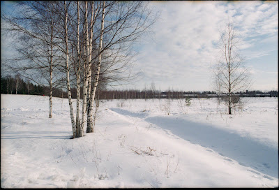

If you would like to see actual comparisons then have a look at my blog here. Keep in mind that the sections represented are 4000dpi scans and with an inch and a half of width that is well over what you would scan for web delivery ... perhaps even what you would scan with 8x10 printing.
So for an overview of the image

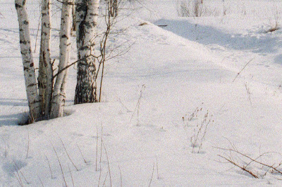

I am examining this tiny portion (of the drum scan)

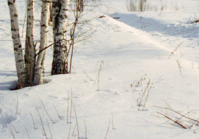

and the Nikon

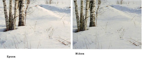

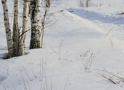

The nikon 4000 actually does pretty well against such a benchmark, the Epson is not as sharp:
but when you resize them to be an appropriate section of a web sized scan that difference diminishes remarkably
epson-nikon-compared by aquinas_56, on Flickr
