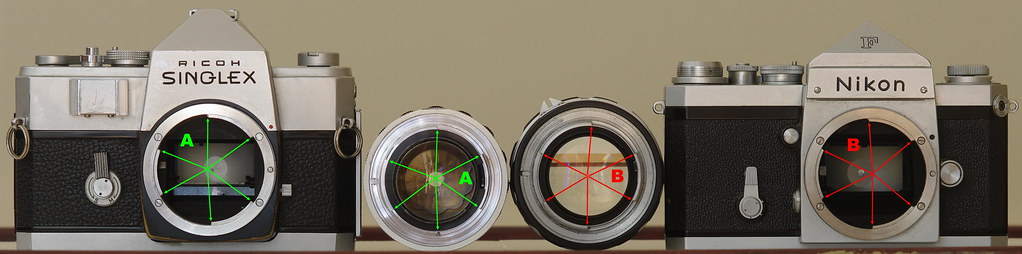

From what I understand while not TTL the meter was coupled to the shutter speed and aperture with a match needle in the viewfinder. I can understand why Nikon allowed Ricoh to use a modified version of the F mount, one that allowed Nikon lens user to buy lens that would mount on the Ricoh, as cheap second body to the F, but could not mount Ricoh lens on a Nikon body, not cheap lens. How many lens it Ricoh make in the modified F mount?
