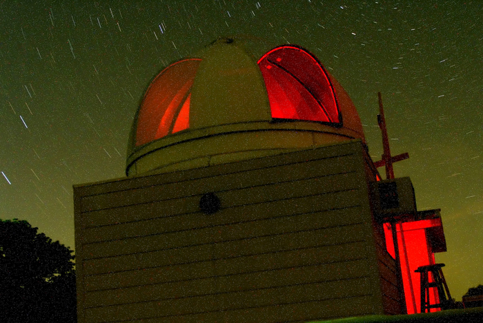

Here are some of my star trail notes:
Camera:
Battery independent Nikon F2
(I would not hesitate using a Nikon FM series camera if I had one)
Lens:
Normal to wide (50mm to fisheye)
Support:
Tripod
Misc:
Locking cable release
Stiff black felt square (5 ½ x 5 ½ inch) to block unwanted light on lens from motor vehicles and air craft.
Exposure suggestion:
ISO 100; f/8; 30 minutes plus film reciprocity
