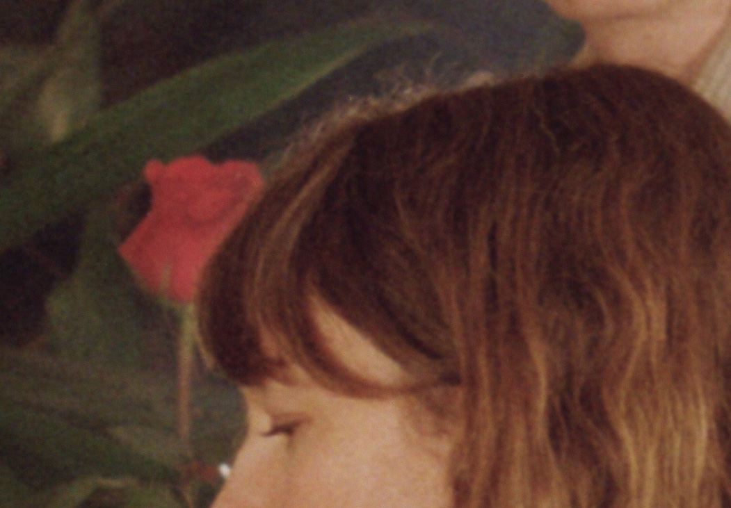

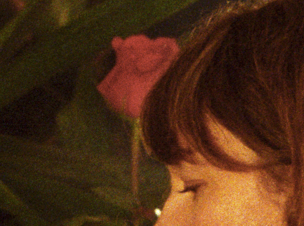

Thank you very much. The first 100% crop shows what Nikon scan gave me with autoexposure, autofocus, and ICE (which is unfortunately necessary as the whole roll was scratched). The second is from my Primefilm XA (which I hope to sell if I get this Nikon figured out) using Silverfast (with Infrared cleaning).

What about the Coolscan + Nikonscan that you need to figure out?
I'm just trying to get more normal skin tones. I'm not sure if I'm interpreting the scans correctly but the Coolscan/Nikon Scan one has harsh blotchy yellow areas on skin tones that I'm taking to be red channel clipping. When I put the Red, Green, and Blue midtone level sliders all the way to the left in Photoshop all that remains are the yellow patches. The negatives are a bit tricky because no blue filter was used correct the color temperature.
