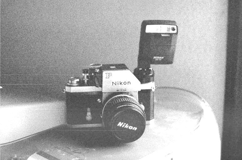

Another option would be the SB-30. Small, flips down out of the way when you're not using it, and can do TTL flash with an AS-17 adapter on the F3P's regular accessory shoe around the rewind crank, or on an FE2, etc. Here's one mounted to one of my old F bodies via an AS-1 adapter.
-J
