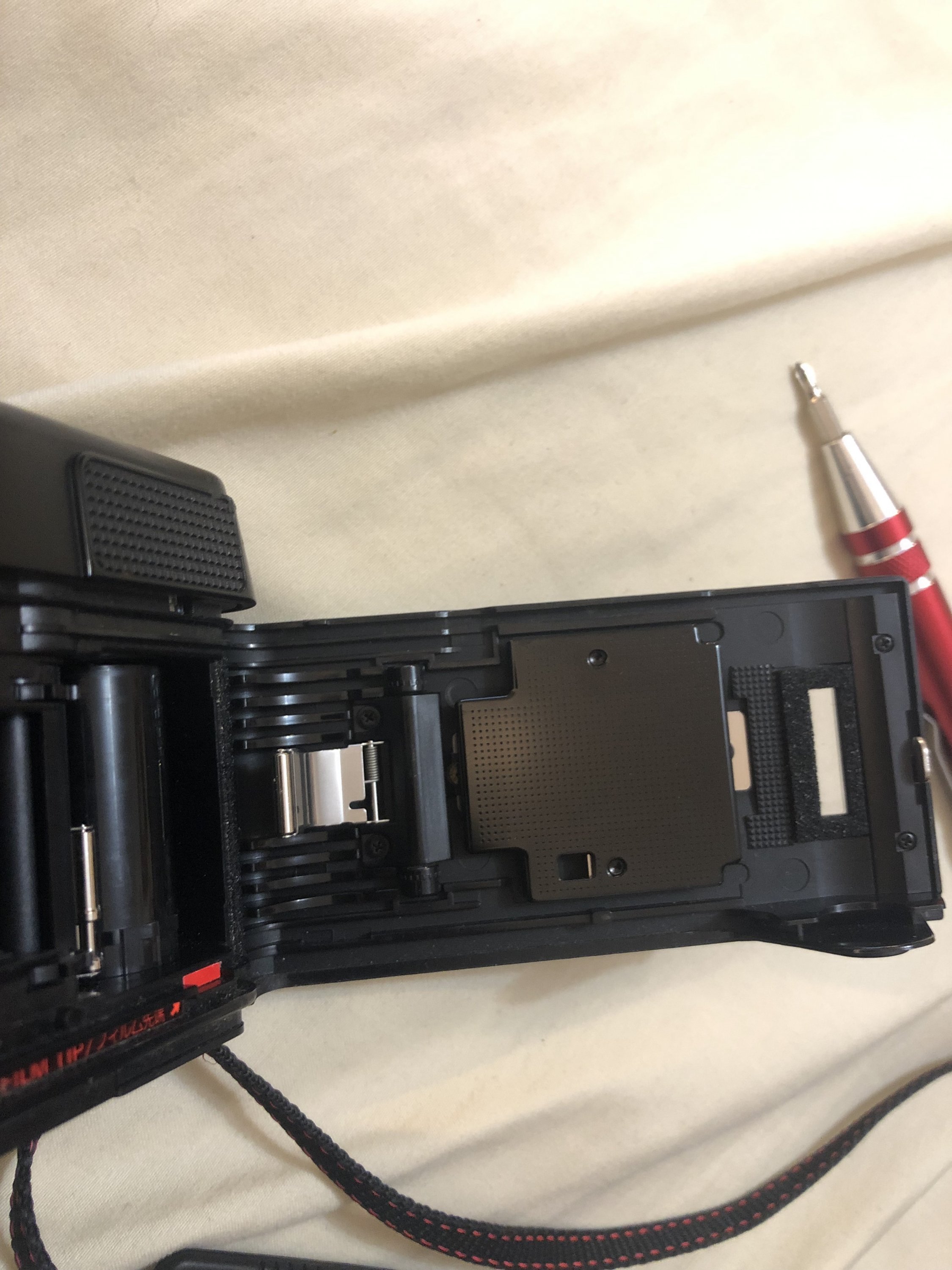

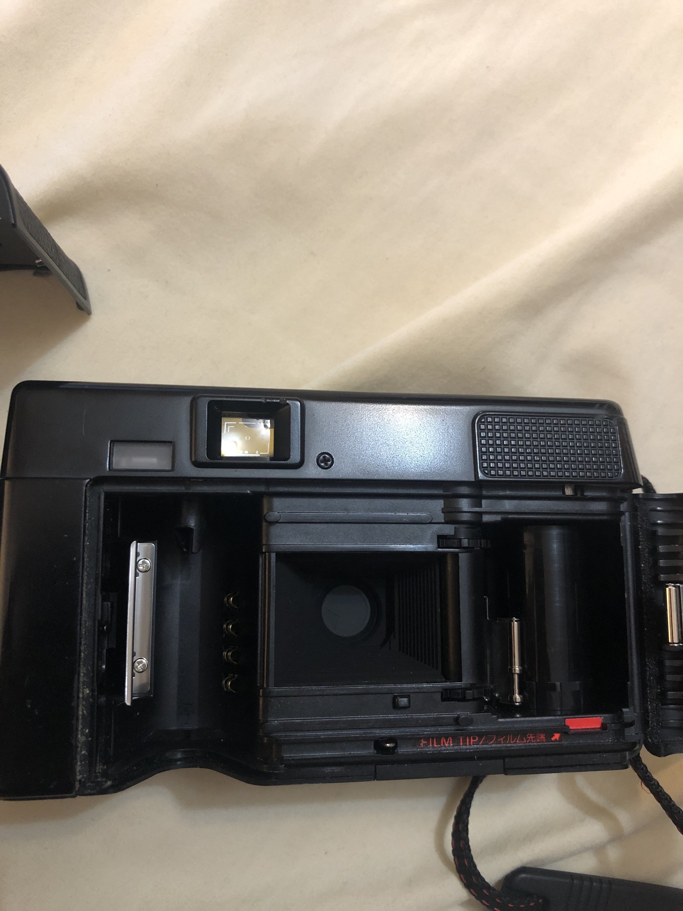

Check the film door side with the pressure plate. Does it look correctly positioned?
I believe it is correctly positioned. I've attached images.
I lightly touched it and noticed it is a bit loose - not sure if this is normal or if it should be tighter.
