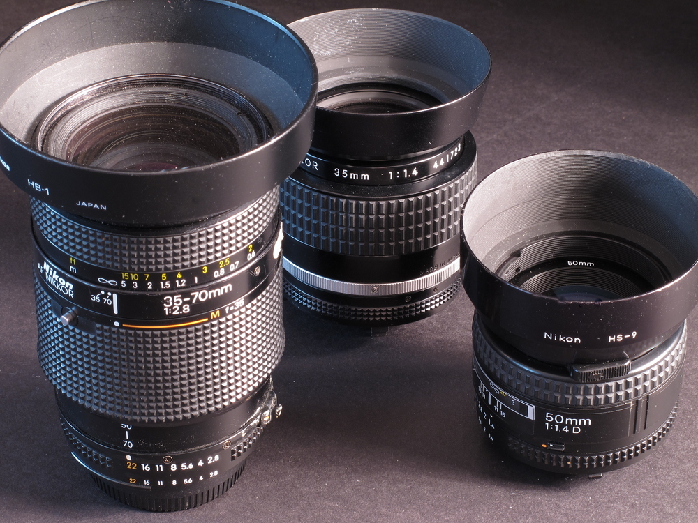

Hi all - I don't have any of the AF-S G lenses.
My Nikon 35mm lens inventory consists primarily of older manual focus prime lenses. I did not begin acquiring newer auto focus zoom lenses until my eyesight began to deteriorate and I began to use the poor viewfinders in digital SLRs.
My 35-70mm f/2.8 AF is very convenient to use but can never be a substitute for my faster 35mm f/1.4 and 50mm f/1.4 prime lenses when lens speed is needed.
On numerous occasions, I have considered replacing it with the 28-70mm f/2.8 but cannot economically justify it for the slightly wider coverage.
I have also considered replacing it with the 24-70mm f/2.8 G AF but this G lens is not compatible with my Nikon F2 bodies.
https://flic.kr/p/qt4y91

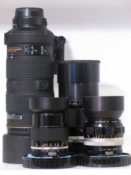

The 80-200mm f/2.8 D AF-S had image quality equal to my 85mm f/1.8, 105mm f/2.5, and 180mm f/2.8 lenses. It is also equal in image quality to the 70-200mm f/2.8 G AF-S lens but unlike the 70-200 G lens, the 80-200 works on my older Nikon film cameras.
https://flic.kr/p/91JPEC

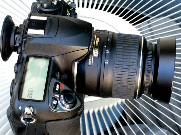

I tried to avoid G lenses and DX lenses because I wanted all my lenses to be able to work not only on my digital bodies but also on my auto focus film bodies (F4 and N70) and my older manual focus film bodies (F2). However, one lenses I could not avoid was the 18-55mm f/3.5 to f/5.6 G DX AF that came with one body I purchased. I thought I would never use the lens until I tried it and was impressed with the image quality this inexpensive lens produced. I now use this lens as a backup to my more expensive zoom lenses. However, it is not compatible with any of my 35mm film bodies.

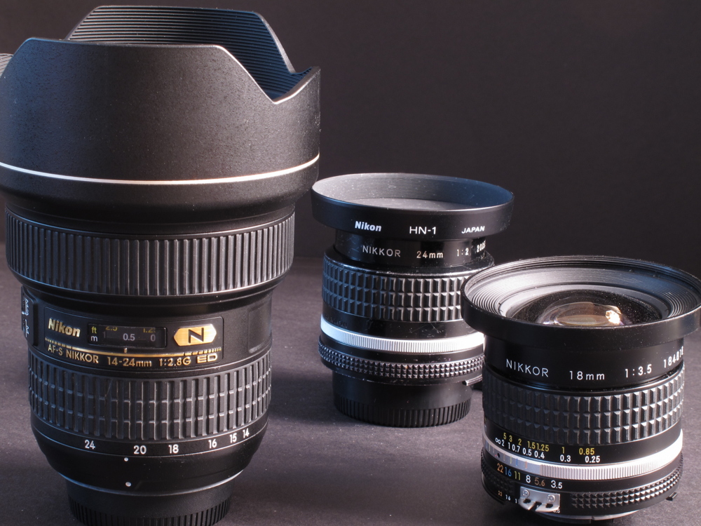

The 14-24mm f/2.8 G AF had image quality that was superior to my 18mm f/3.5 and 24mm f/2 lenses. However, I cannot use it on my Nikon F2 bodies and could only use it in shutter priority mode and program mode on my F4 and N70.
https://flic.kr/p/qbyq31
