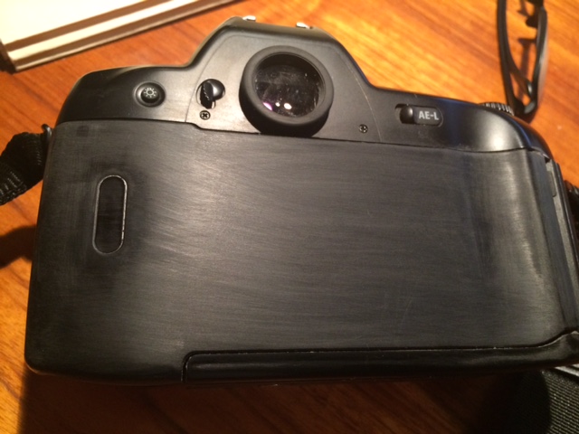

Apr 13, 2016
Portland, OR
Alcohol was not working for me. I used some very fine (P320) grit sand paper. It took an hour to carefully do the entire back but turned out really nice. Looks better than new and has a nice dull/matt finish.
