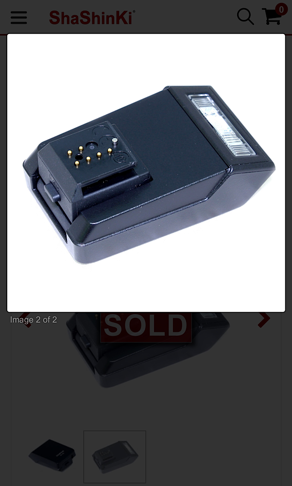

No visible damage, and it`s a pretty new flash, picrelated

I researched, the flash has several contacts for the hot shoe. Definitely more contacts than this Nikon has. There could have been incorrect contact here, e.g. two flash contacts on just one contact on the camera. Is this flash compatible?
Well, it`s really dumb but I kinda thought "what if"
99.9% that it`s incompatible, it draws current from camera to work

The blinking matrix metering icon and the "F--" error both are signs of a failure to electronically connect to the lens with CPU (I think the F-- is related to flash with non-CPU lens). It is possible that the cause is some deeper electronic upset.
The N8008, like most AF Nikons, has a component to protect against high flash sync voltages. However, I don't know if all of the other flash contacts besides the sync contact are protected. The Fujifilm flash is fairly new, for electronic cameras, and from a major manufacturer so I doubt it uses a high sync voltage. But it has a different pin layout, so it might short some of the Nikon's contacts together. In general, it is wise to (1) don't power up a flash before sliding it onto the shoe. Only turn it on after seating it properly. (2) Don't mix and match flashes/cameras with extra TTL contact pins unless you insulate the extra pins from each other. Even if you don't do any damage, it is possible that the camera/flash won't work because the ready signals will be confused.
Not to beat a dead horse, but I looked up the Fuji EF-X8 flash and it is designed to draw power from the camera battery. There's no way it would have worked on a camera other than the Fuji X-series cameras it was designed for.
