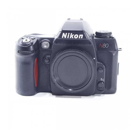

I recently got my N80 out to take on a trip where I wanted something fast and easy with a zoom but I noticed the meter was reading 2 stops off, so 125/f16 instead of 500/f16 as though exposure was set to +2. I double checked exposure compensation and ISO and they were normal/as expected. Is this a common issue? I tried searching and couldn’t find any posts or mentions of something similar here or google.

There is a few metering modes.
- Have you set it to center weighted?
- Is compensation set to 0?
- Have you checked the aperture of the lens? Does it open up completely?
The meter could be in spot mode. It should be in either matrix or center weighted. Besides the meter should be 1/500, f/16, ISO 400 only under very bright sun light. Other conditions it should indicate less.
Tried all the metering modes by rotating the switch, all the same but the reading do change slightly between them so I don’t think the switch is stuck. Exposure compensation was checked (at 0) as mentioned in original post. I tossed on another AF lens to test and no difference. I think the next thing to do is try a hard reset as suggested, and see if there’s any difference.
What exactly are you comparing against?
You might want to meter a white wall with diffuse, fixed lighting. Clear sky or artificial light. If you don’t have a light meter you trust, light meter apps are actually quite good. Certainly good enough for this task.
Initially, just years of experience. I figure if I’m outside, with 400 speed film, and getting exposure readings on the border of being able to hand hold in decent enough light, something is wrong. If I point it at a bright scene in sunlight, and don’t see something within a stop ish of sunny 16, something is wrong. But I verified the 2 (ish) stops difference is pretty darn consistant using my handheld Sekonic and the roll I just shot manually adjusting the ISO to compensate came out basically perfect.

The full reset seemed to do the trick just checking it out in the house against my Sekonic. Looking at the manual, I'm not sure what item in the custom settings would have caused an exposure issue like this, but if it worked, who cares!
