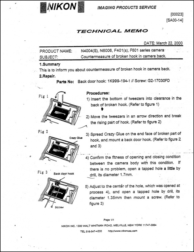

I have an N6006 and haven't noticed anything wrong with the latch. Should I be checking something specifically
The latch hook on the door is a common failure mode. The plastic hook can break off. Nikon used to make a metal replacement hook and they issued a service bulletin for it.
Same here, I have a few F80(s) lying around, although the latches are still good, but I would replace them sooner or later (peace of mind), regarding the glue used, what would you recommend ? I try not to use epoxy, as the more I googled it the more I am confused about bonding plastic to metal. I prefer to use super glue , any brand suggestion ? Thanks.
Superglue worked for me. My original first generation latch is still holding after 2 years. I used Loctite Super Gel since the gel type super glues are not runny at all and make less of a mess.
A good 2 part epoxy would be the absolute best choice for long term performance but you would need to clamp it for 24 hours.
