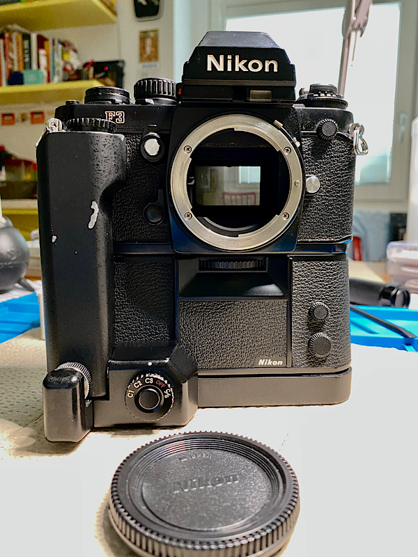

Two flagships and rivals of the 1980s:
Canon New F-1 with Motor Drive FN and Nikon F3 with MD-4 and MK-1, which is mounted below the motor drive.
The Nikon F3 and its exclusive motor drive MD-4 are a perfectly matched pair.
The MD-4 not only cocks the shutter and transports the film, but also makes the F3 more comfortable to hold.
In continuous (C) mode, the MD-4 speeds up the film to 5.5 fps (frames per second), powered by eight AA batteries.

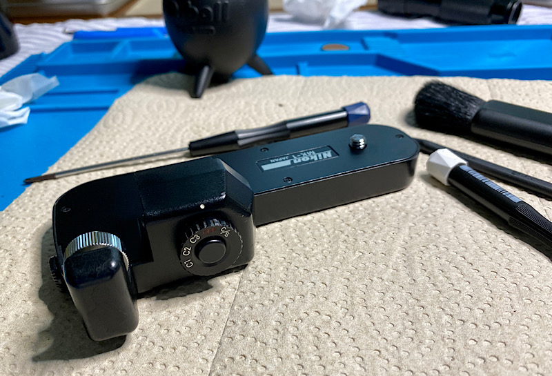

Nikon MK-1: Speed control and shutter release in portrait format

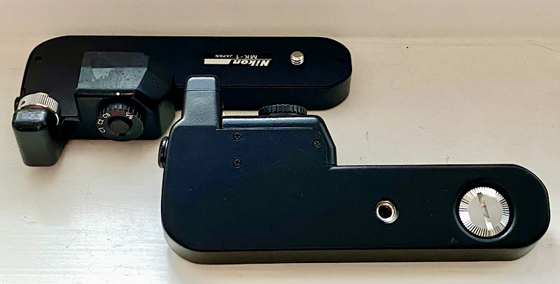

However, you don't always need that much speed, so the Nikon MK-1 firing rate converter is the third in the group.
It reduces the film transport speed to either 1, 2 or 3 fps or leaves it at 5.5 fps. It also offers a second shutter release with which the F3 can be conveniently fired in portrait format.
The MK-1, which is fixed to the underside of the MD-4 using two screws, does not require additional batteries.
A look inside and repair of the trigger
Now available in sufficient numbers on the used market, the MK-1 is an accessory that is made of metal just as solidly as the F3 and MD-4.

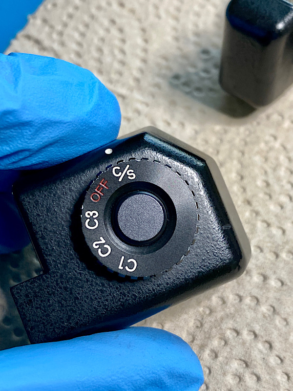

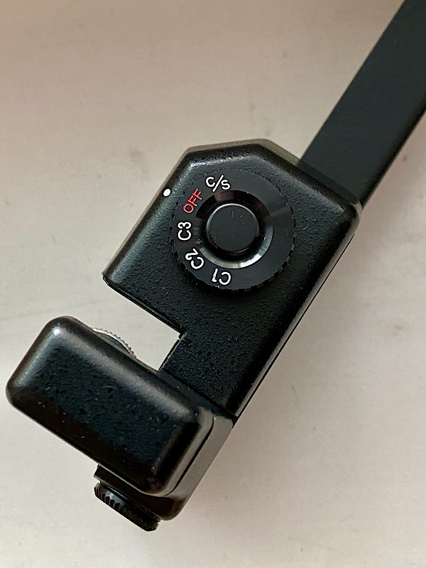

Nikon MK-1, control wheel with shutter release in the middle:
Set the motor speed to 1 frames per second (C1), 2 fps (C2), 3 fps (C3) or film transport at full speed of 5.5 fps (C/S).
OFF locks the shutter release, the film transport speed remains at 5.5 fps provided by the MD-4.

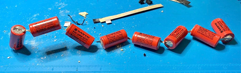

It's just that my MN-2 battery unit is no longer capable of doing that 😝
I know someone who is replacing a worn out battery unit (14 NiCd cells in 2/3 AA size) with 14 new NiCd cells in 1/2 AA size which he puts in the normal battery holder for 8 normal cells in 1/1 AA size.
forest bagger
Nov 9, 2023
254
Germany
DSLR
Definitively not!
That man usually uses modern Nikon DSLRs (e.g. D850) and lenses.
Some weeks ago he additionally wanted to buy an old Nikon F3 HP with MD-4 to work with film, now he got both.
He wants to use it with maximum fps but doesn't want to spend money for an old Nikon battery unit, assuming its NiCd cells would be as rotten as in yours, Andreas.
And now he found a source for new NiCd cells.
I can imagine that you'd be happy if he tells me this source so that I can tell it to you, Andreas.

Definitively not!
Thanks, that's very interesting, but I don't have a charger and the battery holder is broken, so I'll stick with AA batteries.

Yes, that is possible.
The MN-2 pack has 14 NiCad cells and capable of 5.5fps. With 8AA the MD-4 is only 3.8fps. I recelled the MN-2 with NiMH which last 3 times as long as the origninal. The MN-2 is quite easy to take apart as it has screws. You don't have to break it apart. The original cells are rated at 270mAh. I bought 800mAh cells.
Expand on this topic. I have mn-? for Nikon F5 I would like to rebuild. I don't know why 🤔 👍
The MN-30 for the F5 is harder to rebuild because you have to cut it open then reglue it. The incentive? It's the only way to get the 8fps on the F5. Even when I use the external power (which I can crank up the voltage) I can't get more than 7.4fps.
Yes, I have a couple that have been cut open once. It's a complete waste of time, maybe someday 😊

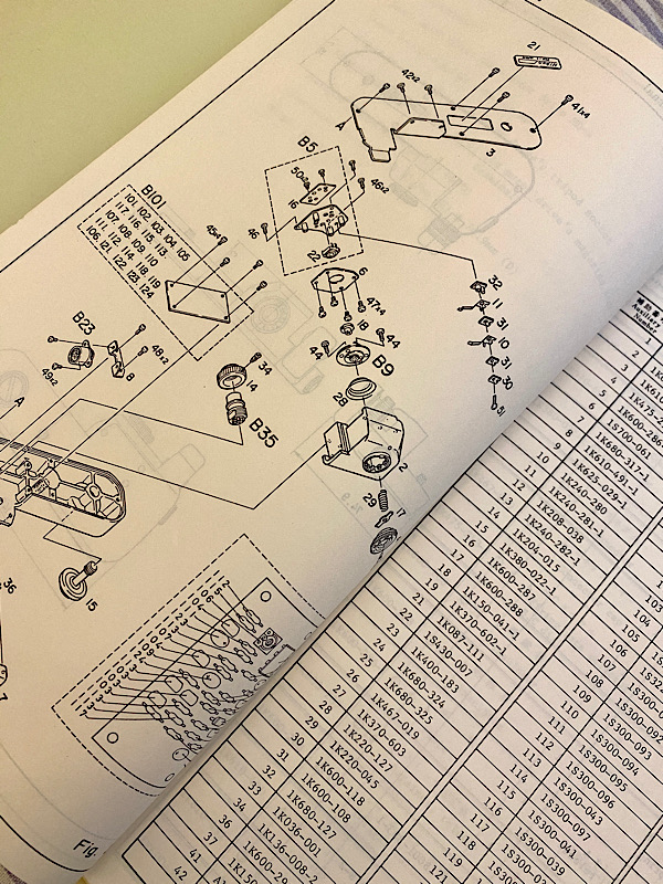

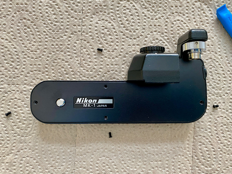

The repair manual has just arrived, so we're getting started.
Since I can't remember which of my MK-1s had the problem with the switch, I'm taking the one with the most signs of wear.
I generally stay away from devices that work. But here it makes sense to make an exception, since the switch contacts will probably need to be cleaned.
Andreas Thaler
Andreas Thaler
Nov 19, 2017
4,662
Vienna/Austria

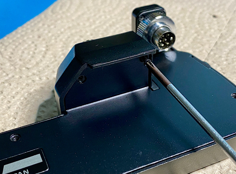

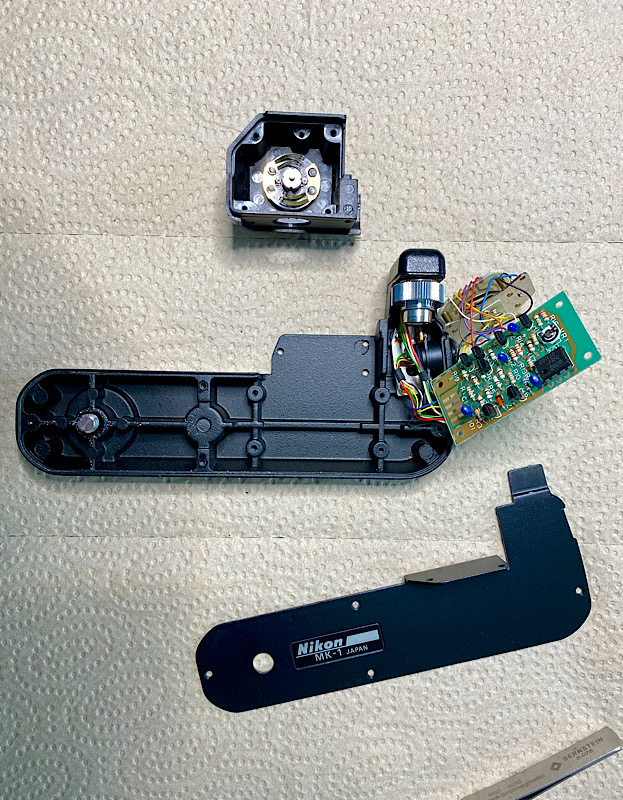

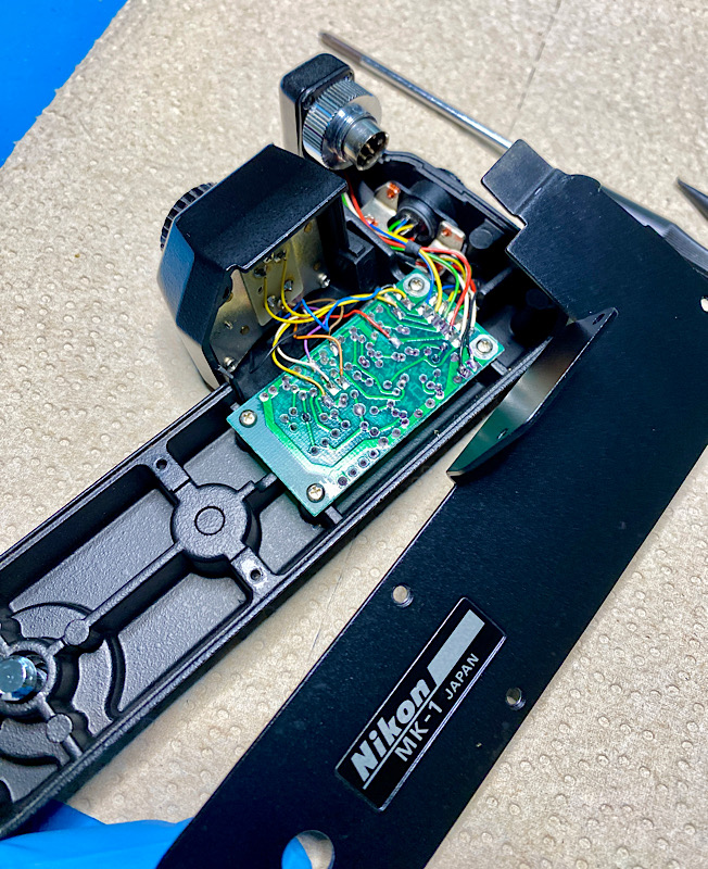

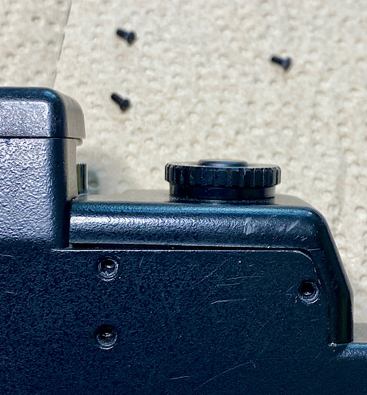

Disassembly

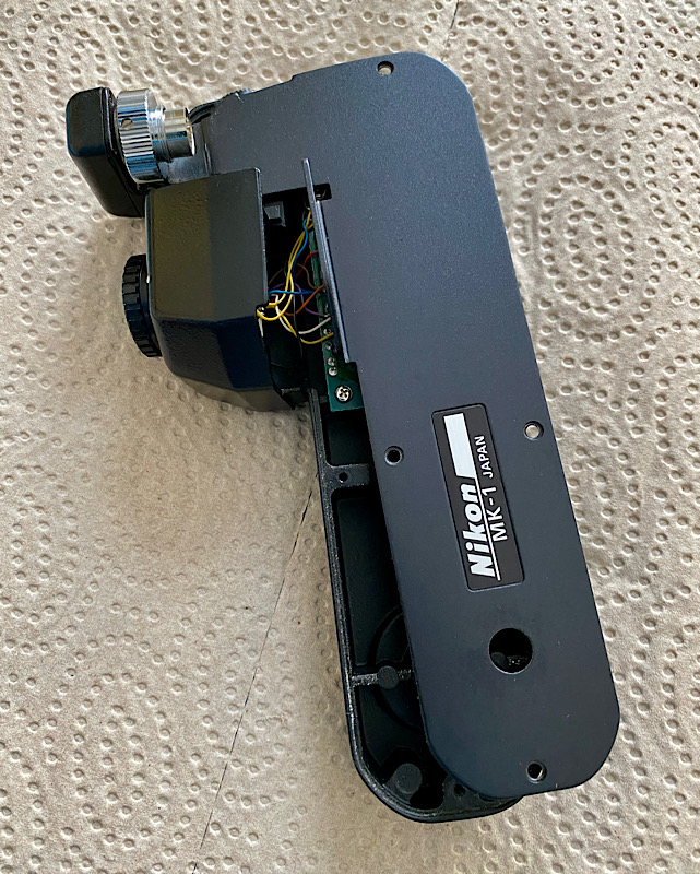

The MK-1 is fixed to the bottom of the Motor Drive MD-4 with two screw connections, which according to the user manual should be loosened or tightened in a specific order, see:
Loosening the screws.
Removing the upper cover plate.

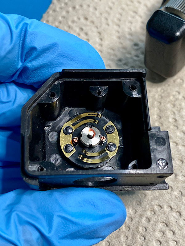

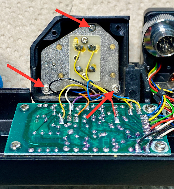

To remove the assembly with the switch, these three screws are loosened.

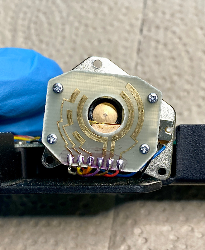

The switch contacts with wipers and contact tracks.
The wipers rotate with the rotary switch that clicks into place in steps.
The trigger moves its two contacts forward and contacts a two-stage switch.
I will clean the contact tracks, wipers and switches.

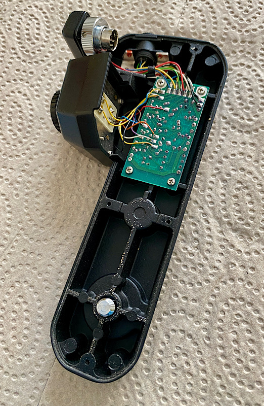

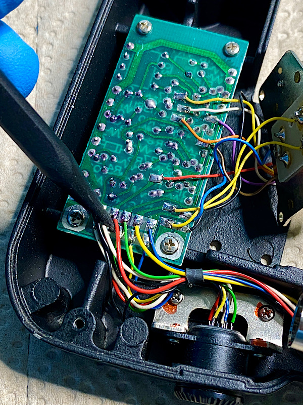

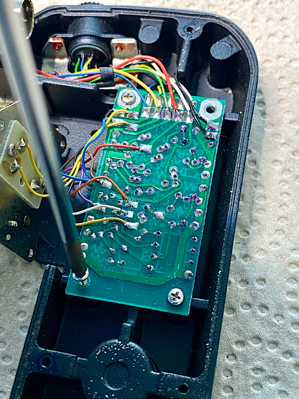

Next we move on to the circuit board.
Analog electronics with discrete components (resistors, transistors, tantalum capacitors, diode, trim potentiometer) and an IC.
I can't find a data sheet for the IC online.
According to the circuit diagram in the repair manual, it is an operational amplifier.
Overview

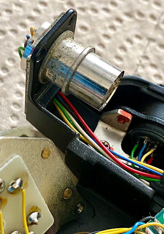

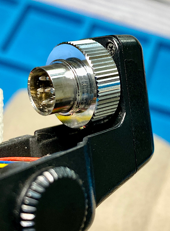

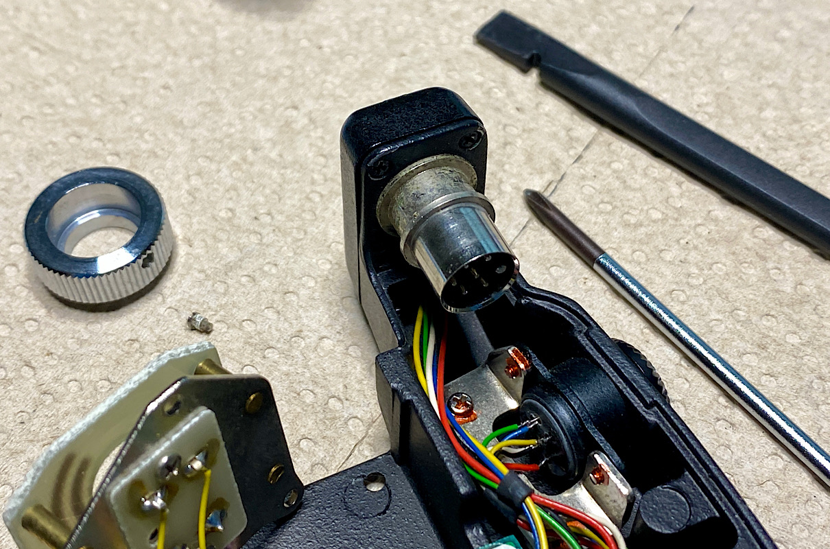

The connection to the MD-4 and cover.
Dirt has accumulated here, which I will also remove.
Excerpt from the circuit diagram.
It is actually an operational amplifier (triangle) which could be connected here as a comparator.
Two voltages at the two inputs (+/-) are compared, and the larger of the two voltages is amplified at the output and is either positive or negative.

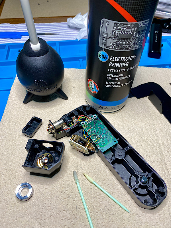

Cleaning and reassembly
Bellows, electronic cleaner, cleaning swabs.
Dirt has accumulated in the recesses, which I remove with isopropyl alcohol.
First, the plastic cover is mounted with the four screws, then the ring is put on and secured with its screw.
It doesn't work in the reverse order because the ring partially covers the drill holes for the screws.
I check all the soldering points.
No complaints here.
Mounting the retaining plate for the rotary switch with three screws.
The cover plate is placed on.
Only then is the assembly with the rotary switch screwed on as it covers the vertical part of the cover plate.

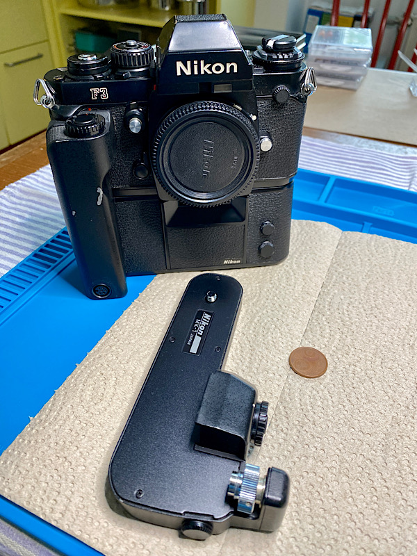

Ready
Test on the F3 with MD-4 - everything is fine 👍
