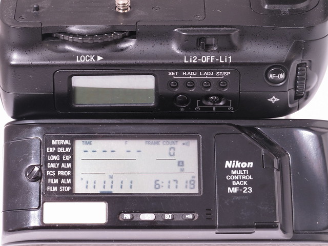

Good luck in your search for a Nikon MF-23 data back (bottom) for Nikon F4.
I have found the data back useful for the following:
Astronomy (long star trail exposures)
Astronomy (sequence shots of an eclipse)
Time-lapse photos of growing plants or blooming flower
Periodic shots of bird feeder in hopes of catching photos of birds
Pole Aerial Photography (high-angle shots taken while the camera is attached to a tall pole)
Long exposures required for shooting night landscapes
Long exposures of chemiluminescent objects in the dark
Long exposures of bioluminescent objects in the dark
Long infrared exposures
Delayed exposures that are longer than the delay provided by the camera self-timer
How do you plan on using yours?
Battery Pack & Data Back by Narsuitus, on Flickr

They also provide a "trap focus" feature whereby the shutter is tripped when an object comes into focus.
Useful for various sports and wildlife photography.
@narsuitus, yours is the first I've ever seen that is actually functioning. I've been looking for years and have found only junk. Sad!
narsuitus
Nov 24, 2004
1,813
USA
Thanks for the information on the "trap focus" feature.
I was unaware of this feature because all except one of my sports and wildlife lenses are manual focus. One of these days, I will have to try the "trap focus" feature on my one auto focus lens (Nikon 80-200 D AF-S f/2.8).
