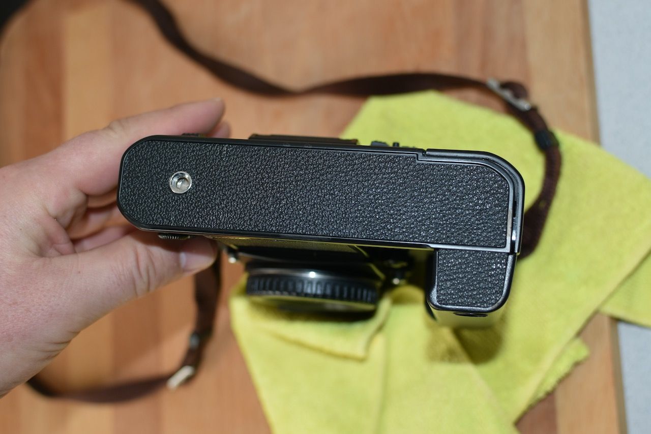

I finally took the plunge and tried repairing my MD-4. It was plain dead: no battery test, no rewinding, no signs of life at all.
I cleaned the contacts inside the battery compartment and also the coils in the battery holder, that were a little corroded. Tested and it still looks dead.
I did an almost full disassembly and found a handful of broken wires, which I resoldered, following the diagrams on the service manual. There are detailed drawings of the PC board and all the wires are color-coded, so I am pretty much convinced I did it right.
While at it, I cleaned the gears next to the motor with naphtha (lighter fluid) and lubed the shafts and some small moving parts with light clock oil. I got lots of black gunk out of it.
Reassembled everything according to my disassembly notes and the manual and tested. Battery indicator works. The right LED lights up when the trigger knob is moved to S or C and won't go off. I checked the frame counter and the end-of-roll sensing contacts, which are not shorted. Everything else doesn't work. :sad:
I didn't reapply the leatherette and am thinking of trying once more, but I am not very hopeful.

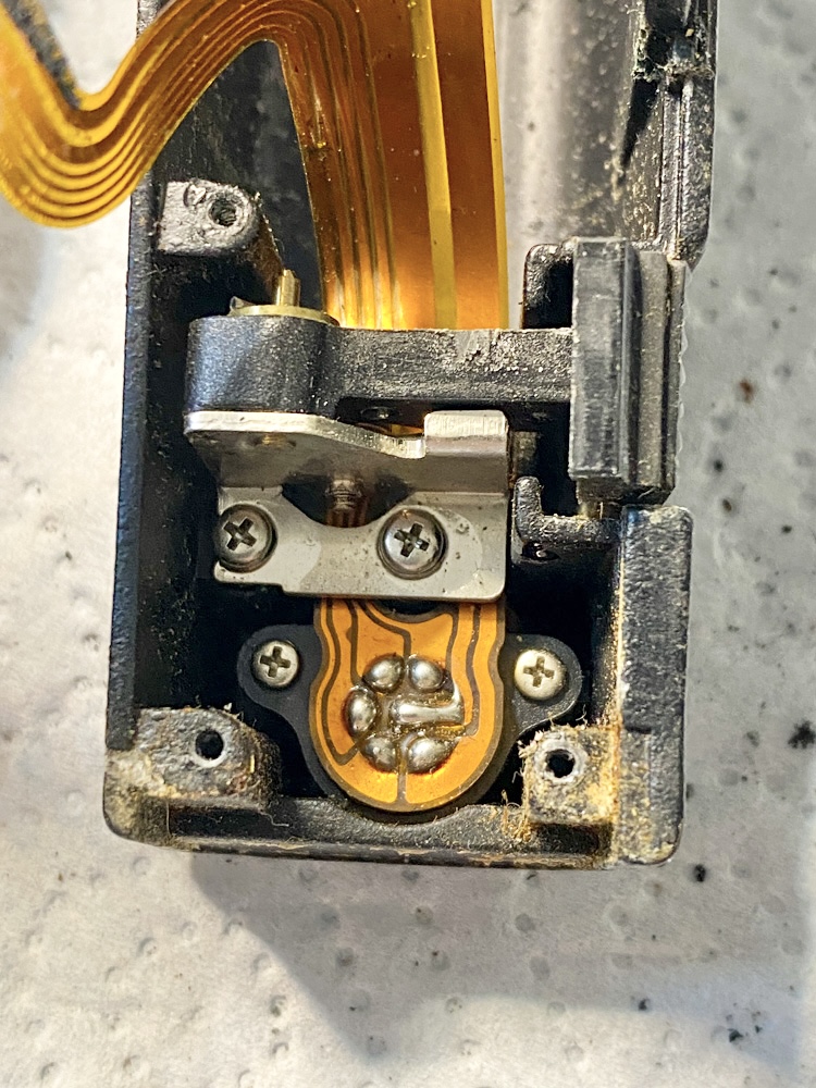

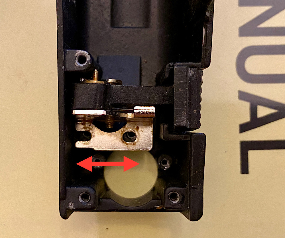

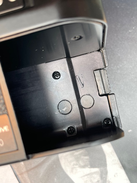

Time to pull up this topic: I just acquired an MD4 in very nice condition which, thank god, is working flawlessly together with a fully working camera.
But there is one minor thing: The battery-compartment is not sitting snug inside in the MD but can be pushed in by about a half to a full mm or 32th to 16th of an inch.
The inside of the compartment and the insert look clean and perfect. The latch connects positively and is not worn.
To me this looks like the latch, holding the battery-insert in place has moved outword over time.
Honestly it is just cosmetics as the insert makes perfect contact but if anyone nows a method to easily adjust the position of the latch, I'm all ears and say thanks in advance!
This is about the worst it looks:
Nov 19, 2017
4,863
Vienna/Austria

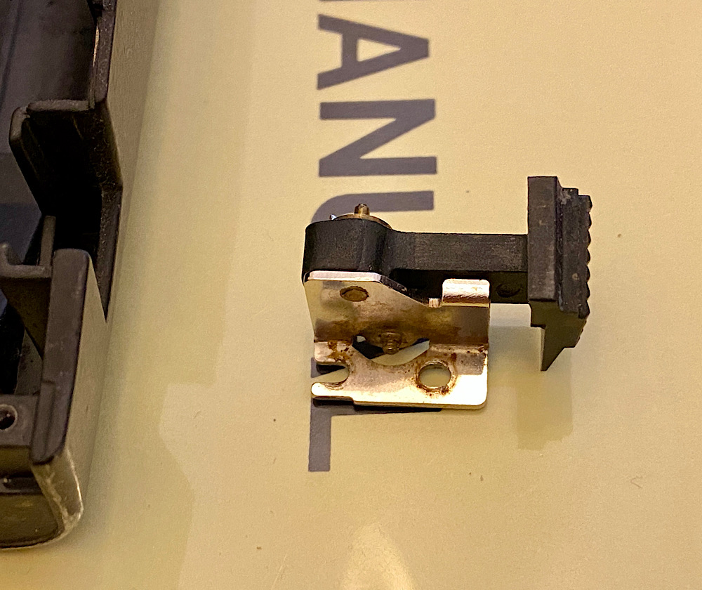

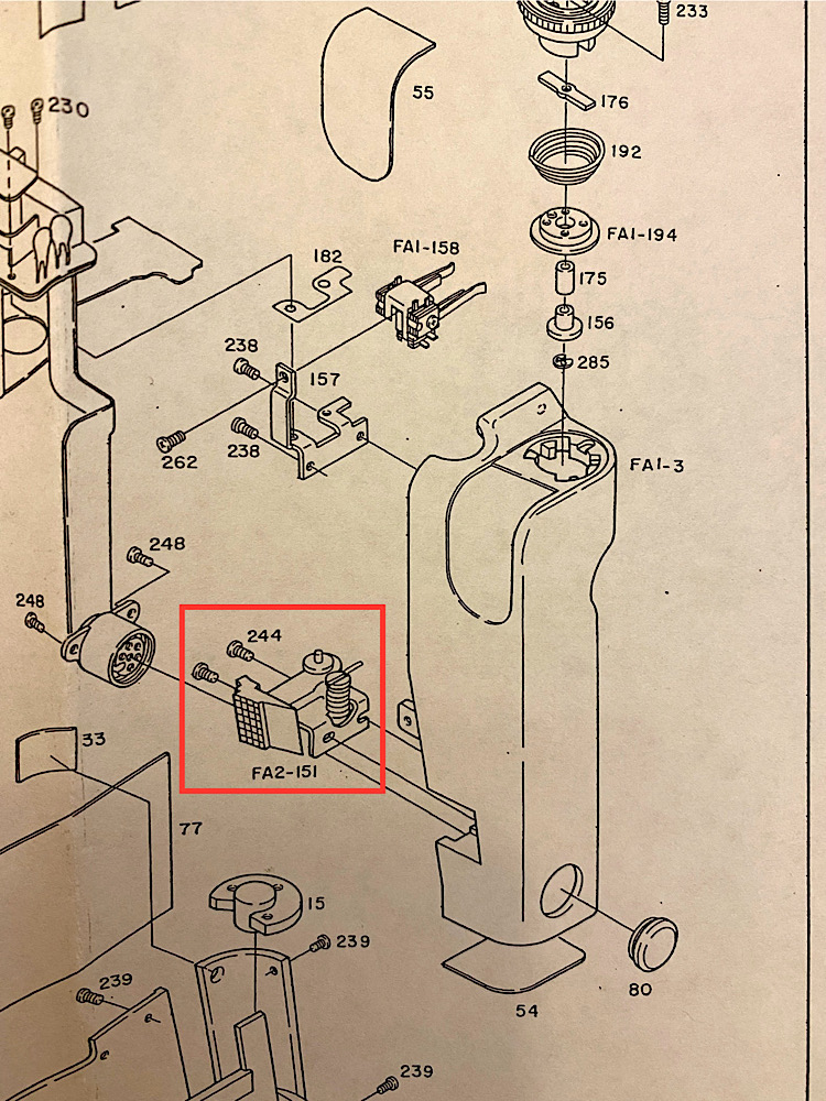

This is the slide for locking the battery holder. It is attached to the battery handle with two screws and can be adjusted in two directions.
Nov 19, 2017
4,863
Vienna/Austria

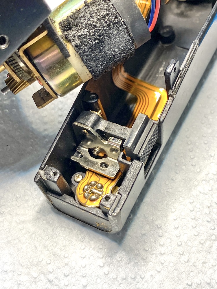

The handle can be separated from the Motor Drive housing loosening three or four screws. A small piece of leatherette must be removed from the bottom.
The handle is then only connected to the housing via a flexible circuit board.
It's all very robust and solidly made.

I'm impressed and draw my hat! That is all I need to fix it and exceeds my wildest expectations!
Many thanks! 😀😀😀

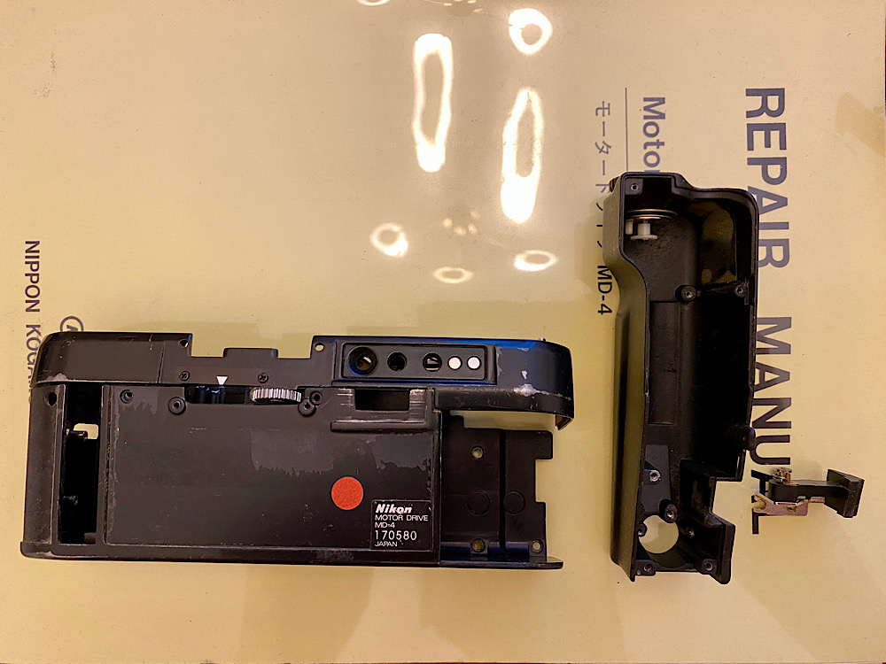

Just to get this straight, steps are:
1. remove the three (in my case I see three) scews inside the drive, behind the grip.
2. Carefully peel away the leatherette under the grip. As I take if from the pictures, partially removing it from the rear should suffice.
3. The grip is only connected via the circuit board and there should be enough room to loosen the screws holding the slider just a bit, adjust, fix again.
As always take pictures for reference generously. Saves more time later than it takes.
Sounds straightforward, I guess the scews holding the slider just have loosened at one point.
skahde
Feb 16, 2004
671
Germany

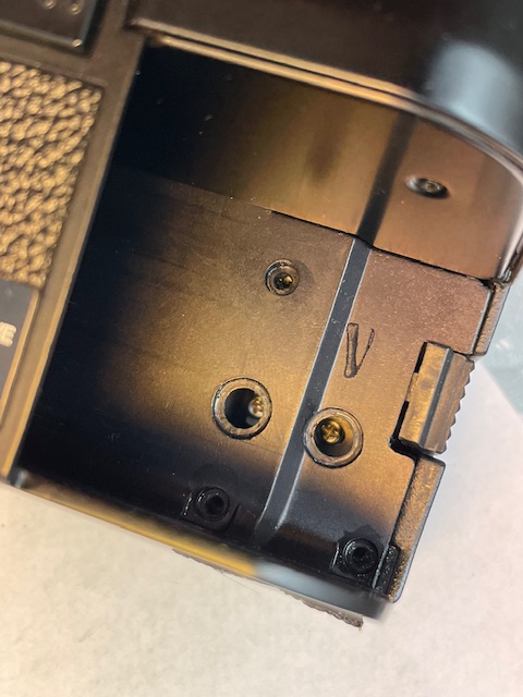

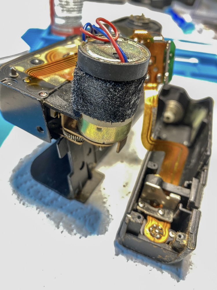

I tried to remove the grip and after removing the above mentioned screws inside the compartment and on the right side of the motor I could move the grip away from the body at an angle but not enough to reach the screws to adjust them unless a bent screwdriver was at hand. I figured that this may not be the intended way to do it and took a closer look at the parts in my hands. And indeed: Access to the adjustment-screws from the battery-compartment is only covered by two small black metal-disks which can be easily peeled away and glued back later.
So just in case, someone needs to do this in the future: Remove the disks, loosen the screws a bit, wiggle the catch for the battery-compartment as much in or out as desirable. Fix the screws and redo until you got it right. Then tighten the screws and glue the disks back on.
In my case, I unfortunately managed to kill the motor in the process. Maybe I broke a connection when separating the grip from the body or I flooded it with too much lighter fluid when peeling off the leatherette from the bottom of the grip. I may look into this at a later point as the motor is to nice to discard it and it's also against my standards for myself to let the story end this way. At least I have to give it another serious try and really get to my limits of competence before I give in.
