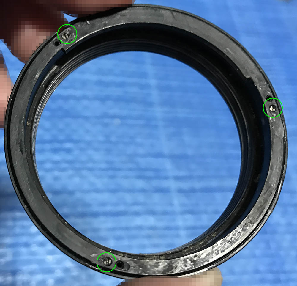

Nikanon, did you figure it out. I have not set infinity focus on a Nikon lens, but other similar. Did you see this, which is I believe the adjustment on your lens?

Is that ring supposed to be able to be turned to adjust an infinity stop? I have not figured this out yet. I attempted seeing if the mirror was the issue by wedging and depressing it, and the image plane just became tilted in either direction and seems even as it rests, I didn’t think that was the issue. I really believe it is the infinity stop issue because most of my other lenses focus to infinity perfectly on the same cameras , my 35mm f2 and 50mm f1.4 however do not but still make excellent pictures at distances closer than infinity
