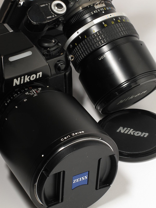

Nikon lens should I go for AF or MF
I want prime lenses only 24 mm and 135 mm to begin with.
For my Nikon F2 manual focus bodies, I went for manual focus primes lenses. My 24 is the f/2 and my 135 is also an f/2.
My Nikon F4 auto focus bodies work well with my manual focus prime lenses. However, I went for auto focus zoom lenses for the F4. My manual focus F2 works well with my 20-35mm f/2.8, 28-70mm f/2.8, and 80-200mm f/2.8 auto focus zoom lenses.
In addition to Nikon lenses, also consider Zeiss manual focus prime lenses.
135mm f/2 Lenses by Narsuitus, on Flickr
