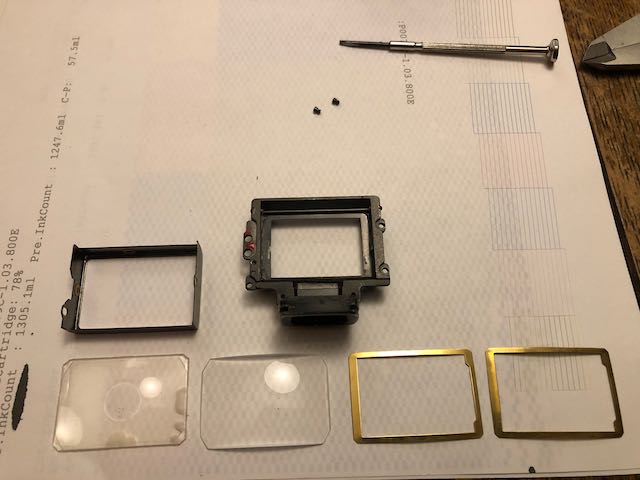

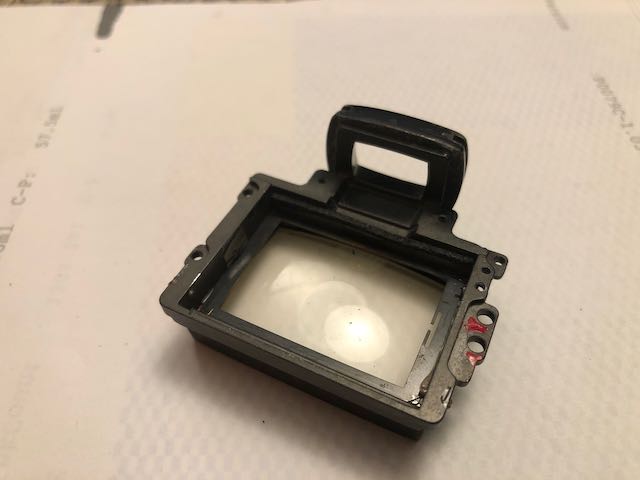

Interesting thing is that you can swap F and F2 actual (optical) screens with F3's. Just keep original F/F2 frame. They are the same size.
Here is Pentax Spotmatic focusing screen assembly. Sorry, did not take any pictures while taking F's screens apart.
I always wanted to replace SPF's screen with something brighter and my repair guy always refused to even talk about it.
It was finally clear to me why when I took it apart.
