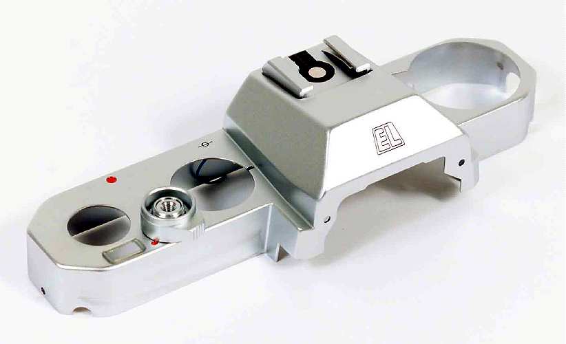

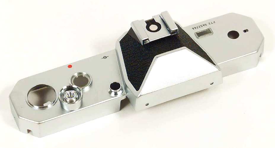

Well, yes, it works as you found out the same for the ELW and EL2 (I have an EL2).
The top plates are different from the FT3.
EL2:

FT2:
attachment.php

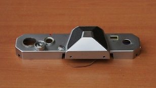

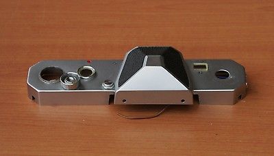

The good news is that you might be able to put a top of the FTn on a FT3. see the FTn top:
attachment.php

EL2:
attachment.php
FT2:
attachment.php
attachment.php
what I want to know is if the locking shutter button/meter switch can come off the ELW top and be put into the top of the FT3 and connected to my meter?
That answer can only be given by:
1- reading the repair manuals and
2- trying it.
Unless someone has already done that, you're on your own. Good luck!

There is a third possibility if those camera parts in the picture are rght there in front of you? If so can you glance down and see if there is any obvious reason why they wont interchange? Thanks.
Gary,
Those pictures aren't mine. I don't have those parts. Sorry!
Check the buttons from the inside of the cover. I vaguely(!) remember them being staked in place.

The top covers are not interchangeable between an FTn or an FT2/FT3 body. Sync terminal on the FT2 and FT3 is mounted to the casting. The FT and FTn sync terminals are mounted to the top cover. You could get it to work, if you took a Dremel tool and cut off the lug that the sync terminal goes through, but then, if you decide to revert the camera to stock for selling purposes, you can't. It'll always remain a modified camera. As far as I know, the shutter release collar on an FM or an ELw/EL2 won't work on an FT series body, at least easily.
