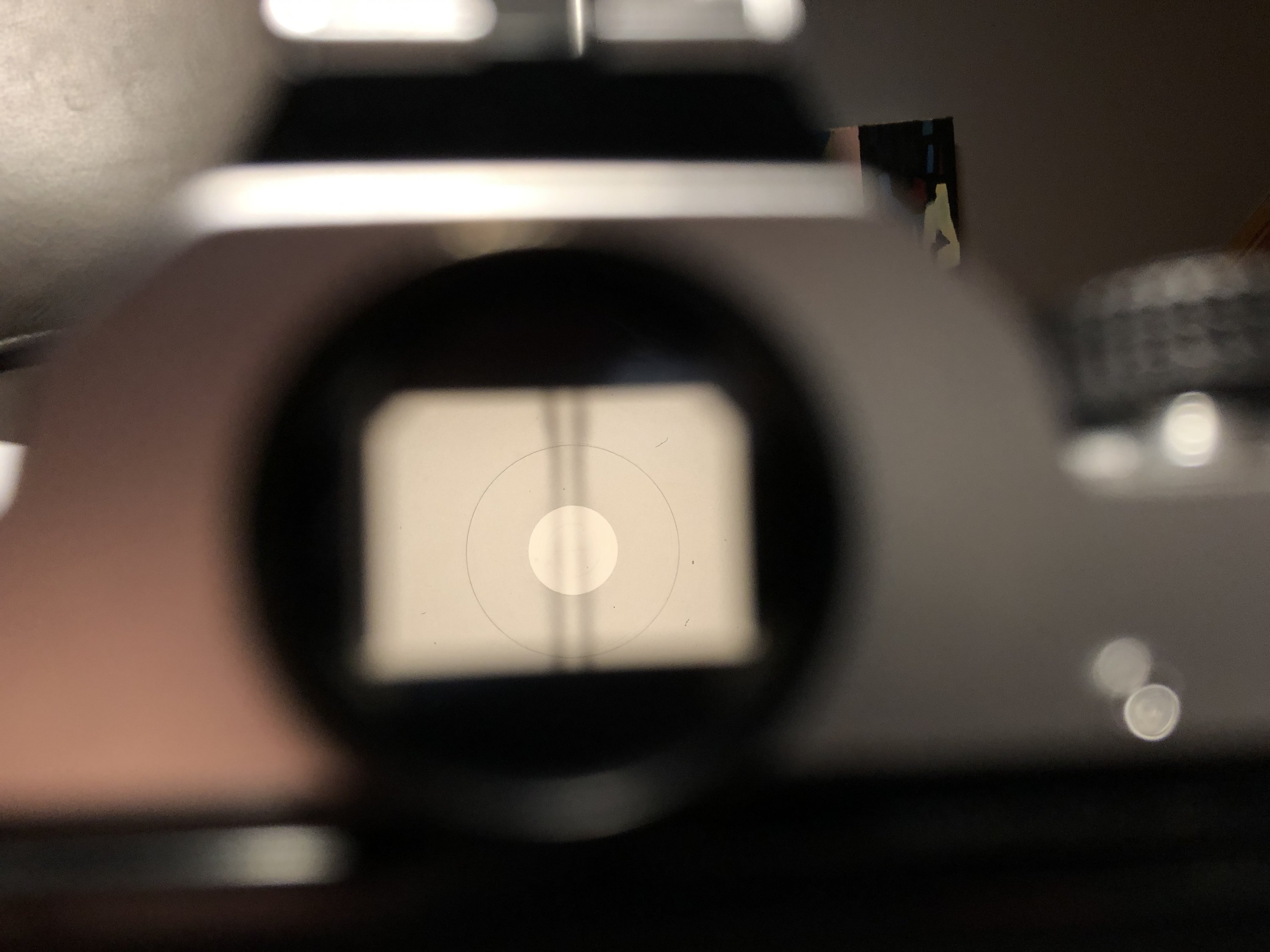

I would appreciate any advice to address issue with a Nikon FM.
The camera functions perfectly well but a few weeks ago two blurred lines appeared in the centre viewfinder.
They are less obvious in bright light and do not affect the photographs taken at all- just annoying that they are there.

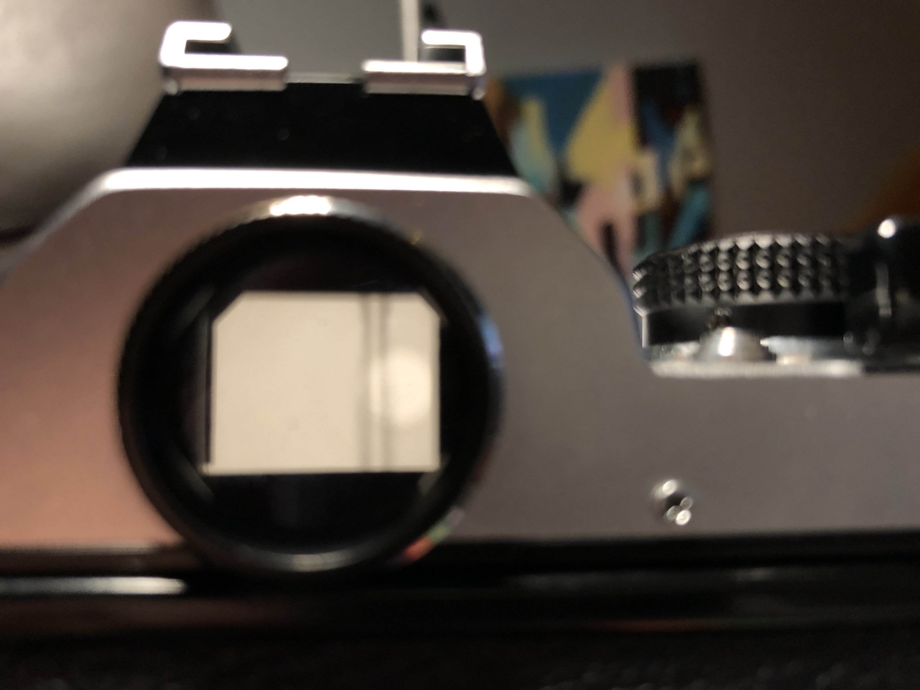

The lines are symmetrical and do not jiggle when camera is shaken. When I move my eye in the viewfinder to extreme left to right, they change position relative to the focusing screen donut. (see pics)
As the eyepiece, focusing screen and mirror are clean and seals robust, I assume it is the lines are within the pentaprism.
On the FM is is not possible to remove the screen so I have no simple access to check inside the pentaprism cavity.
Short of a total pull apart is there anyway to address the problem?
Thank you

I would suspect a de-silvering issue with your pentaprism...
https://www.fredmiranda.com/forum/topic/935620
Looks like an identical issue discussed above. It will only get worse if you don't remove the foam touching the prism.

Desilvering at the crest of angles of the pentaprism not uncommon. I've seen it with the nikon brand more than any other.

Thank you everyone for your advice.
Looks like it would be impractical to repair.
