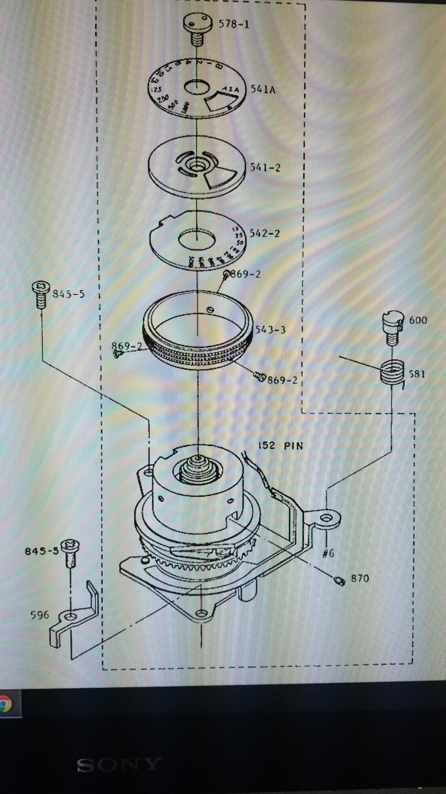

sure but sometimes I want a certain aperture and want to prioritize it. Sometimes I want shutter priority and I just adjust aperture. I guess my main gripe is that it takes a fair amount of fiddling and pressure to change the shutter speed while looking through the viewfinder. I wish it was clickless like my aperture rings. (i removed the clicks and love it. ) If I cant have stepless speed with the FM can I at least have clickless speed selection? Whats under that dial? Thanks.

Thank you Kino. It looks to be just a removable tang. Do I dare??

ya so.. I took the dial apart and it is not at all like the diagram. The click cannot be removed this way. The click is actually under the top cover which I stopped myself from removing. I have it all back together now and everything works fine. I did notice that my shutter speeds indcator in the viewfinder is off by 1 speed. So at actual 60th of a second on the dial and actual shutter speed, the indicator in the viewfinder is saying 30th. I honestly never noticed this before so I dont know if this was there before or if I caused it. Anyway now that I am aware of it, does anyone here know how to adjust this? With my ocd and all this is going to bother me.

No. Nikon FM cannot have the shutter dial made smooth. It can not be de clicked.
