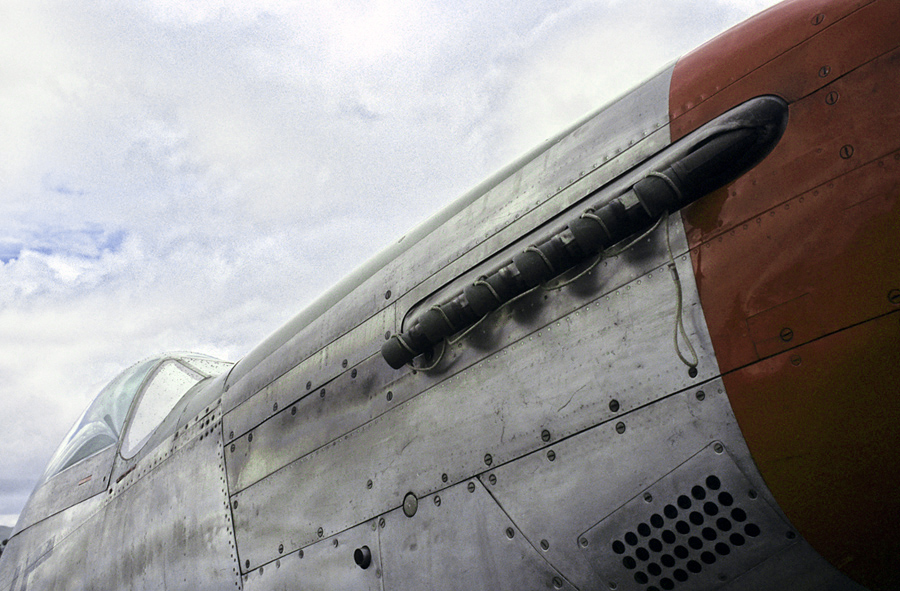

The 20/2.8 AIS is a great lens. Relatively small and very sharp.
