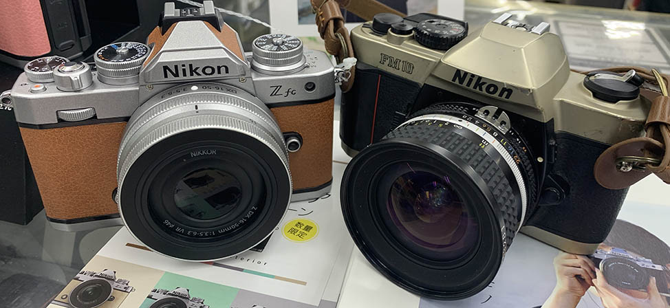

Hello
Every once in a while I see these
Golden metallic Nikon cameras for $100 or less, questions
A) anybody own use this model pros/cons?
B) I have a older f2 model this new camera doesn’t look nearly as robust?
C) was thinking of point and shoot with my 35mm f2 AI lens.
D) Metering is it led like the earlier FM models, accurate?
Thanks for your responses many of the old Nikons I have used all seem to have the internal light meters identifying as Non-Op.
