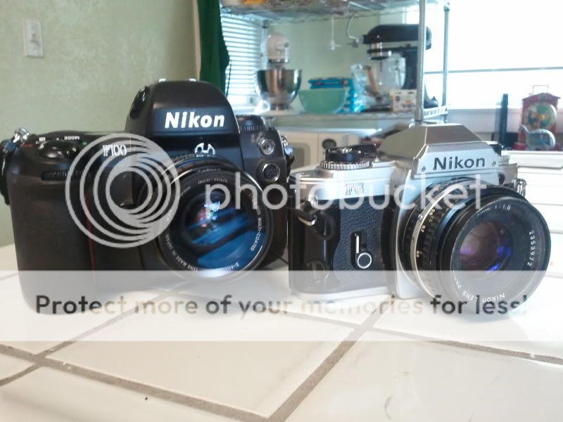

I happened to get lucky on one and buy it. It came with dings and screws missing. Is my favorite smaller format camera to shoot. Takes knocks and then goes 'so what's the next shot about?'
Effortless shooting plus all that toughness. What more might I want... Hmm. Maybe weather sealing.
But then an F5 isn't that compact!
Ricardo, ah really? Guess I got really lucky then - I was very happy that I could use regular ttl flashes on the camera. :smile:
Although I prefer having it off camera and wirelessly triggered. (mines fg20 -dunno how much they differ)
