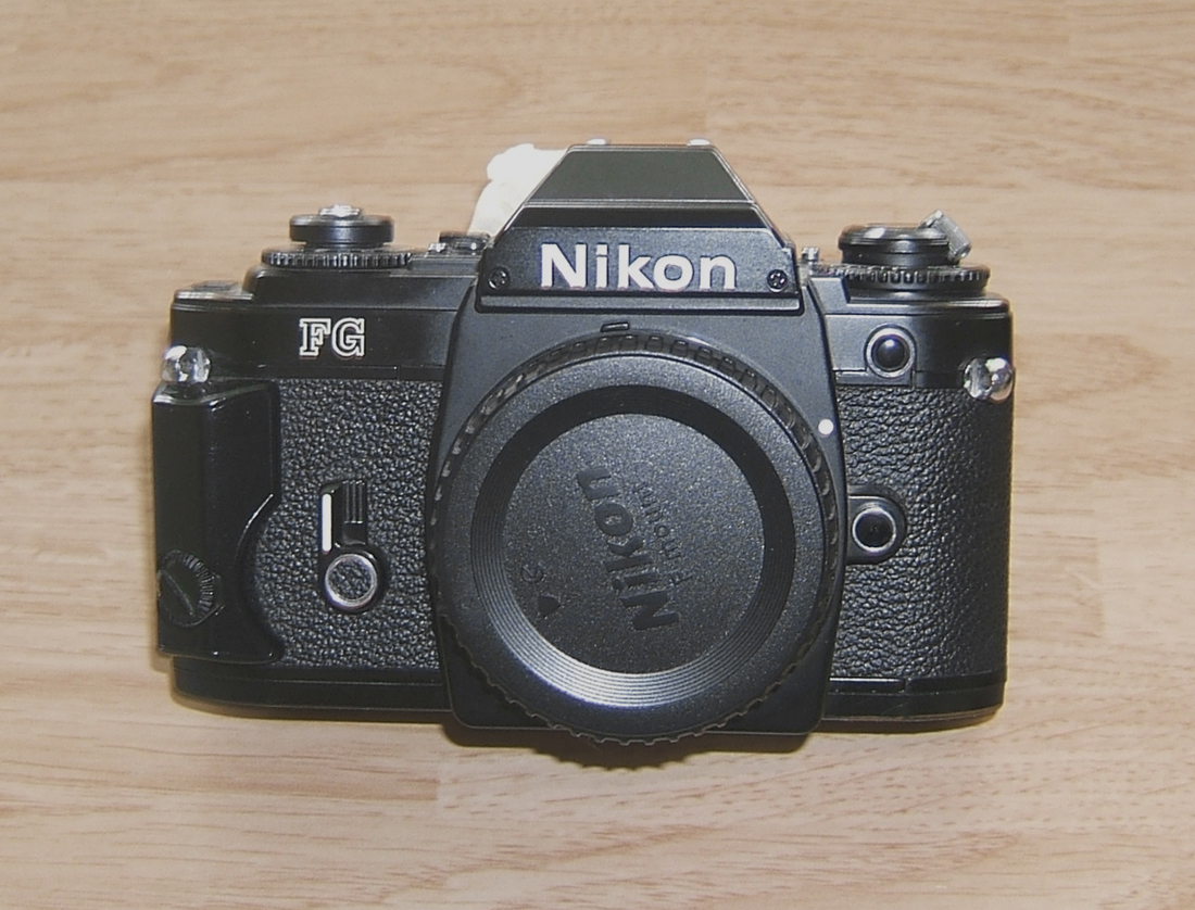

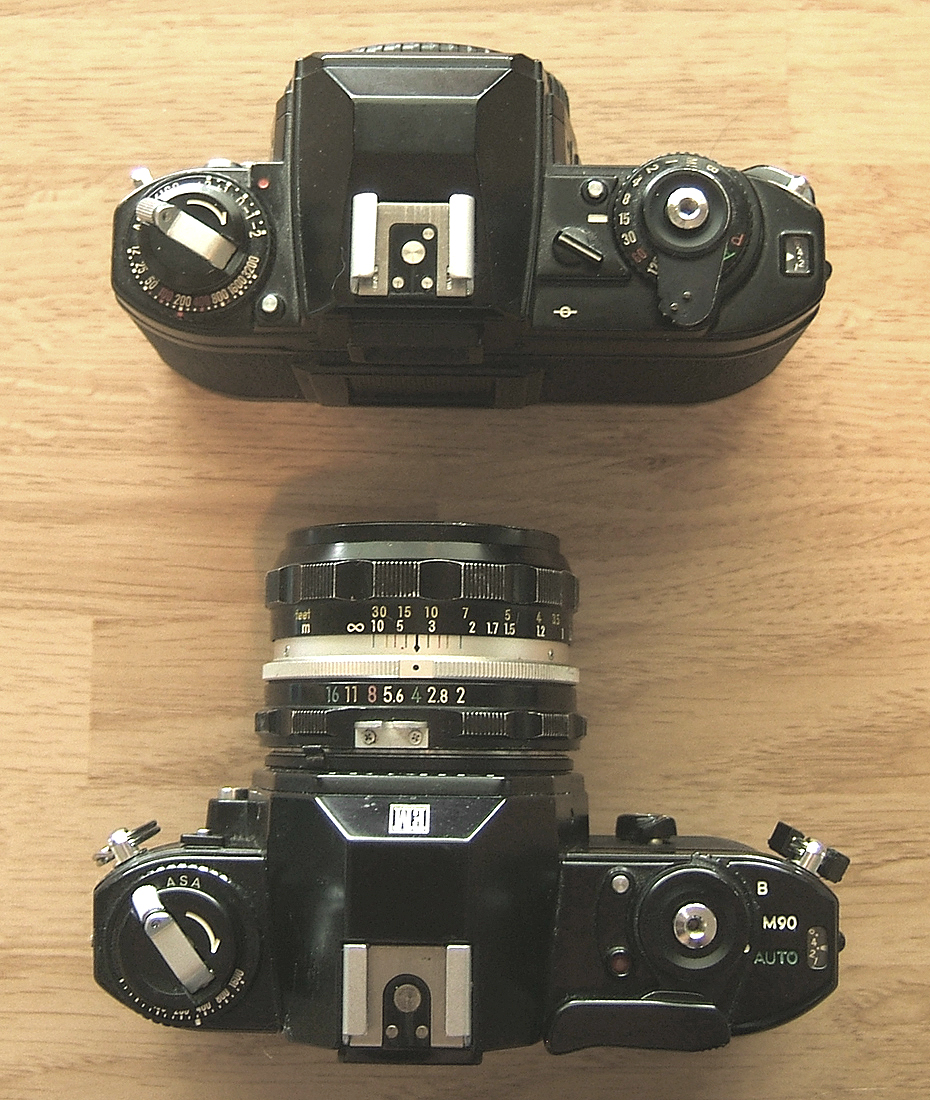

I bought this cute little Nikon FG for $12, shipped, on eBay. It was listed "for parts", and the pics on the ad were really bad, but I figured it was just the usual sticky mirror foam, coupled w/ dead batteries. It did need batteries, but the mirror foam is fine, and the camera works a treat, but what I didn't see on the ad pics was that the film advance lever was broken. It actually is pretty easy to use just as it is by using what is left of the lever, but I'd rather have a proper film advance lever if I could. I thought that maybe I could use the one from my EM, but as you can see, it looks like a no-go, as they're different. Does anyone have any ideas for a cheap fix? Thanks.

-) glue the plastic part on the metal part with epoxy cement and secure with screws.
or
-) cut from brass plate of the same thickness as your rest of lever a shape that being bent over resembles such lever and mount it instead of the broken one.

I can tell you from experience that if you intend to replace the metal part that there are at least two types--the type on my FG, and the type on the FG parts camera I bought thinking I'd steal its lever. The difference was invisible, down inside the camera, and essential to function (On the parts camera the shutter button was fastened inside, the the mechanism under it; on mine, it was loose, held in by a little sticky-out bit on the innards of the lever that the parts lever didn't have.) I don't know if the plastic parts are identical or not.

Good ideas AgX. Unfortunately, I have no plastic part to glue back on. All I have is what you see in the pic, just the small nub that the reticulating lever attaches to, or would attach to if it were still there. But you've given me an idea. I'll just drill a hole in the little nub that's on there, and attach a bit of a lever off one of my old broken cameras by drilling a hole in it, and attaching it to the nub w/ a little bolt and nut. That should work fine. Thanks!
My favorite Nikon camera, other than my $20 N8008s, is the EM in the pics, which I modified to shoot in stop down mode w/ non AI lenses, but it's getting pretty old and shabby. I may just file off the little notches on the end of that nub on the FG (or just cut them off, it's just a cheap plastic piece) and try using it w/o that missing lever. Yes, these are often cheap cameras, but $12 shipped to my place is gonna be hard to beat. I have yet to see one go for that small of a price.

-) make a "knob" from hard-wood or a block of plastic and fix it as described above (might come out better than the original knob...)

Lots have damaged missing lever tips seems to be Achilles heel. Brass stock just thicker than lever saw and file drill and rivet three sections tap etc. but parts cameras cheap.
