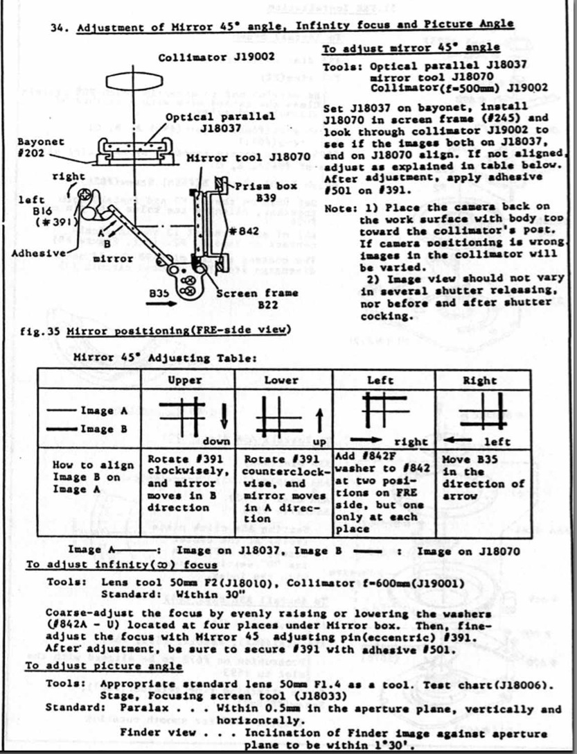

There's a small bar that sticks out from the right side of the mirror box. It can be rotated to adjust the angle that the mirror normally sits at. If I have a 1.25in front focus at 3ft, is there any way I could figure out exactly how much to rotate the bar to get back to correct focus accuracy? Or maybe an angle for the mirror?

I don't have the service manual for the FE2, but on a camera like the Yashica FX-3, there are two adjustment screws. One moves the whole mirror up and down and the other affects the angle of the mirror.

Washers under the screen need to be thicker if you can't get it correct by adjusting the mirror alone.
