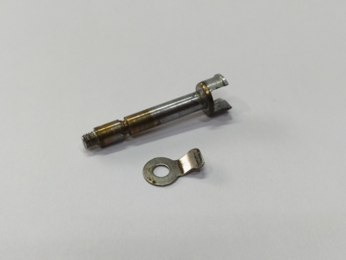

I have an FE2 that I had lent to a friend when we were on a two week road trip in Alaska. When she tried to rewind the film she turned the knob counter clockwise and twisted the knob off the shaft. by the time that I had caught up to her she had pulled the shaft out of the body. As we were on a trip I put the pieces in a plastic bag and but I don't think that I had all the parts. In any event the picture shows what parts I have left. I can put what I have back in the camera but it is extremely loose and I'm afraid that there might be light leaks.
The camera is nice in every other regard and I would like to use it again. Can anyone tell me what parts I'm missing and where I might be able to get parts, also can I use the rewind knob and shaft from another model Nikon like an FM. FM2, or FE.

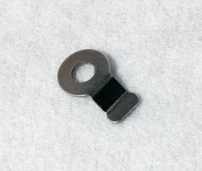

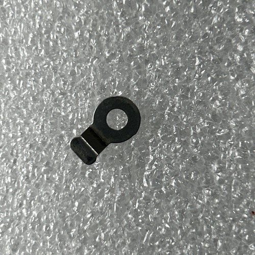

You are missing the part that "locks" the rewind handle in the up/down position. I've seen them on ebay but not sure how often they are available. I beleve it is a common part for the models you cite.

You should be able to put it back together even without that part, although you might need an extra small washer to take up some space on the screw. The extra tab on part #656 provides a surface for the end of the crank arm to cam against, so that it stays up or down as Brian said. Without that tab, the rewind crank will flop around annoyingly, but the camera will still work. The knob and shaft are fine. You fasten the knob onto the shaft by opening the back and blocking the rewind fork with a screwdriver, and tightening the knob.

The problem that I'm having is the shaft itself is loose in the camera and wiggles around quite a bit. I know that I'm missing the spring for the crank knob, but that is not the reason that it is loose. It seems that there is a bushing that I'm missing. I saw the parts available on Ebay and I don't think they are the ones that I need. I think my best chance is to pick up DOA body and use the parts off of it. Does anyone know what Nikon bodies would work for me?

Post a picture of what yours looks like now, so we can see what's going on.
In your description of the incident, did your friend pull the rewind shaft out of the body from the bottom (back open) or from the top? I'm not sure you even can pull it out from the top, certainly not without excessive force.
There is an outer metal sleeve with a groove around it labeled part 665 in the diagram BrianShaw posted. The groove engages the spring of the safety latch (the little doodad that you have to push to allow the rewind knob to be raised, preventing you from opening the back accidentally). I have not seen this sleeve fall out even in rescue-cases where the rewind knob comes off and the shaft falls into the body so the back is stuck closed. But I suppose it could happen. If you're missing that, you probably need to look for the part, or parts cameras with the safety latch (maybe FM/FE/FM2/FE2/FA).
