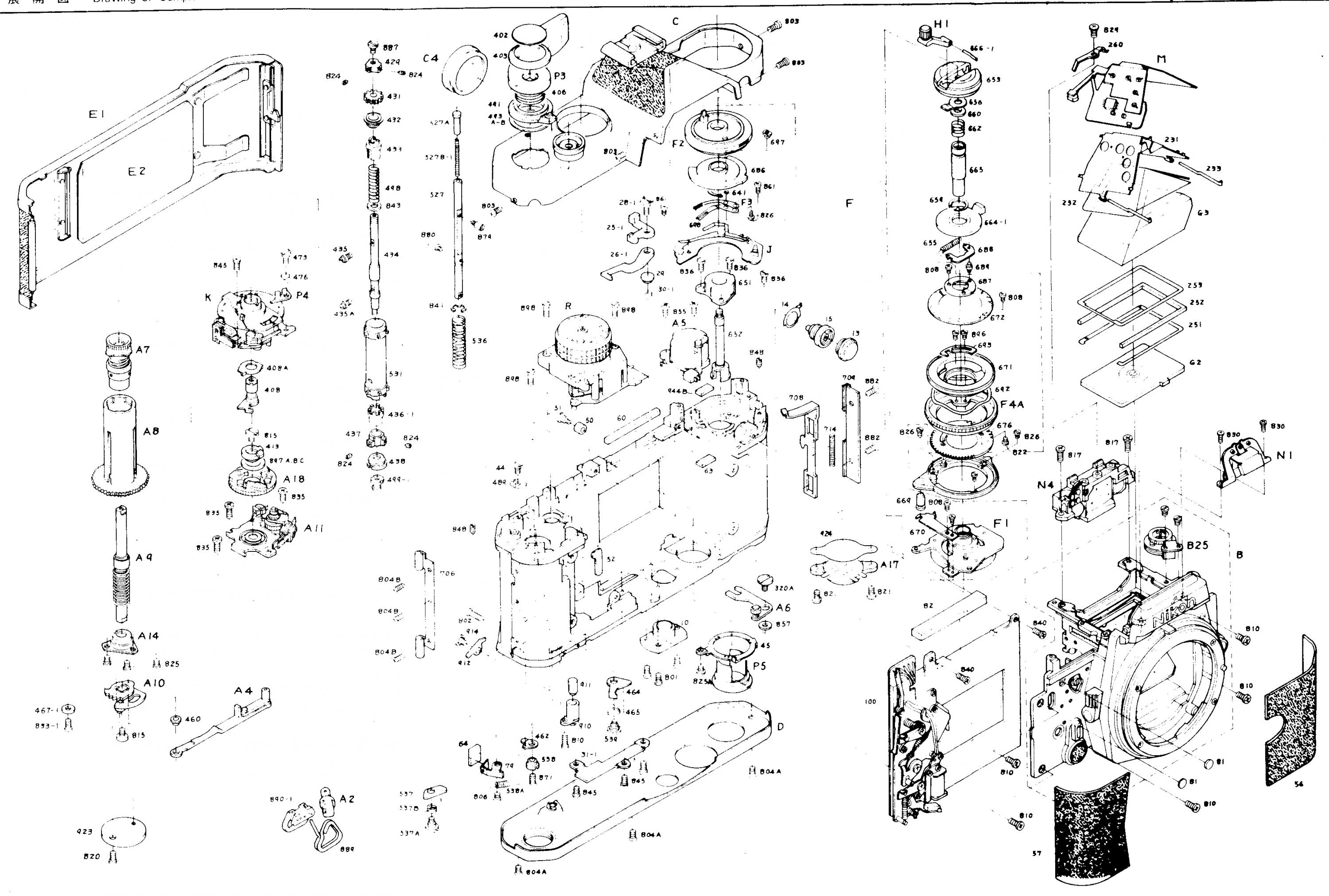

Heres an exploded view, maybe it might help.
