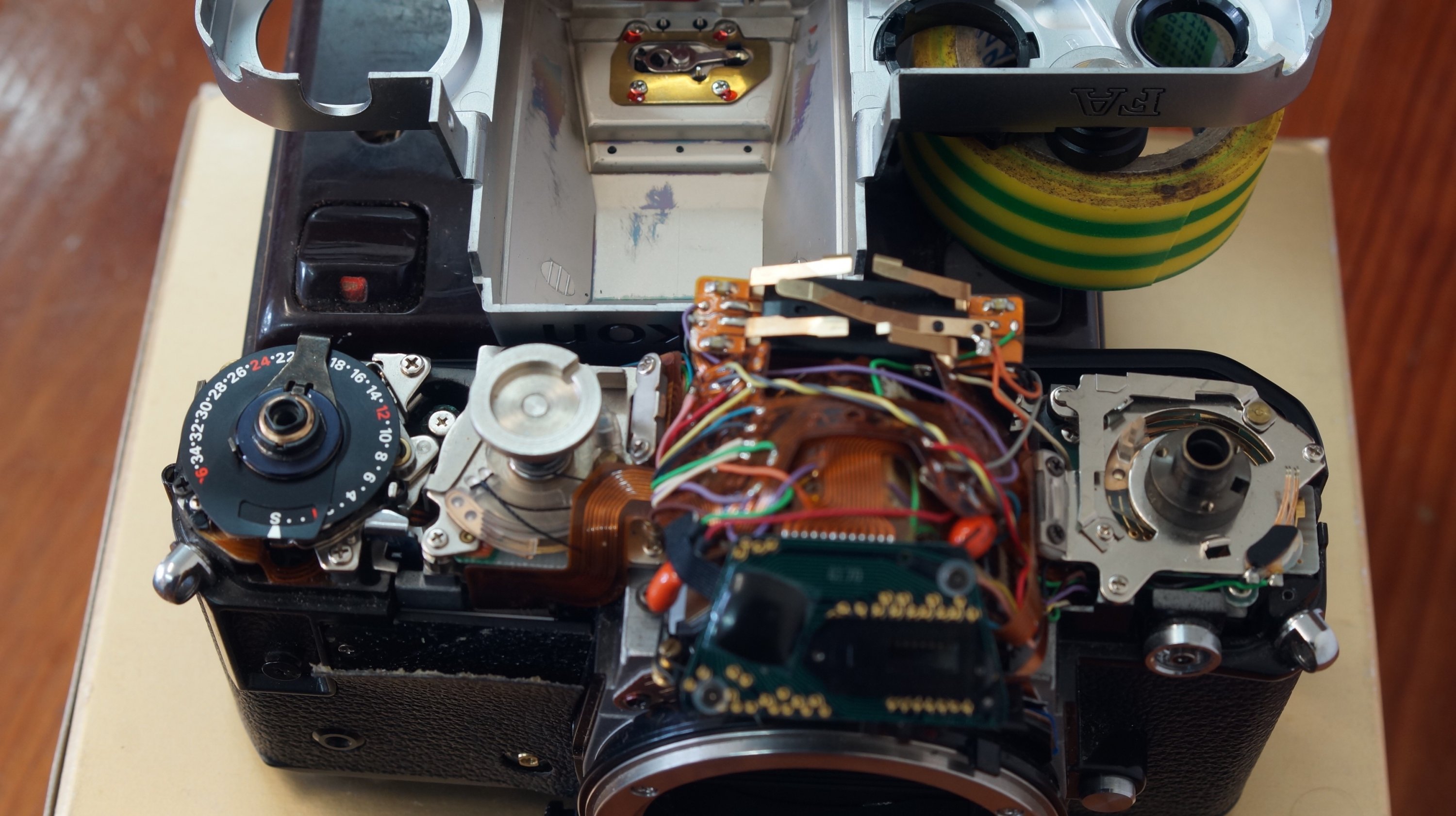

The Silver FA (serial 506----) works perfectly except the aperture actuator lever does not move down to stop down the lens. Probably a simple mechanical fix if it was accessible, but the repair manual disassembly flow chart looks too complex for my limited ability. Way too much desoldering!

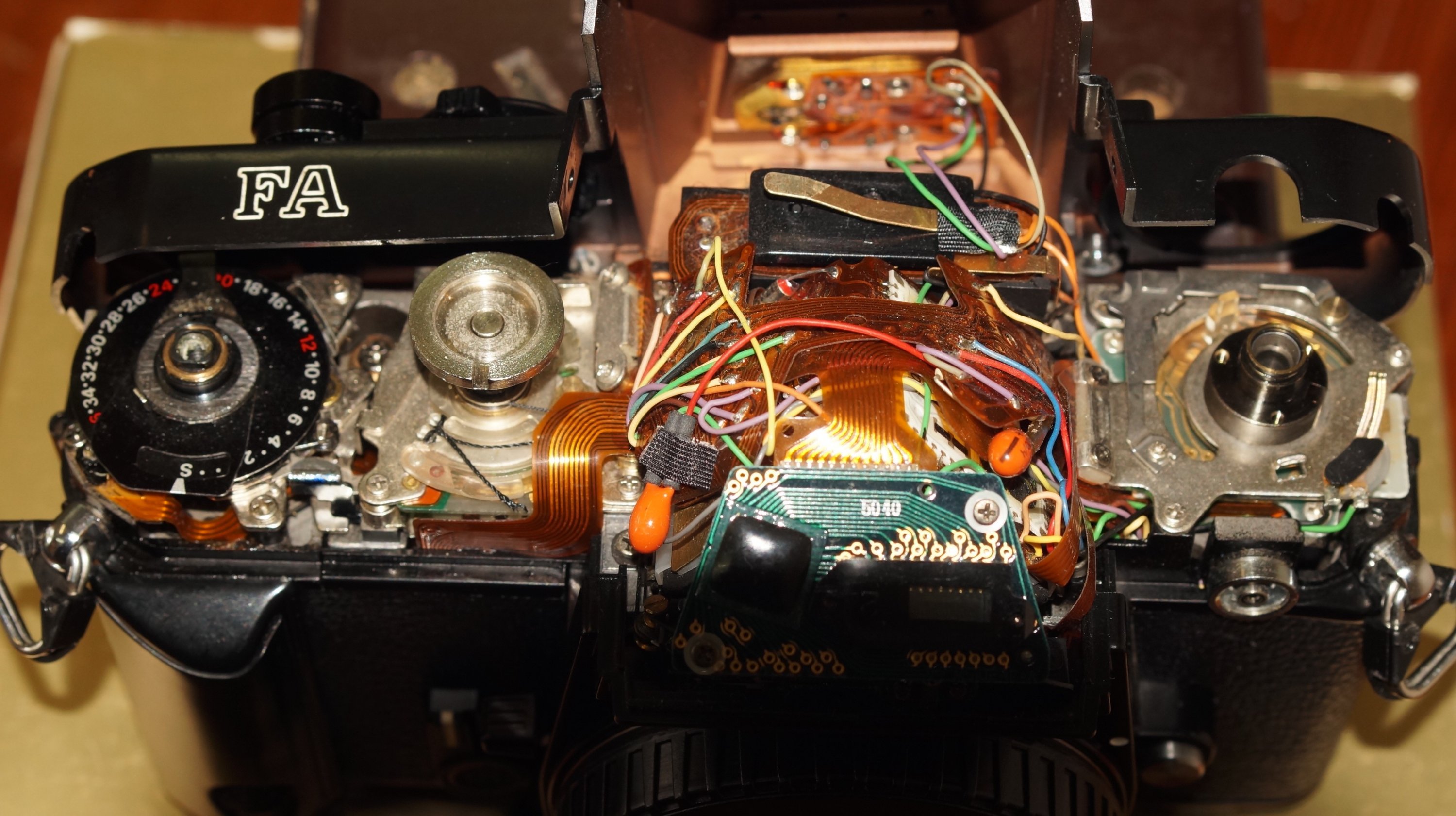

The Black FA (serial 537----) is electrically dead but it does do everything it should in M250 and Bulb.

But I may have to stick to making this custom camera in Silver. If you look at the two photos it shows that the Black FA has a different wiring loom with wires connecting the flash, where as the Silver FA uses sprung connectors. I read somewhere that the FA cameras had a wiring loom issue that was replaced with an upgrade under warranty. I now suspect that the Black FA may have the original faulty loom even though it has a later serial number. Does anyone recognise these wiring looms and can advise if I am correct about the Black FA loom? If so I wonder how I will go with a warranty repair -
