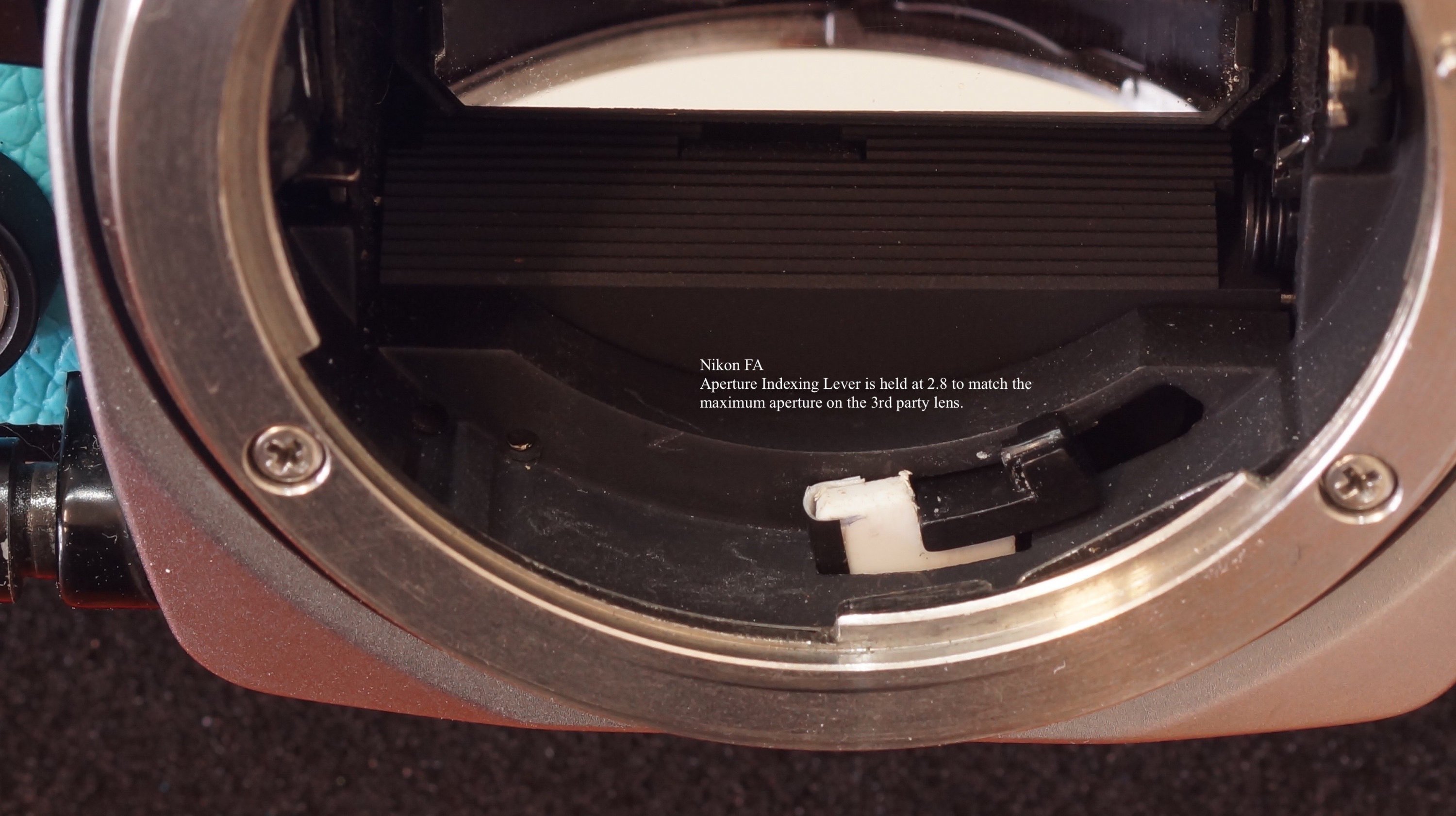

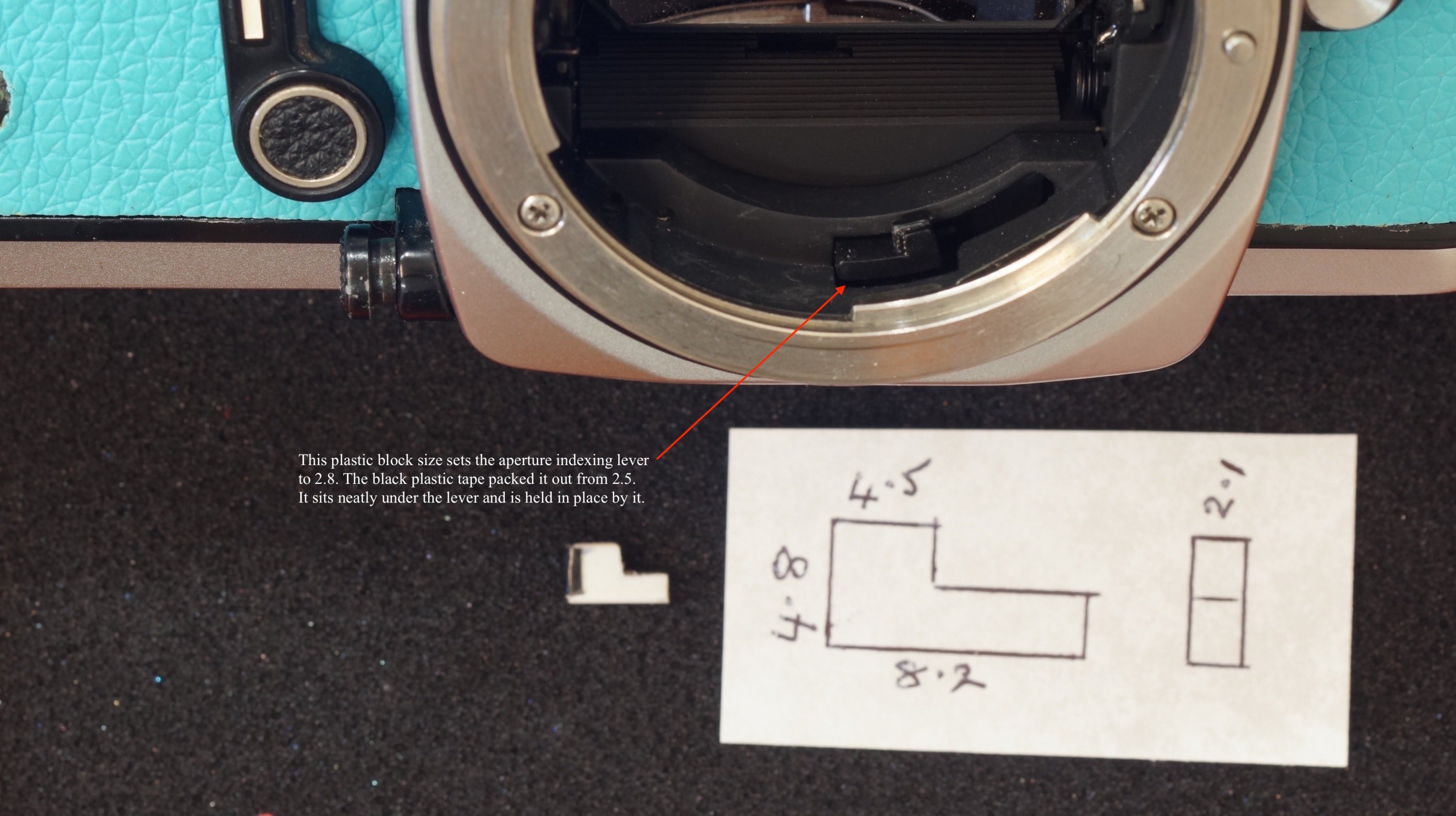

One of my Nikon FA's has a faulty Aperture Coupling Lever. Too hard to repair so I have transformed it into a Stop Down camera by removing the ridge tag from the Meter Coupling Ring and fixed down the Aperture Coupling Lever. This way it works on both my Nikon AIS and Leica lenses (F mount adapter). The FA is a sophisticated camera with Manual, Aperture Priority, Shutter Priority and full Program modes. But with the Leica lens, older Nikkors, or other lenses like SP Tamrons, they will only work on M or A. They will also only work on Centre Weighted metering not the AMP (Automatic Multi-pattern).
Studying the Mir.com.my site I could see the possibility that the lens Meter Coupling Lever would give the info to the camera as to the type of lens fitted and this could then make the S & P modes work as well as the AMP metering. I experimented with small plastic packers and sure enough the camera registered this info as if a Nikon AIS lens was fitted. I then fabricated a small plastic block from 2.3mm thick plastic and this locks securely under the Meter Coupling Lever and provides a stopper at the correct distance. As a very rough guide here are the stopper sizes needed to register the Maximum Aperture Index of varying lens maximum apertures.
1.5mm = F1.2, 1.8mm = F1.4, 2.4mm = F1.8, 3.2mm = F2, 3.4mm = F2.5, 4.3mm = F2.8, 5.5mm = F3.5,
6.5mm = F4.5, 7.3mm = F5.6. These are just approximate and you will need to test & file carefully to get it right.
With the plastic block in place this is how a F mount Leitz Elmarit-R 1:2.8 / 28mm works in S & P mode. The AMP metering is clearly now working in these modes and in A mode. These inserts would work well when using other manufacturers lenses that do couple to the Nikon F aperture lever like the SP Tamron adaptall 2 lenses, or older non AI Nikkor lenses.
In S Mode instead of getting a corresponding reading in the viewfinder LED of say F11 matching the position of the lens aperture, what you see is just F2.8 matching only the plastic block setting on the Meter Coupling Lever no matter what you set the lens aperture ring at. This is because the lens aperture ring is not coupled with the Meter Coupling Ring. But that doesn't matter as long as the Meter Coupling Lever is now matching the lens maximum aperture, the camera takes correctly exposed photos once the lens aperture is rotated till F2.8 shows up in the view finder LED instead of a recommended speed - as per the manual. ( read the FA manual for all the vagaries of lens types using the S mode).

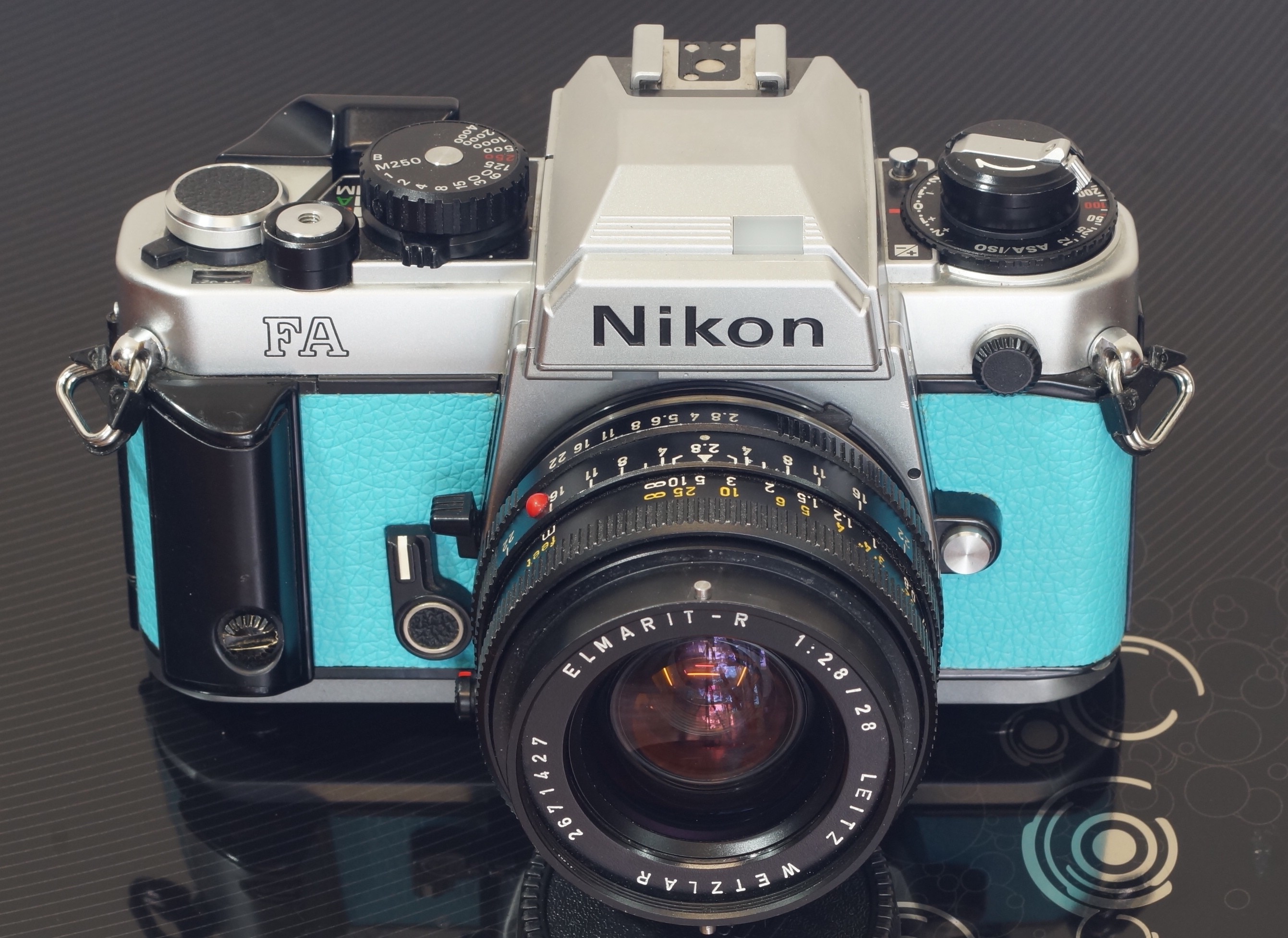

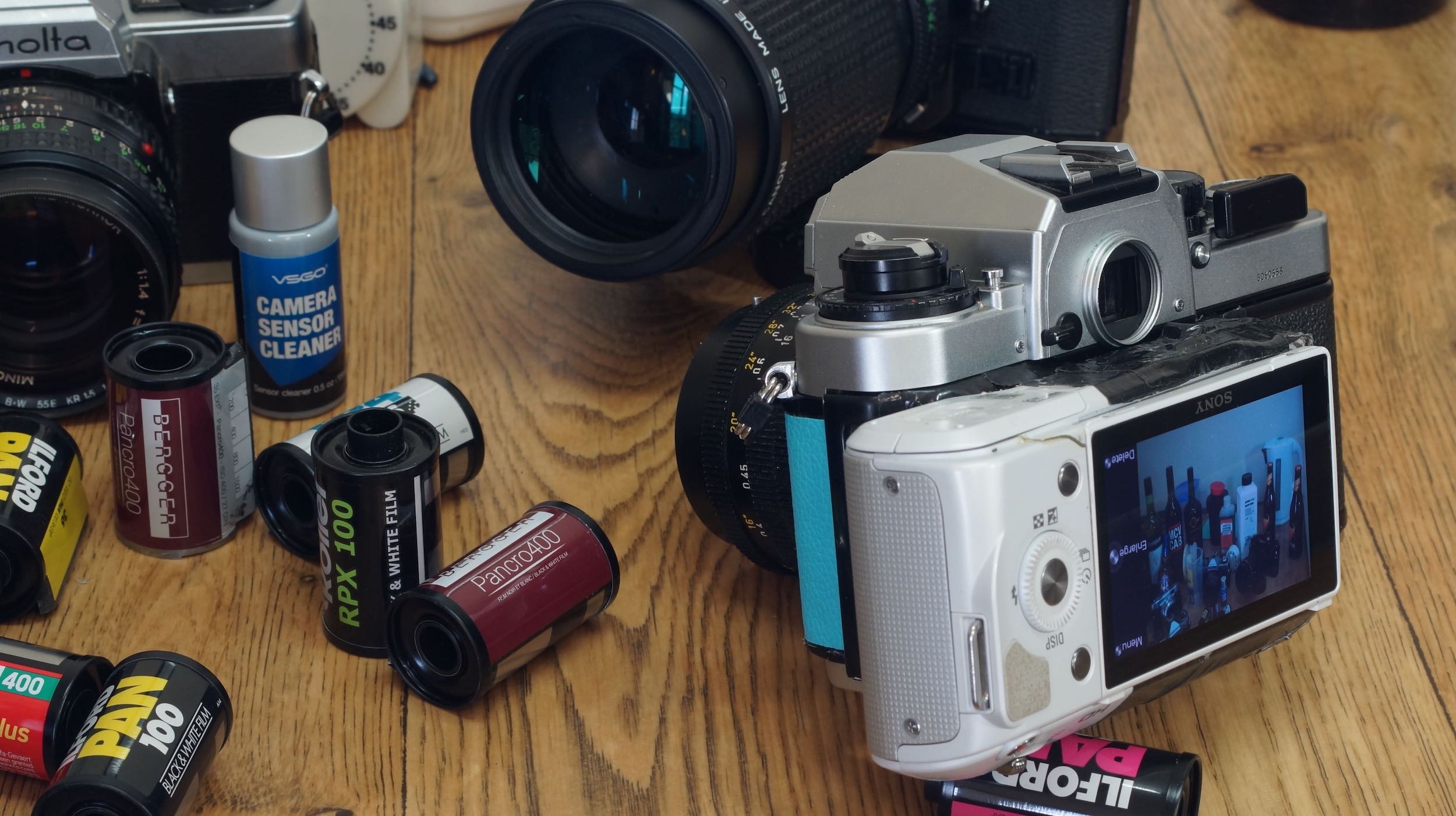

This is the subject Nikon FA and the FA fitted with the digital back for the tests.
