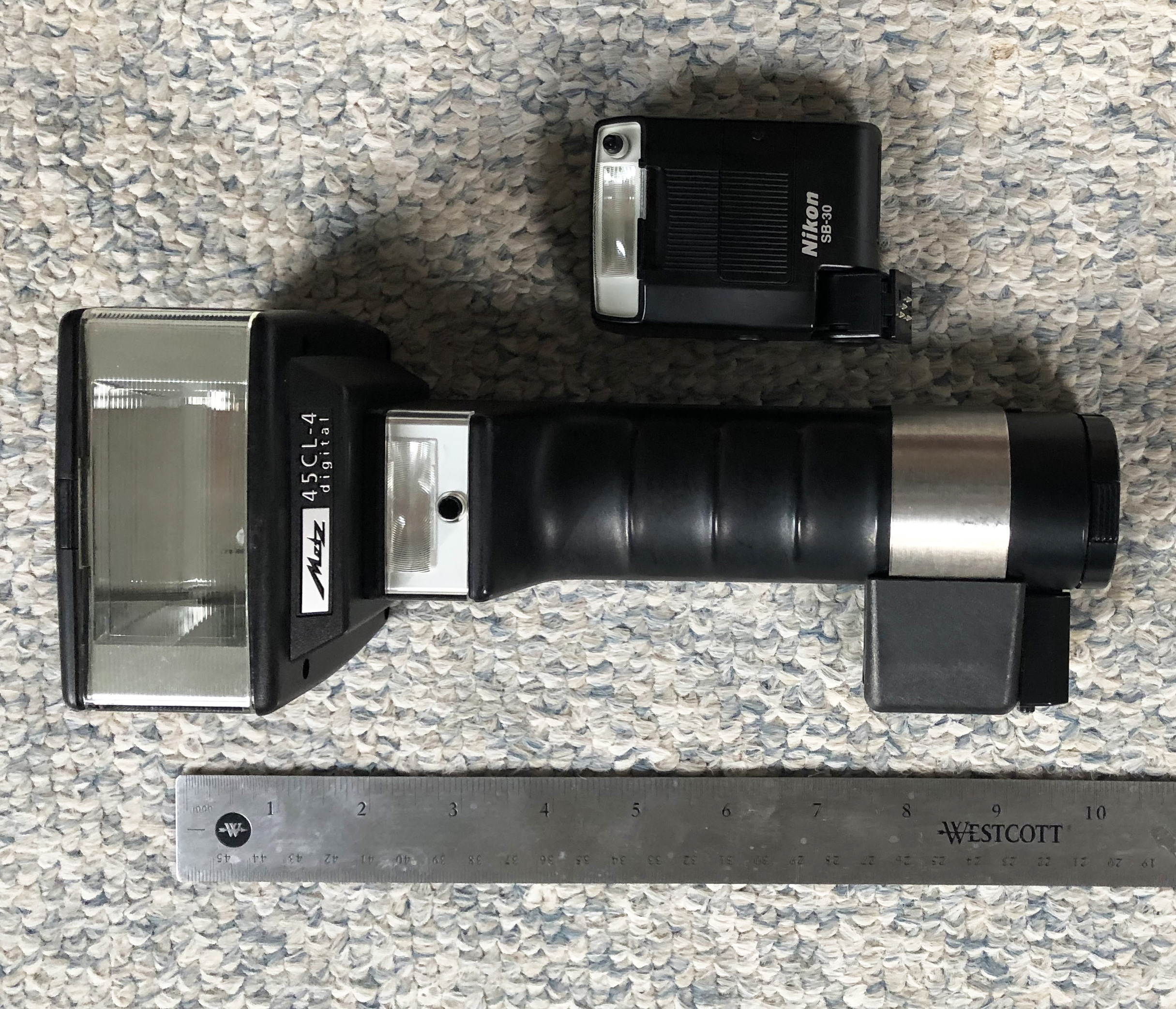

benveniste
Nov 1, 2007
533
Size comparison between the Metz 45 and the Nikon SB-30.
wiltw
Oct 4, 2008
6,617
SF Bay area
Mutt and Jeff. I would prefer NB-30 over NB-27 simply for lowered risk of red eye!
