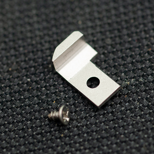

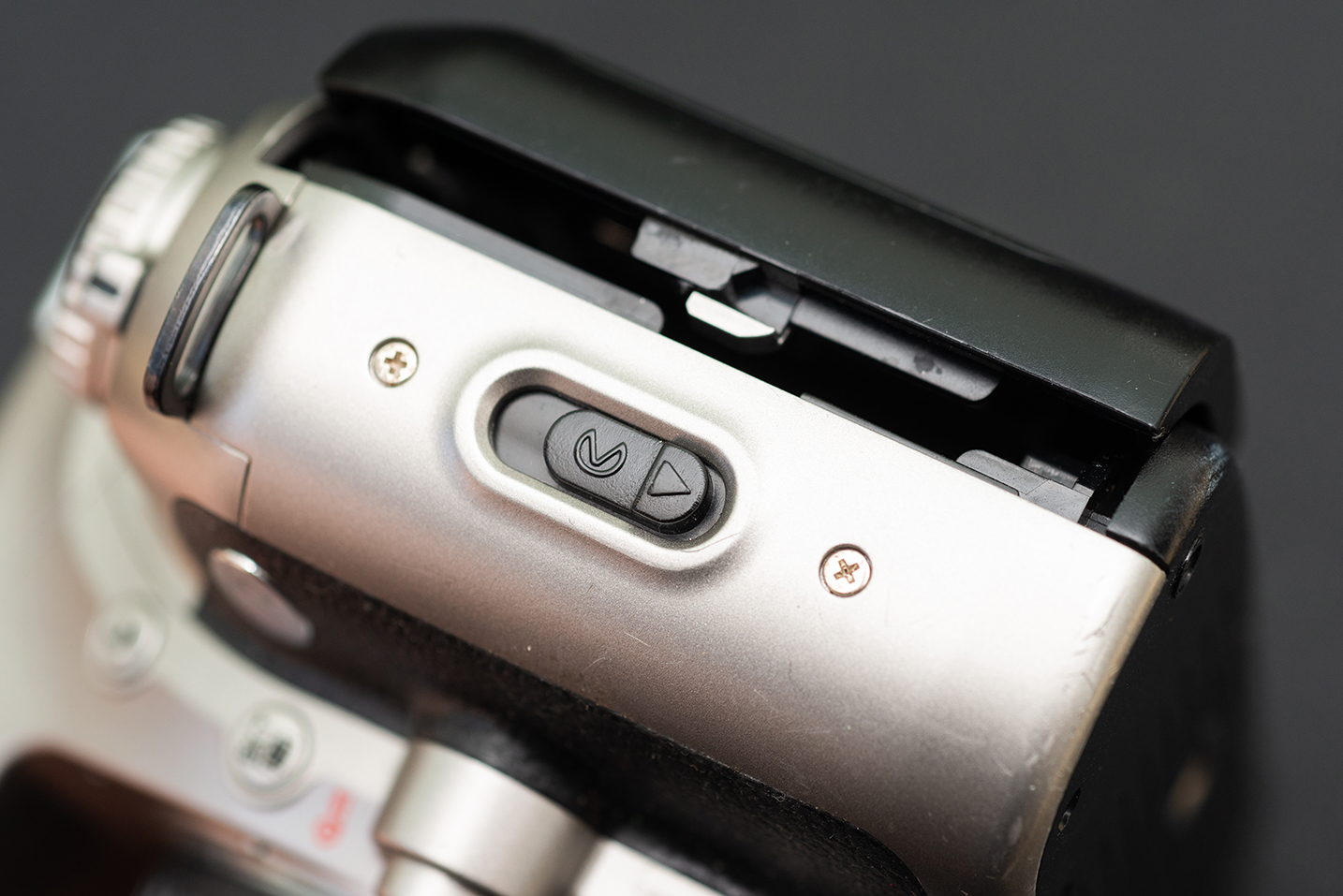

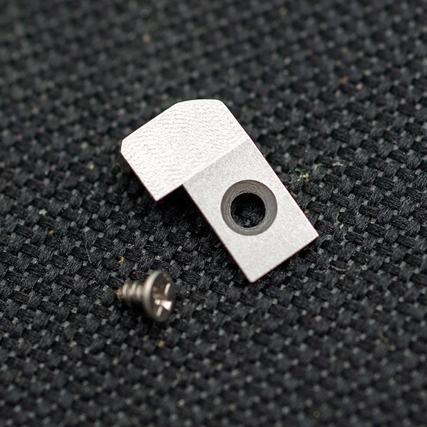

I just recieved my batch of kits from my machinist. They are made of 304SS and bead blasted.
It was a bit finicky to install since the door on these are a real bear to remove so I performed the repair with the door on the camera. It works well though and also I checked it with film to make sure the latch was not digging into the film canister. All good! If anyone has a F55 or N55 the door is removed the same as a F65 so it is going to be easier to perform the repair. Even with the door, it took me around 10 minutes or so to install.
