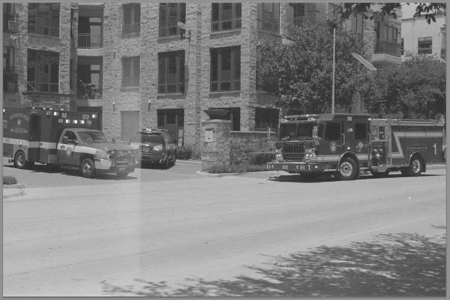

I'm sending my F6 off to Nikon for repair this week – I've had the body since 2015, and this is the first time I've seen this happen.
With what I believe is a vertical travel shutter, this seems like an odd light leak – it is not consistent in intensity, and was not on every image of the 24 shot roll.

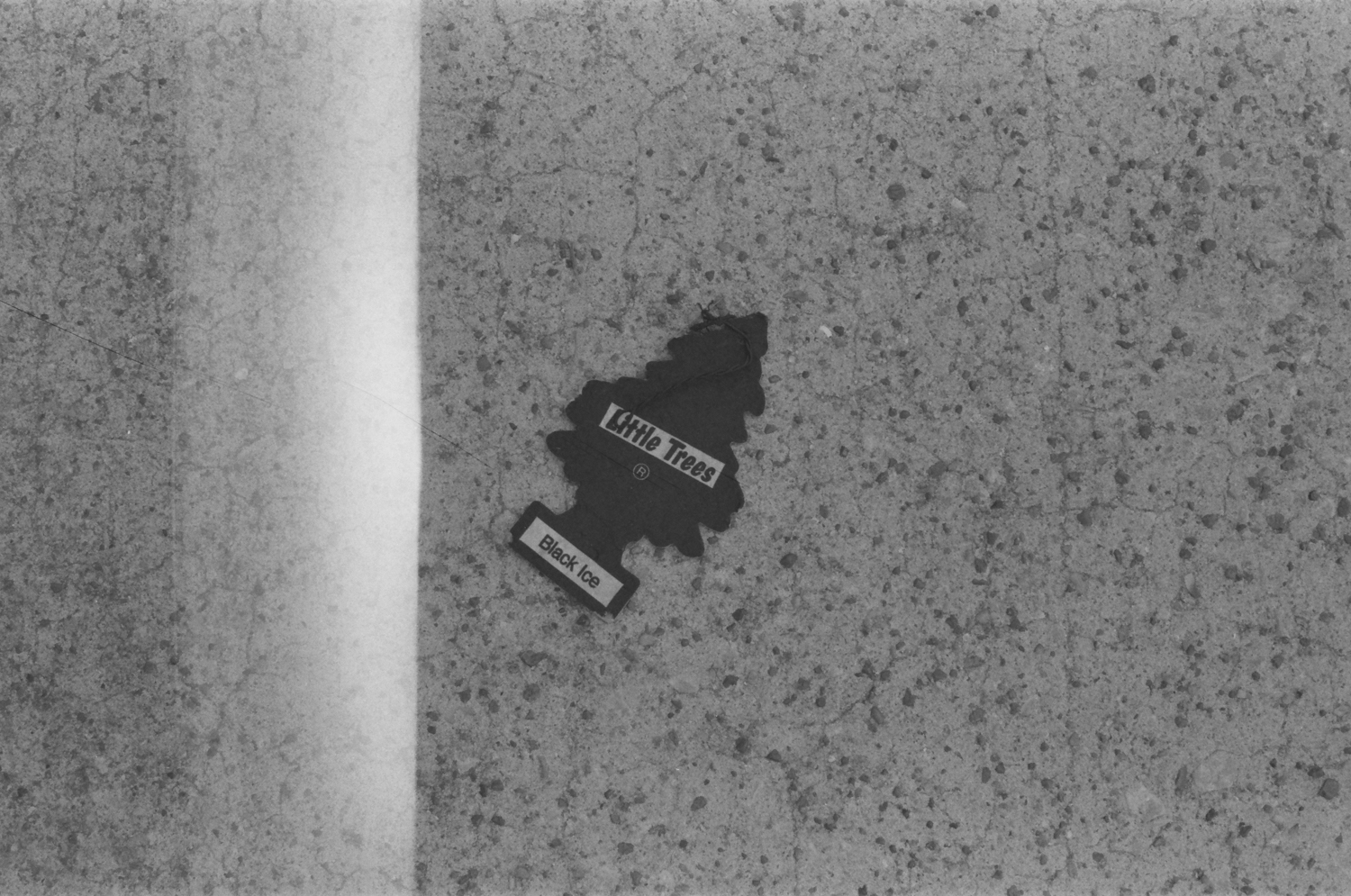

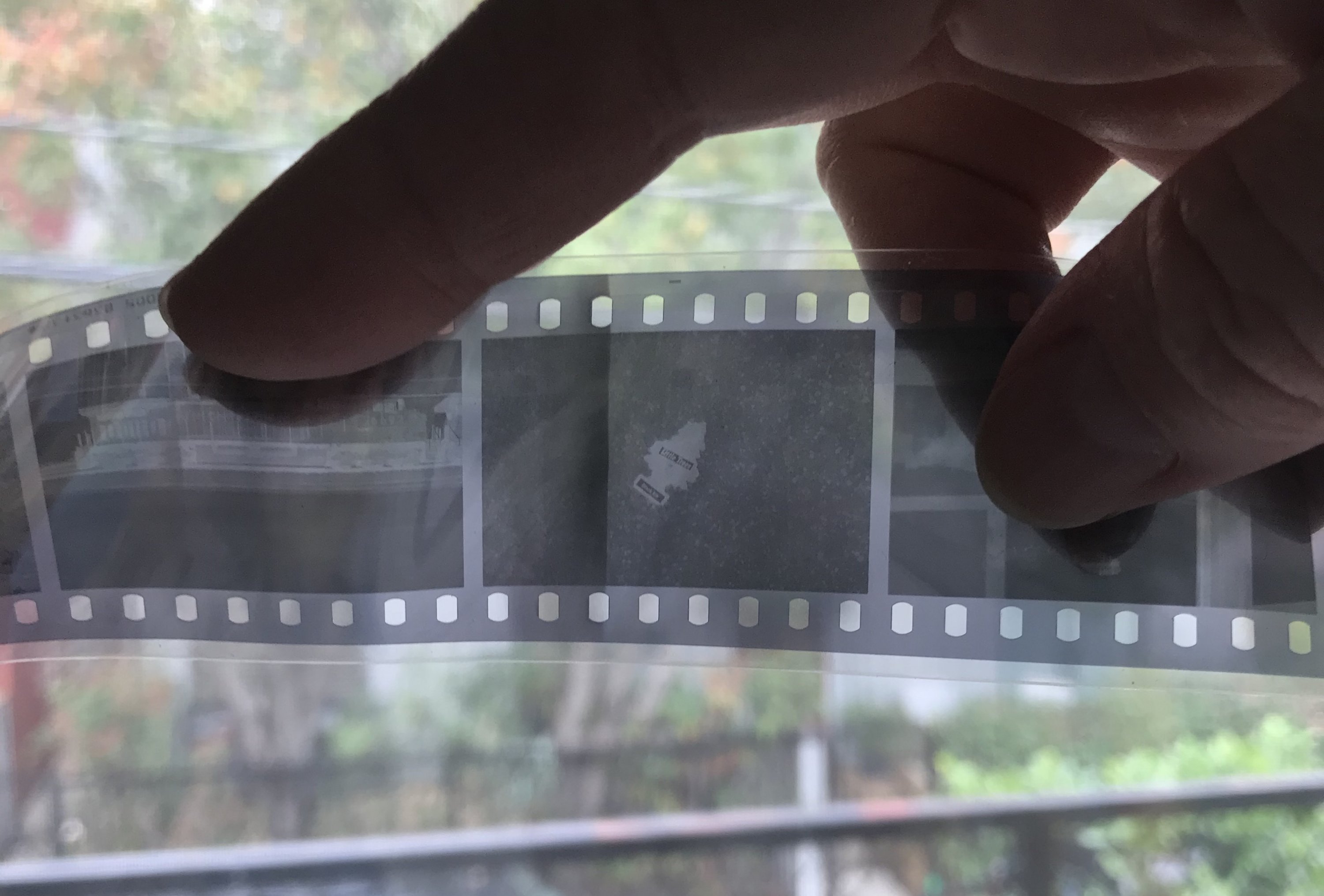

The edge and flare are in the negatives. Here's the strip that corresponds to the air freshener image above – this is the only frame where this is this strong, and also goes beyond what I would expect to be exposed by the shutter. You can see a less pronounced version of the mark in the shot of the locomotive to the left of it as well.

Definitely some kind of fogging/light leak, although I suspect the F6 isn't as susceptible to leaking as other cameras.

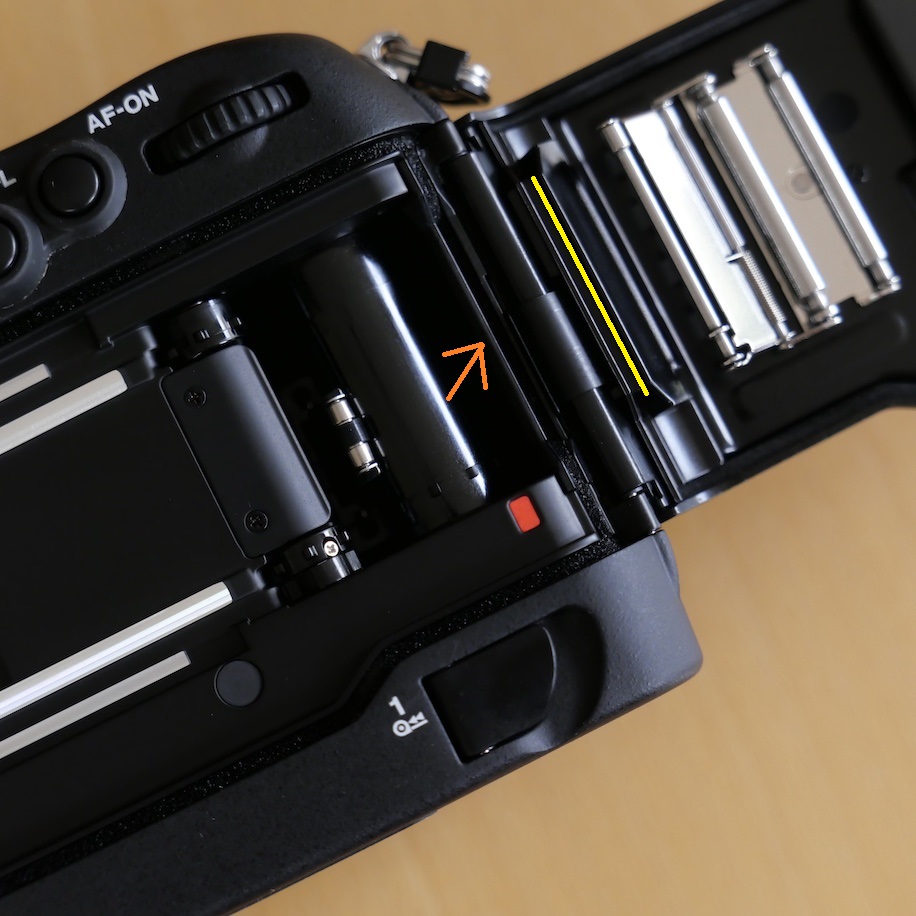

The F6 back has a special curved construction around the hinge that "envelopes" the body's edge in order to prevent light leaks. Something must be really wrong if so much light managed to get thought that arrangement.

Is this bulk loaded film? The artefact resembles the problems one encounters with cassettes that leak light.
Observe the sprockets on the left of the leak. They all have higher density from that point on.
It seems that the whole roll after that has elevated density. Doesn't look like a spontaneous leak to me, but maybe i am wrong.
It may just be how it looks in this shot; held up to the light the density seems even. I'd have to put it on a light box to really check.

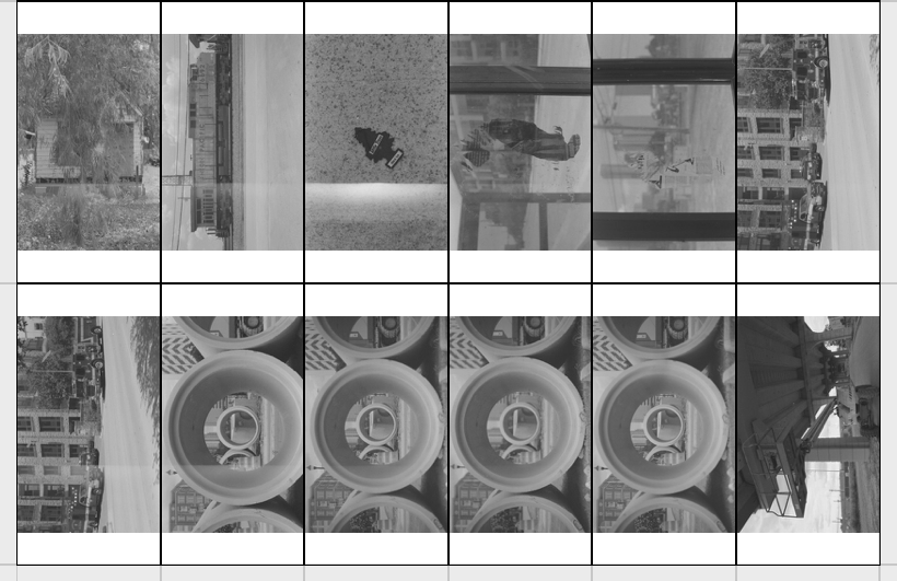

Would the mark shift in that case across the roll based on the wound film? When I view the scans in Lightroom, I can see the edge in the same spot. You can see it in fainter in the images in the second row.

The yellow "canal" envelopes the edge near the film as pointed by the orange arrow. I think it is really difficult to have light sneak in from that area.

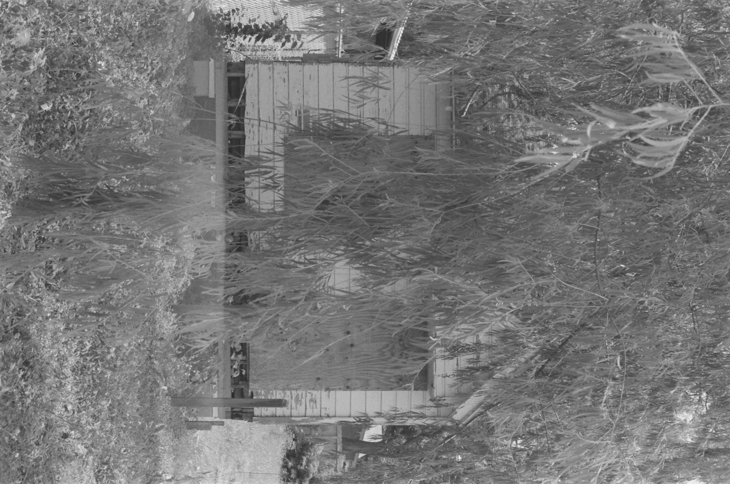

That shot was taken pointing straight down to the sidewalk – I don't remember the weather.

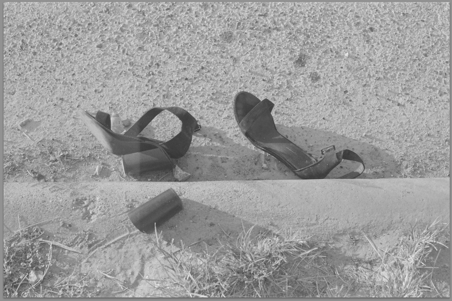

This one was also pointed towards the ground – it's the second shot on the roll, and the one before it has not have the line. The house shot above is a little more noticeable.

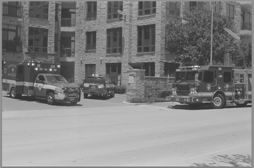

The odd thing is moments like this where it is only on one of two successive frames.

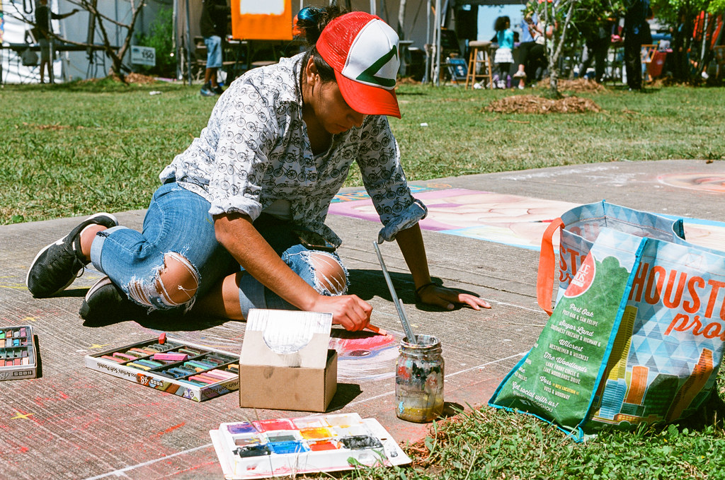

I've never worried about a leak through that window before, but's possible it shifted. There was plenty of sun in LA and Mexico when I shot 20 rolls between two trips in 2017 and 2018, and never saw that mark then either. The shot below is from 2017 with Ektar 25 – the sun that day was pretty intense.
