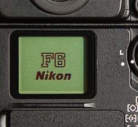

So, I ended up buying it and having a look through the data that is on the camera, it appears that it has data for 13 rolls of film that start in 2008. From the overall condition, I would say that it has had very little use, and 13 rolls might be true.
Having a read around on the web, I came across the concept of the F6 splash screen being removed after the update. Mine doesn't seem to show this screen, so maybe this is a clue???

My later model doesn't show that, and I could not find a way in the menu to set it if I wanted it to show.

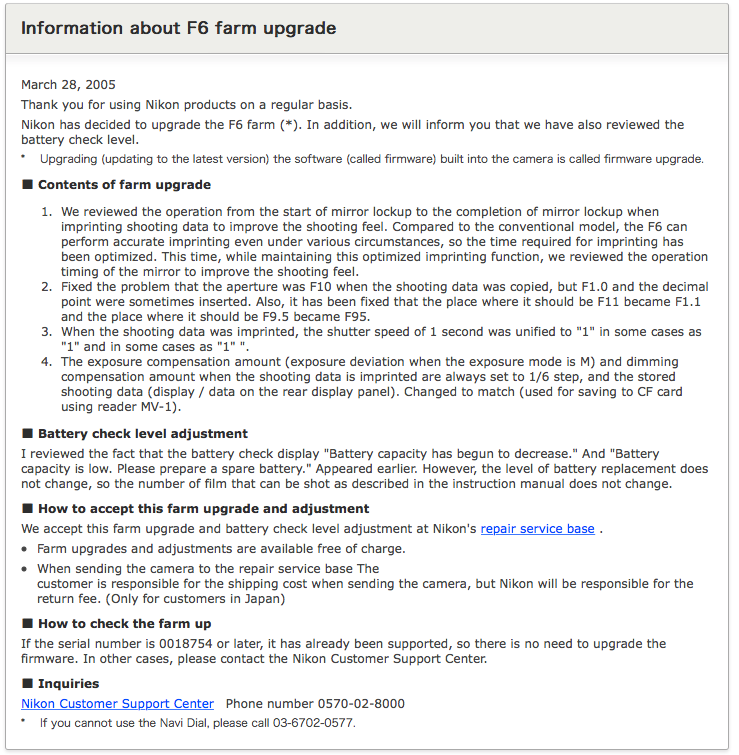

You should be able to tell if you low battery indicator comes on too soon and some minor issue with recording the correct decimal place for some apertures.

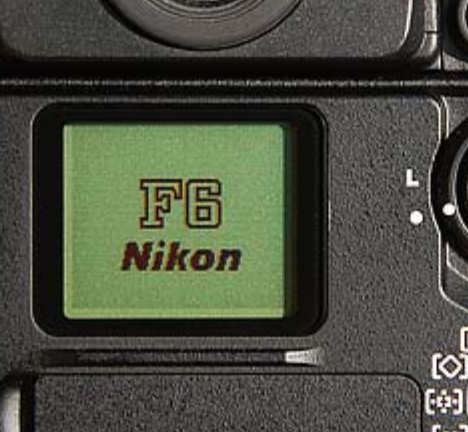

On page 18 of the F6 manual it says:
"F6 Nikon" is displayed in the rear LCD panel when the exposure meter is off under following conditions: Film speed = DX, AF area mode = Single Area AF, Focus area = center, Exposure mode = P, Exposure compensation = 00, Auto exposure bracketing = no setting, Data imprint = no setting and Flash sync mode = Front-Curtain Sync.
My F6 is in the 34xxx series so it has the final firmware and it works per the above. If it doesn't work, start by doing a Two-Button Reset (page 147) which returns all settings to their default values.

I have two Nikon F6 bodies with serial numbers in the 14xxx and 15xxx range, so they originally came with the older firmware. I had the firmware in both of them updated for free at least 10 years ago by Nikon USA in Melville, NY. Unfortunately, it is my understanding that Nikon USA no longer updates the F6 firmware. I do regret not also having the modified (fold up) Ai tab installed in my F6 bodies, to allow the use of non-AI lenses, even though I don't have any non-AI lenses. That service also is no longer offered.
After the updates, the F6 logo no longer appears in the rear LCDs of my two cameras, regardless of setting. So, if you don't see the F6 logo, chances are that the firmware has been updated.
