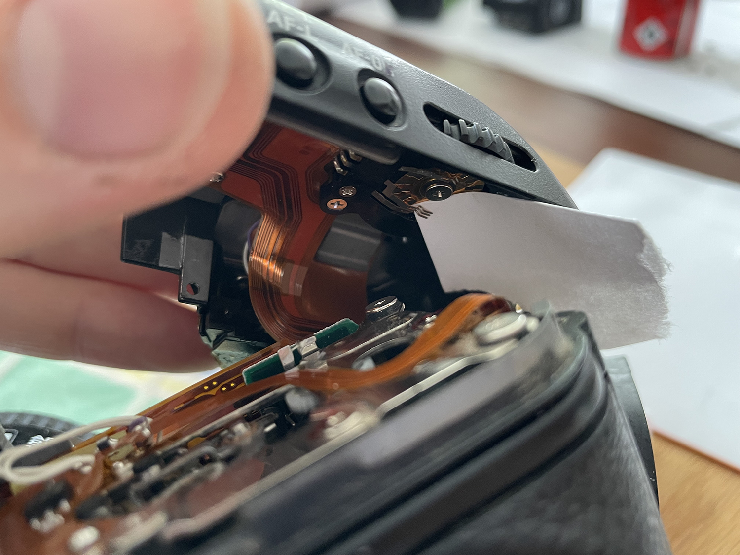

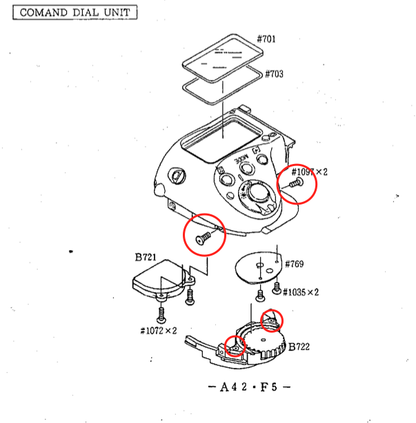

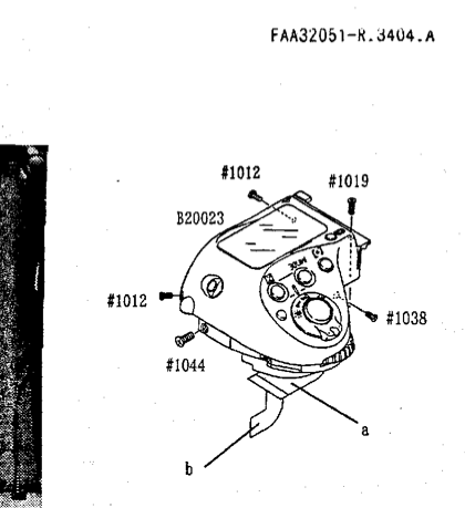

For anyone having similar issues:
In my case dripping lighter fluid into the command dials unfortunately didn't work. But it is relatively doable to open the camera and reach the dials. On page 97 and 99 of the service manual you can find how to open the right compartment. You can reach the shutter speed dial right away, for the aperture dial in front you have to undo 4 more screws. Then I used lighter fluid and paper to clean behind the pins and cotton swabs to clean the dials.
Just be very careful not to damage any wires.
It took me about 45 minutes.
